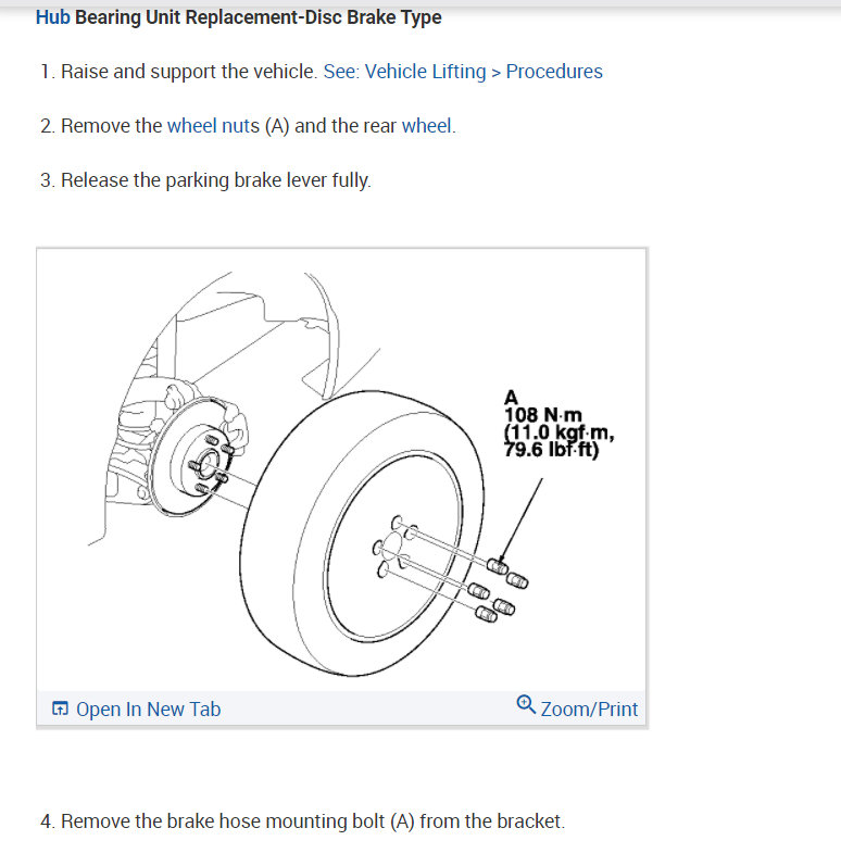

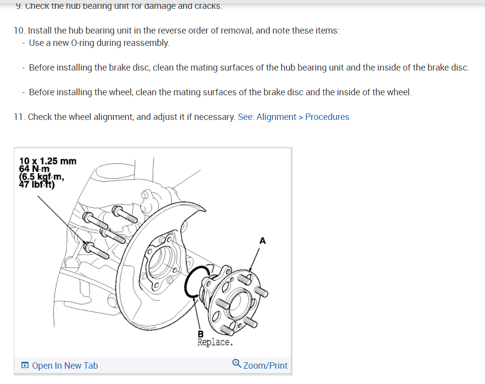

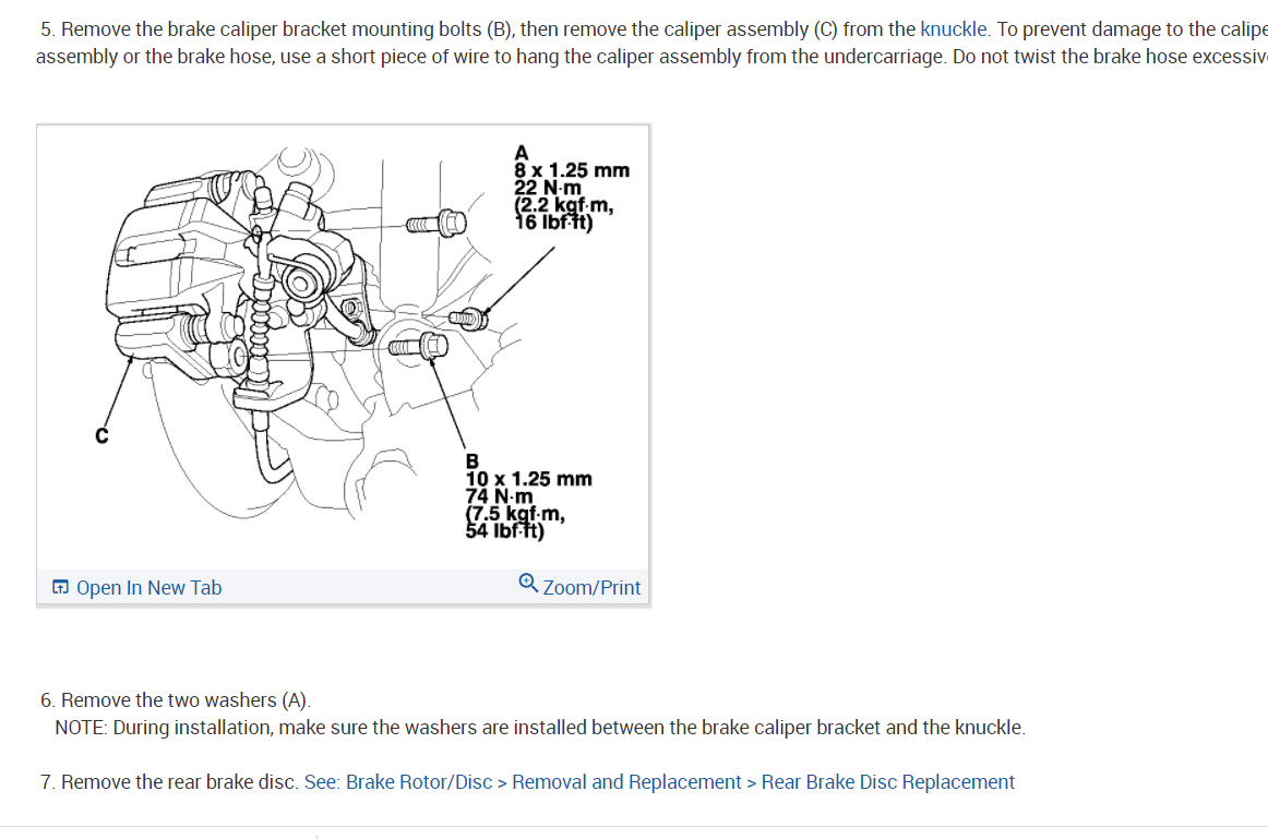

I bought the car listed above last year when I was 18. Ever since i’ve had it it has made a loud helicopter noise in the back. I didn’t know that it was the wheel bearing and Google says it doesn’t last long before failing, but I have been driving it like that for a year. I’m confused! How much longer can I go?
Oct 2, 2021 at 5:28 AM
Good afternoon,

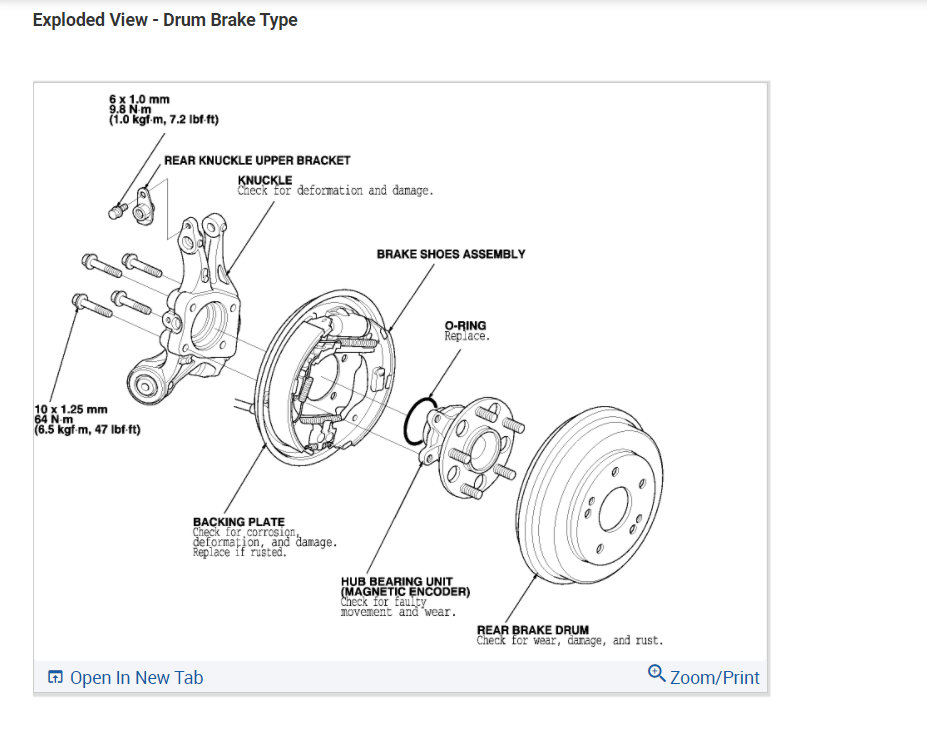

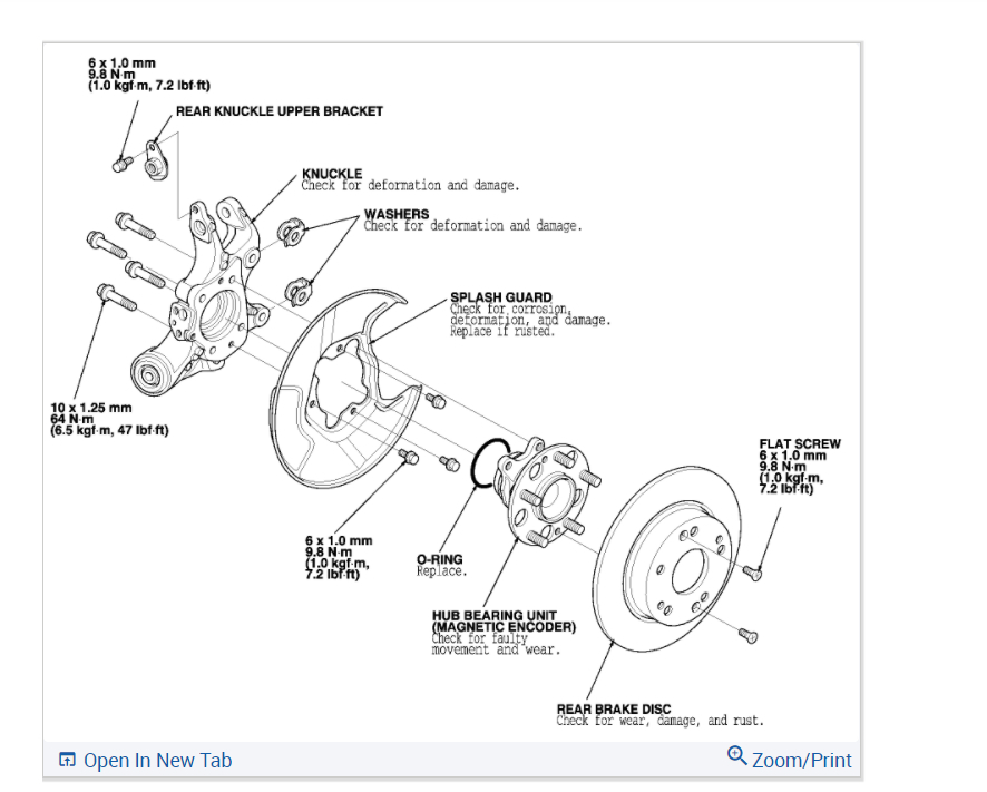

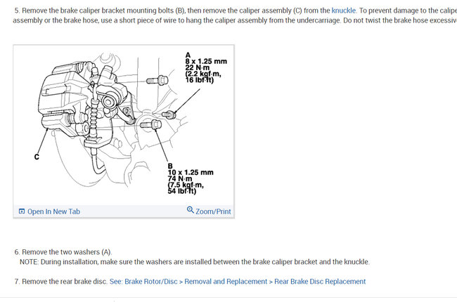

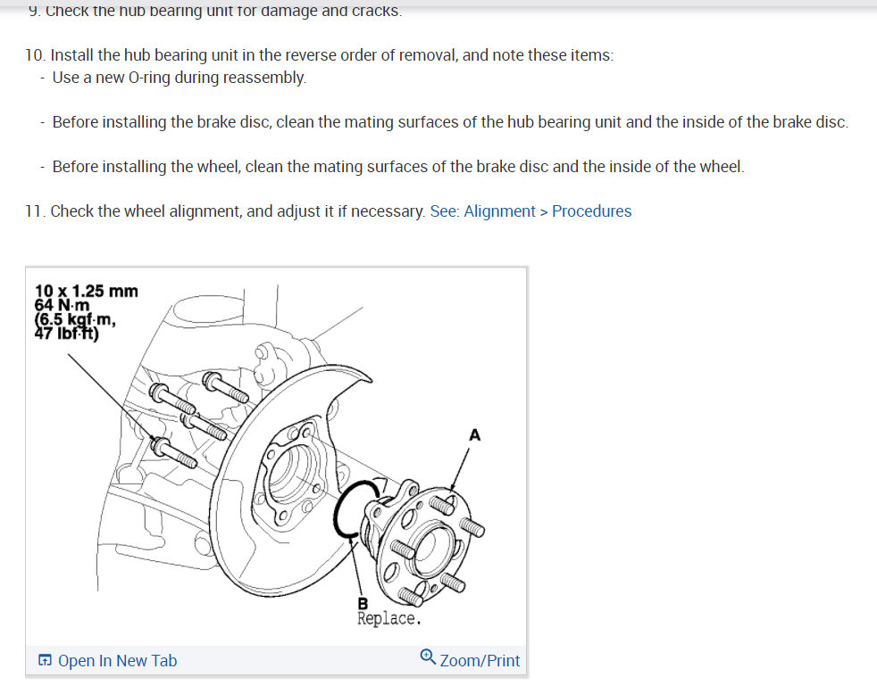

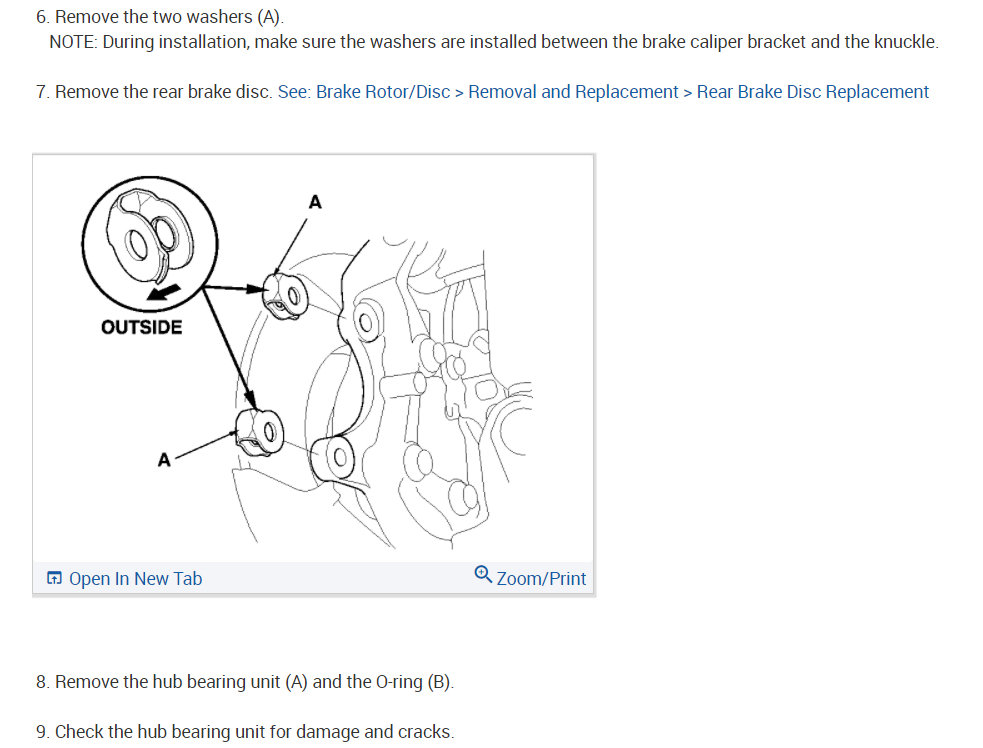

You should resolve the noise within a short period of time. If you do not, then you could cause other damage to the hub requiring replacement.
https://www.2carpros.com/articles/bearing-hub-replacement
I attached the procedure for you for the repair below.
Let us know if you have any other questions.
