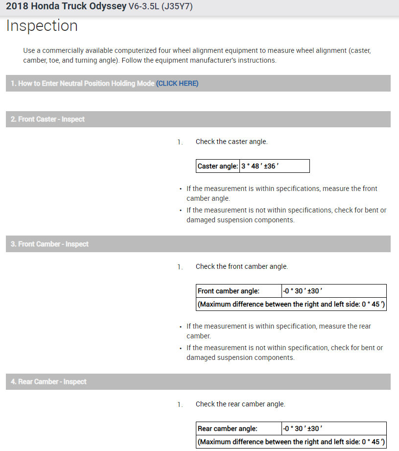

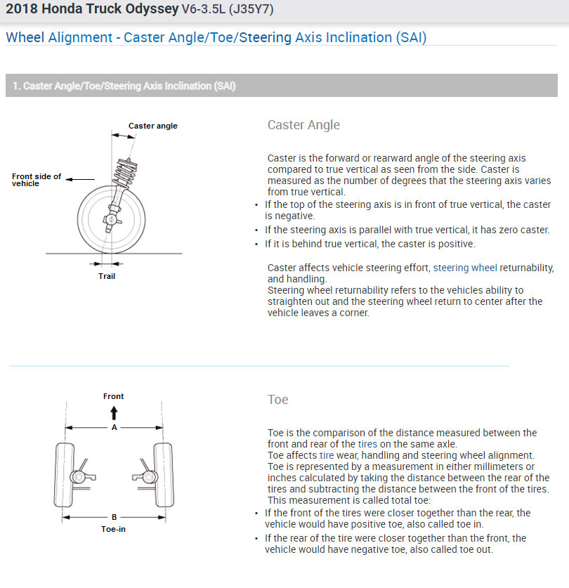

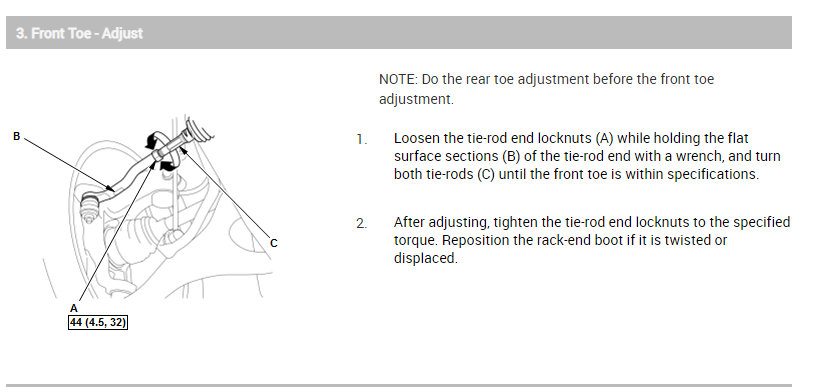

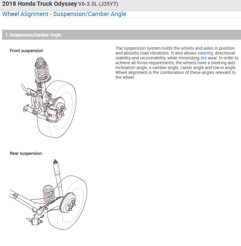

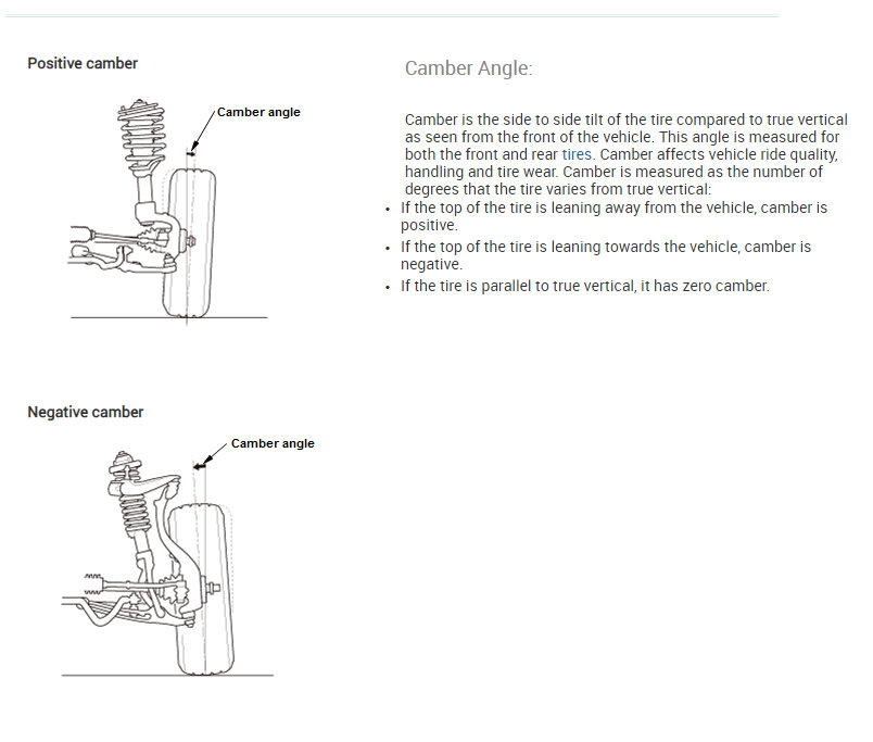

Hello friends,

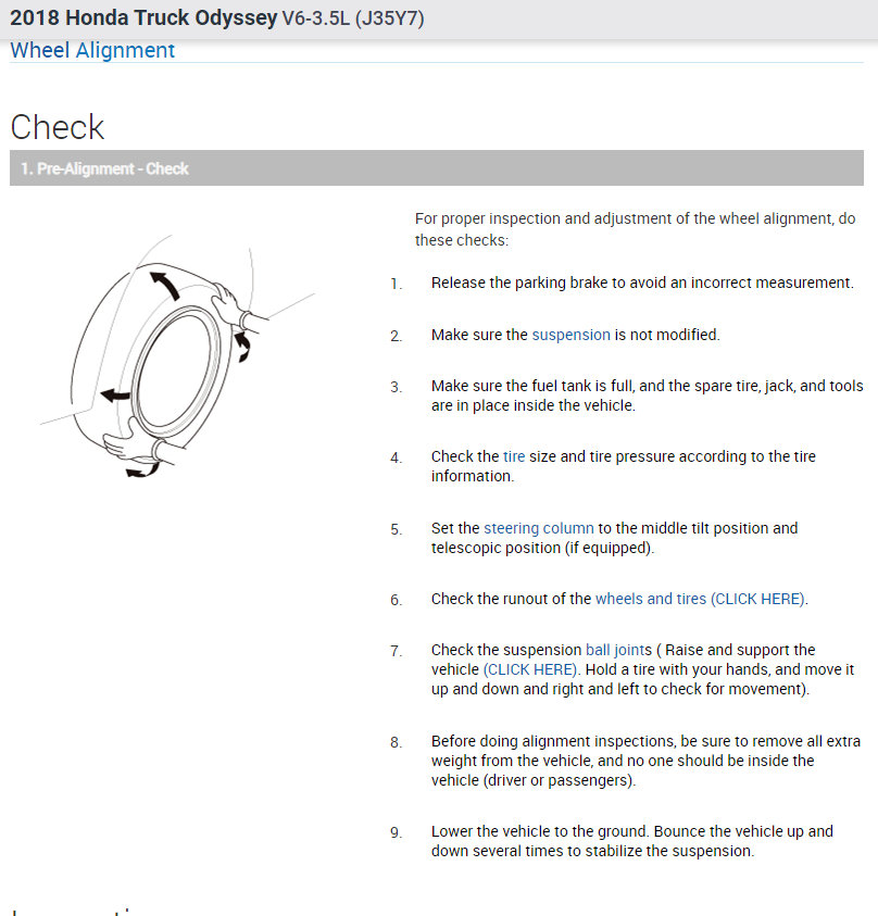

My brother bought the van listed above 2018/2019 3.6V6 EX-L after an accident. I need to know the alignment specifications as well as complete alignment procedures.
It is the van from USA and my service do not have this car in option car which can choose (I don't know how it explain in English). He needs to know all technical data which relates to wheel alignment - degree, mm, tilt angle, wheel alignment 0 or - or + (how many mm). I don't know how it all name, but it should be data values from. Mm or degree to. Mm or degree.
I am waiting for yours reply.
Have a nice day,
Pawel
Aug 25, 2021 at 9:09 PM
SQM
  • 6,383 POSTS

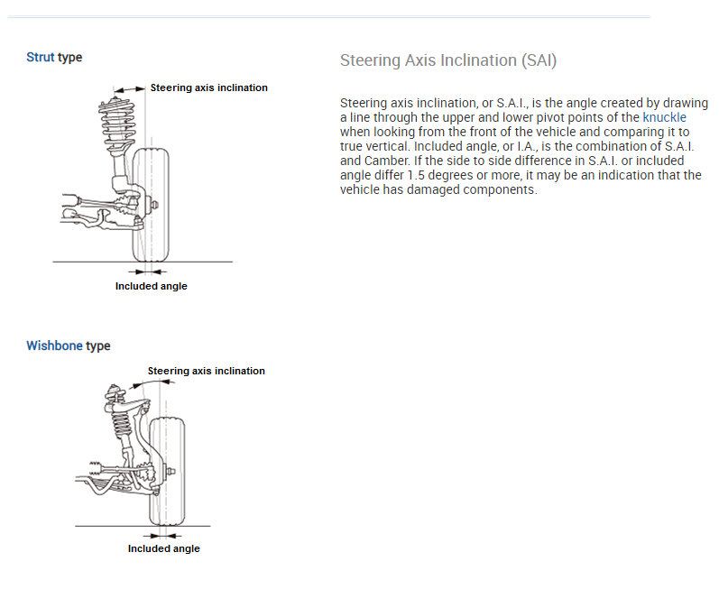

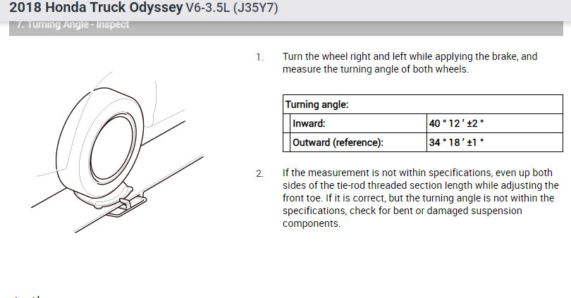

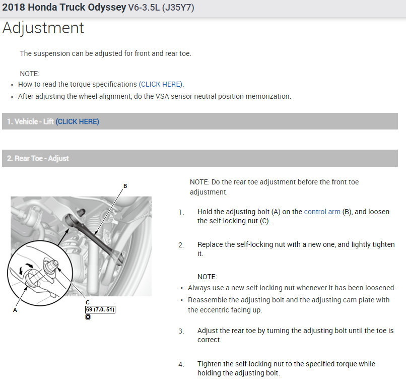

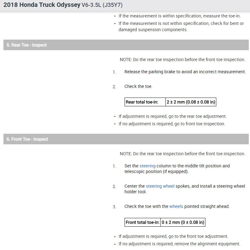

For proper inspection and adjustment remember to release the parking brake. Also this specifications are for the factory setup, if the suspension is modified they will not work.
Verify the tire pressure before getting started.
https://www.youtube.com/c/2carpros/featured
I have attached the alignment procedures and specifications (look below).

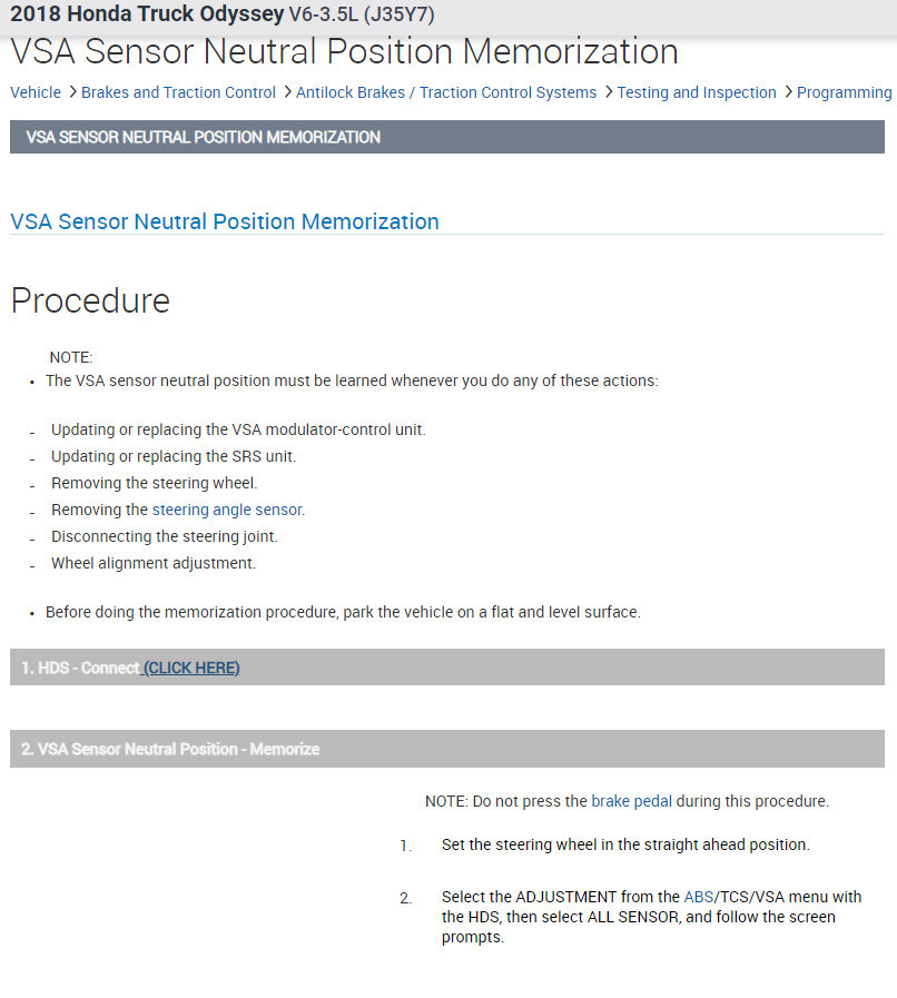

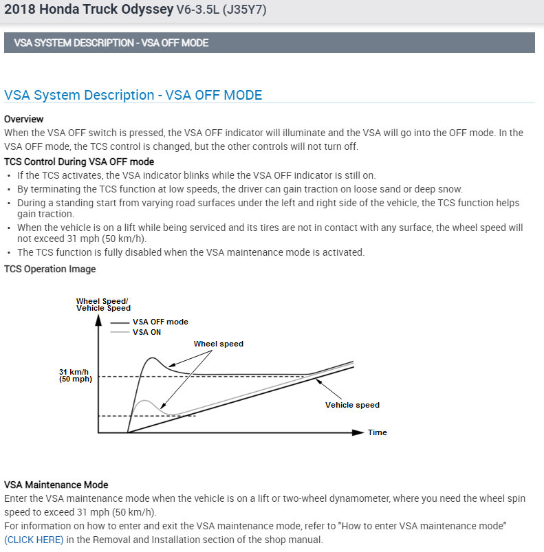

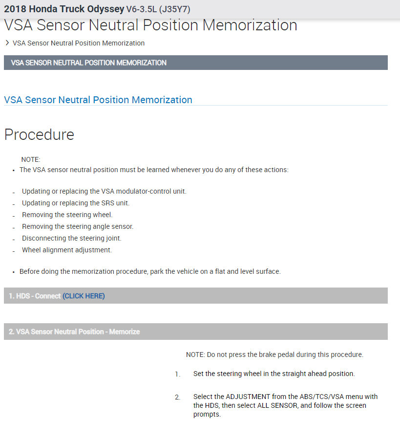

Hello again,

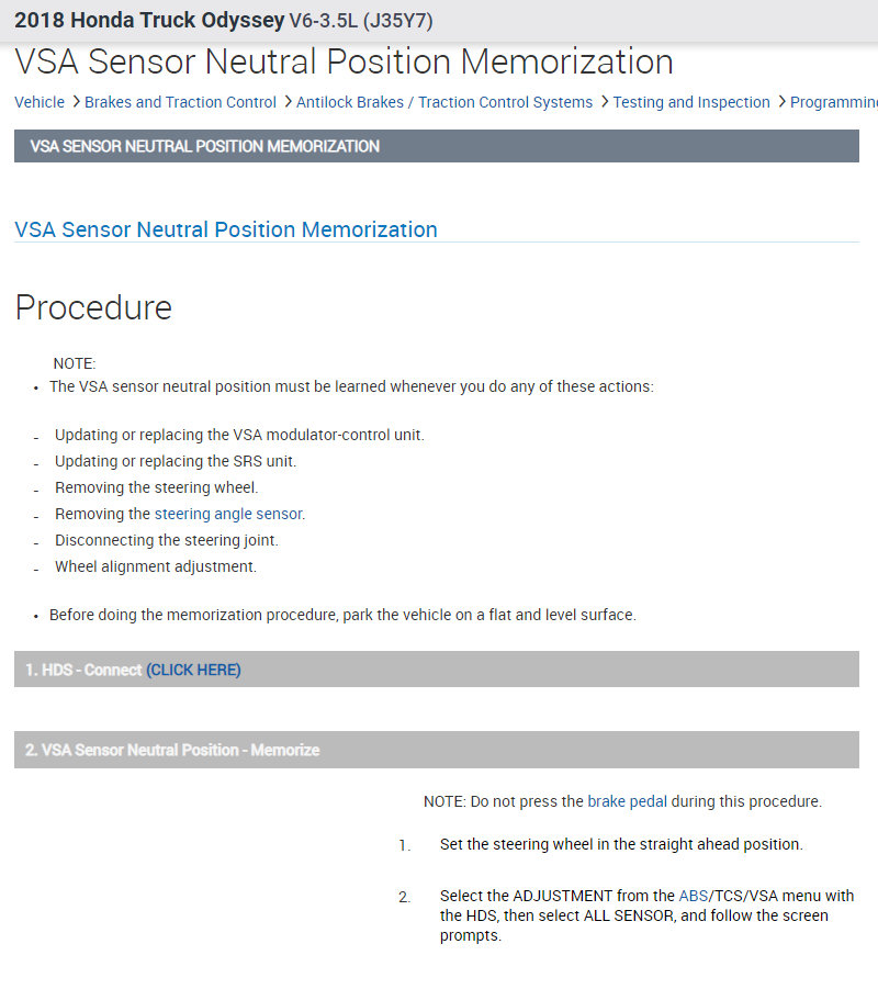

I have a question about VSA. There is VSA procedure after wheel alignment on the last page. Could you please add a full descriptor about VSA procedure? And could you please tell me if there are in Odyssey other systems which I should set or reset after wheel alignment procedure?
Sep 1, 2021 at 5:10 PM
SQM
  • 6,383 POSTS
In order to do the VSA relearn procedure it actually requires a HDS (Honda Diagnostic System) scanner. You will simply have to connect the scanner and follow the prompts (look below).
Let me know of any questions.

It was surprise - after replacing the rear suspension all errors/faults' indicators disappeared :-)
I did not set wheel alignment yet, but it looks okay. I am thinking that the wheel alignment is not 100% right position. And I have not to clear VSA error/fault, but I have to VSA relearn procedure to do.
Could you please explain step by step how it to do?
Sep 30, 2021 at 7:48 PM
SQM
  • 6,383 POSTS
That's good that the error codes went away.
See attached for the VSA relearn. Keep in mind that you will need a scan tool to perform this.
Oct 1, 2021 at 12:42 AM

Dear SQM - I did not understand you well...

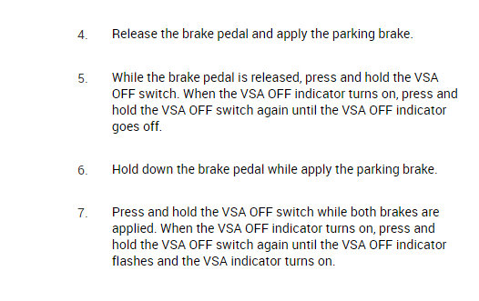

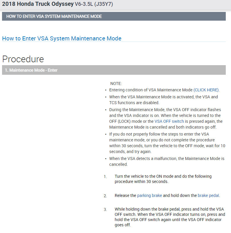

The first picture is about How to enter VSA System Maintenance Mode (5 dots and 1-7 steps). And third picture is about VSA Sensor Neutral Procedure Memorization. There are only two steps. What are the next steps? What is difference between Maintenance Mode (I think without HDS) and Procedure Memorization (with HDS)?
Oct 17, 2021 at 6:46 PM
SQM
  • 6,383 POSTS
The Neutral Procedure Memorization does only have 2 steps. As the rest will be prompted on the scan tool (if you look at the #2 step, it states that).
The vehicle needs to be entered to the Maintenance mode in order to perform the neutral position memorization.
There are few conditions needs to be met before the can go to the maintenance mode. See the attached information.
Let me know if this answers your questions.
