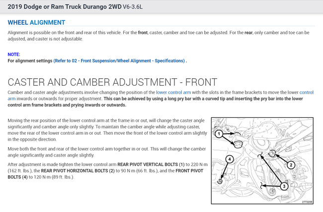

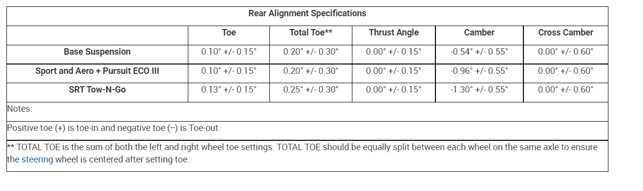

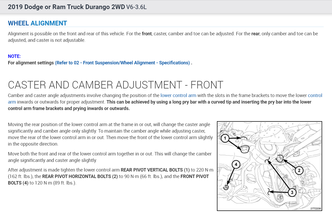

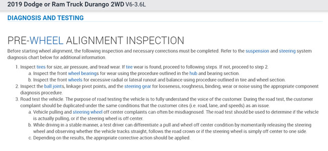

Can I get the alignment procedures and specifications related to wheel alignment?
20,000 MILES • 5.7L • V8 • 4WD • AUTOMATIC
PAWEL_N
  • 178 POSTS

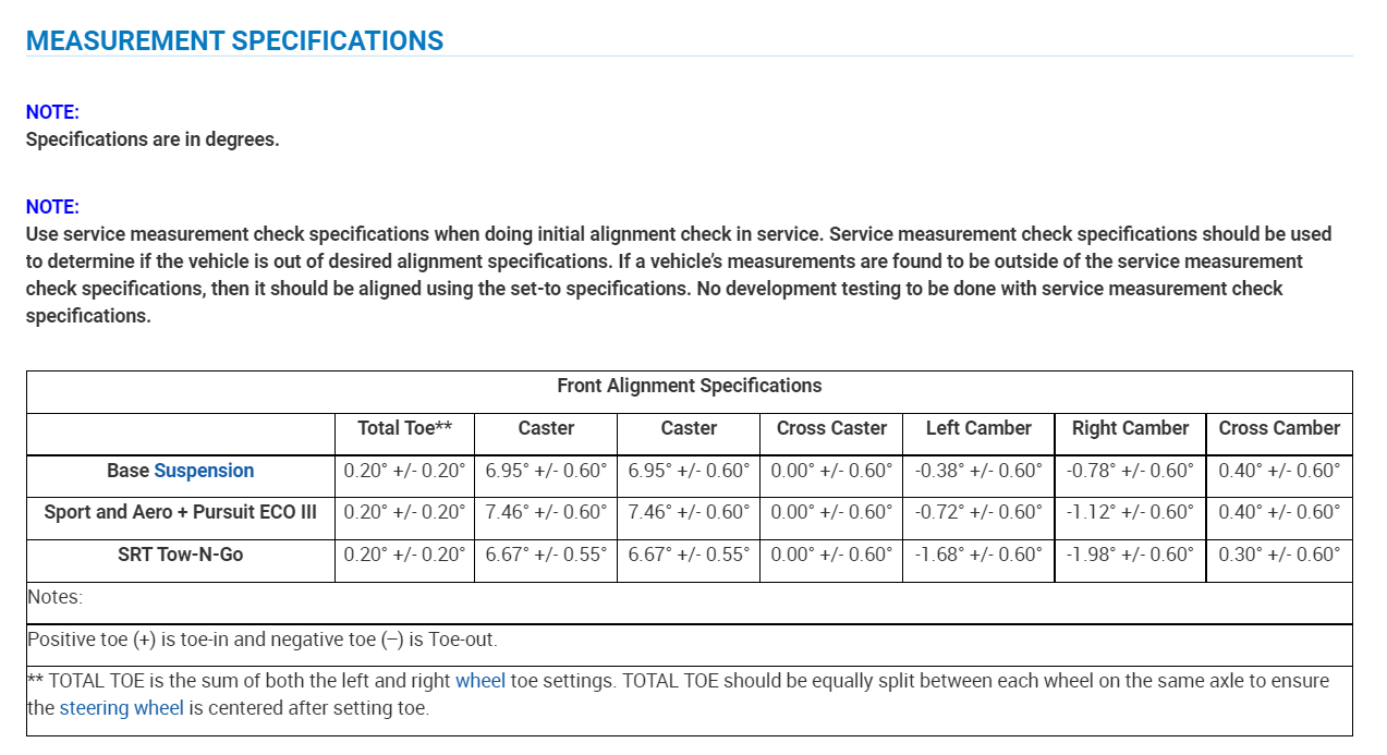

I am asking about the alignment procedures and specifications for my car.
I would like to know all technical data which relates to wheel alignment - degree, mm, tilt angle, wheel alignment 0 or - or + (how many mm). I don't know how it all name, but it should be data values from mm or degree to mm or degree.
I am waiting for your reply.
Have a nice day,
Pawel
Jul 28, 2022 at 10:01 PM
  • 55,732 POSTS

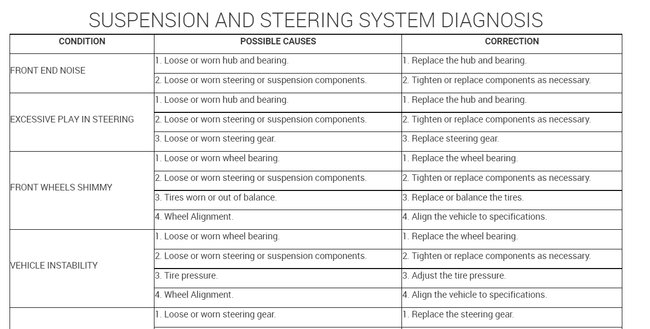

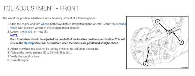

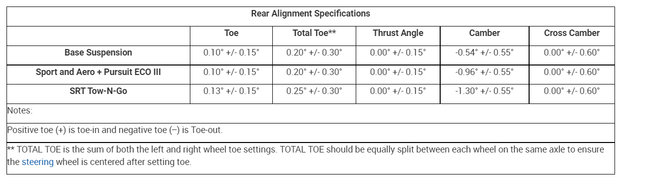

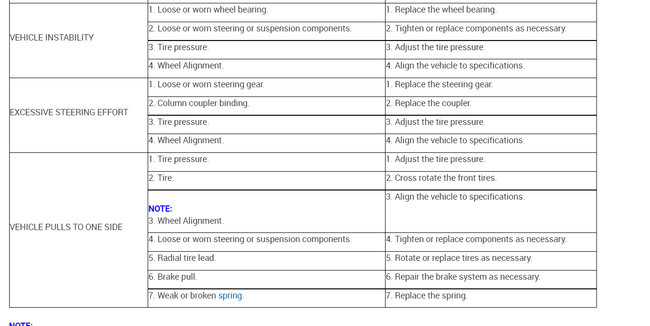

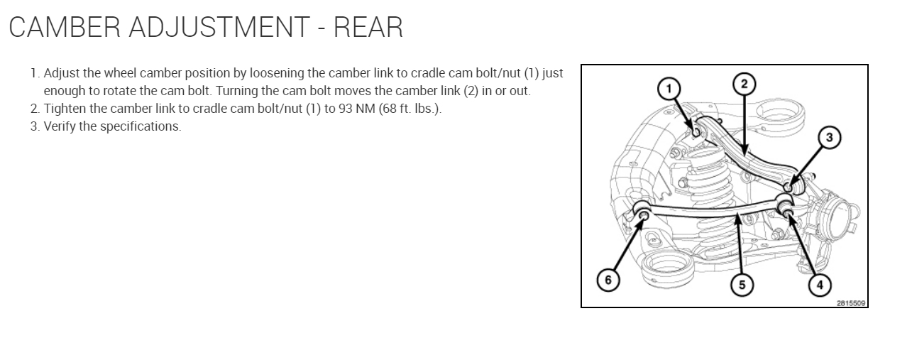

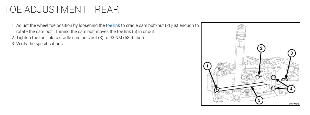

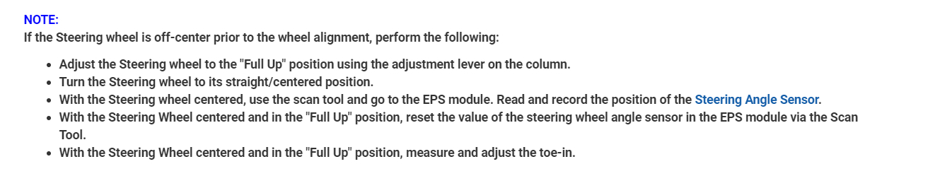

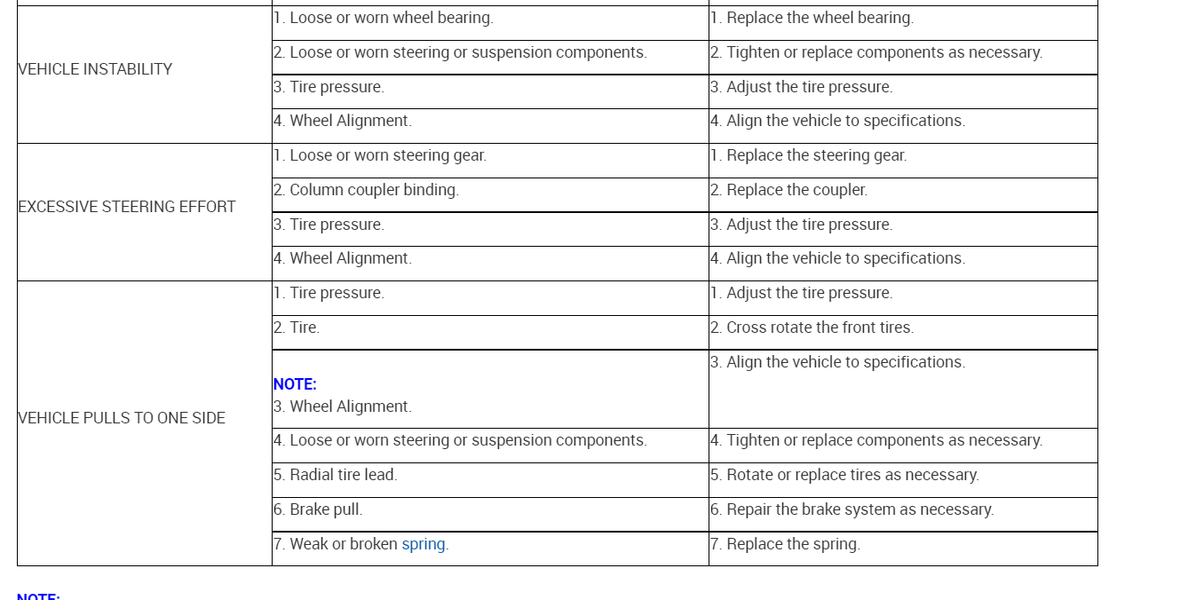

Here are the pre alignment instructions with the alignment specifications as well. It looks like there is a front and rear alignment that needs to be done on this car. Check the diagrams below. Check out the diagrams (below). Please let us know if you need anything else to get the problem fixed.
