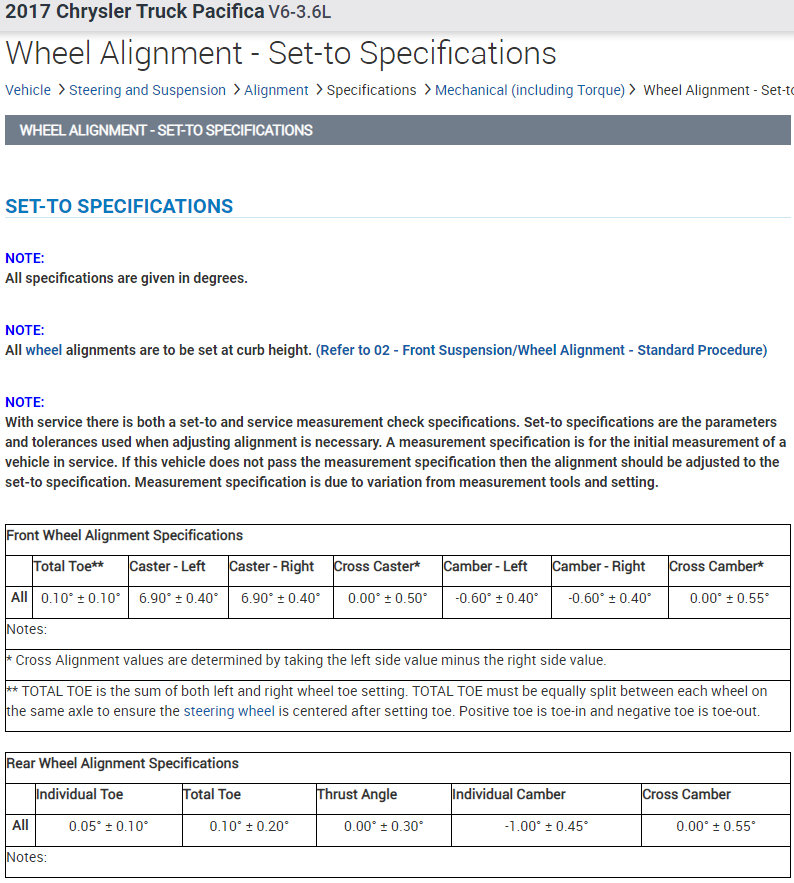

Hello friends,

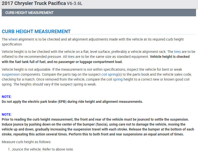

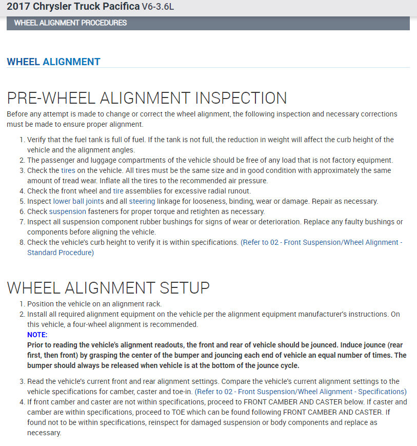

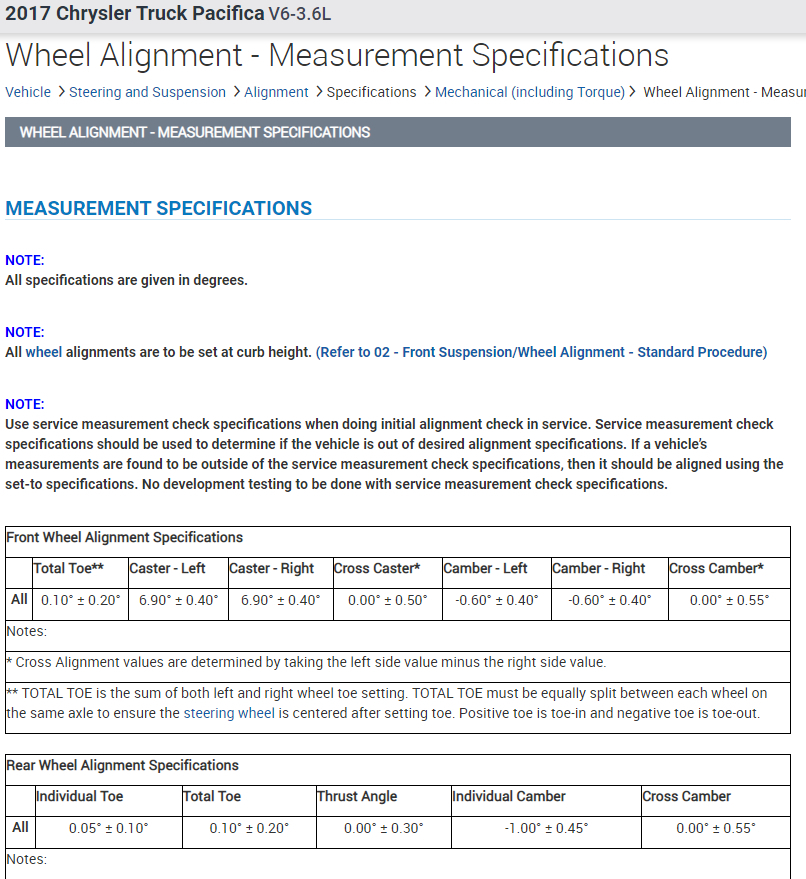

I have problem with wheel alignment. Tire tread wear is not the same inside and outside.
I went to my local wheel alignment service but the man didn't know technical data of pacifica 2017. It is the car from USA and he do not have this car in option car which can choose (I don't know how it explain in English). He need to know all technical data which relates to wheel alignment - degree, mm, Tilt angle, wheel alignment 0 or - or + (how many mm)... I don't know how it all name, but it should be data values from ... mm or degree to ... mm or degree.
I am waiting for yours reply.
Have a nice day,
Pawel
Jul 20, 2021 at 5:26 AM
SQM
  • 6,383 POSTS

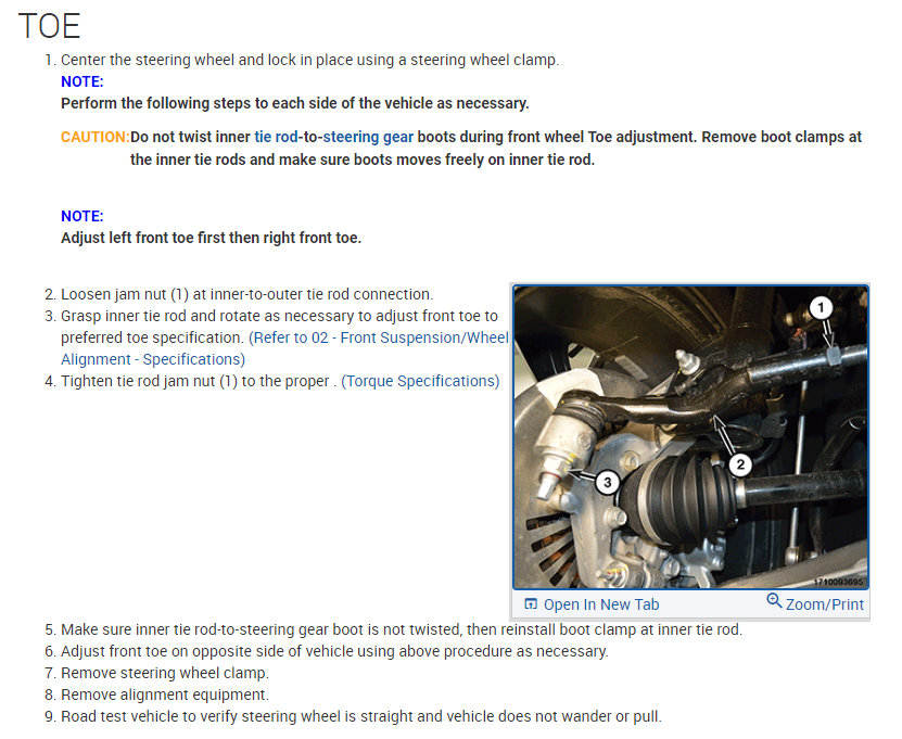

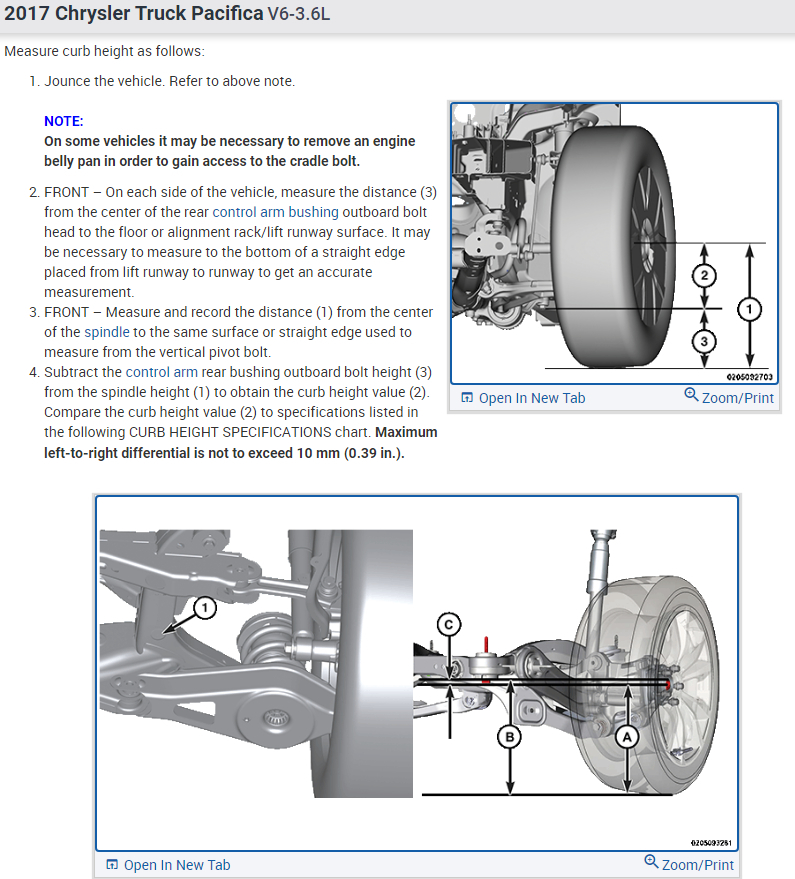

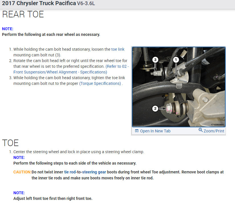

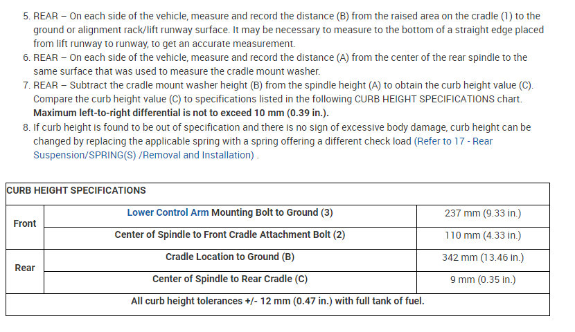

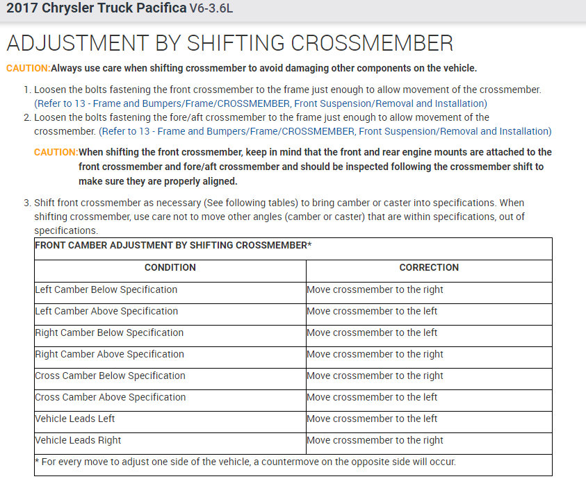

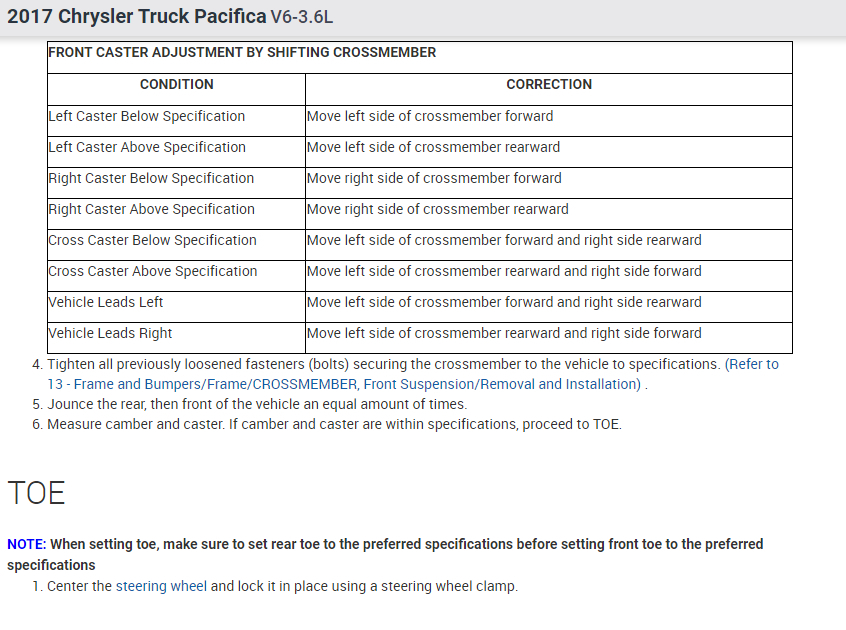

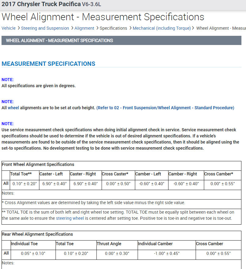

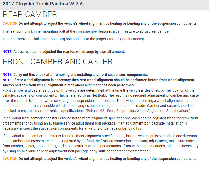

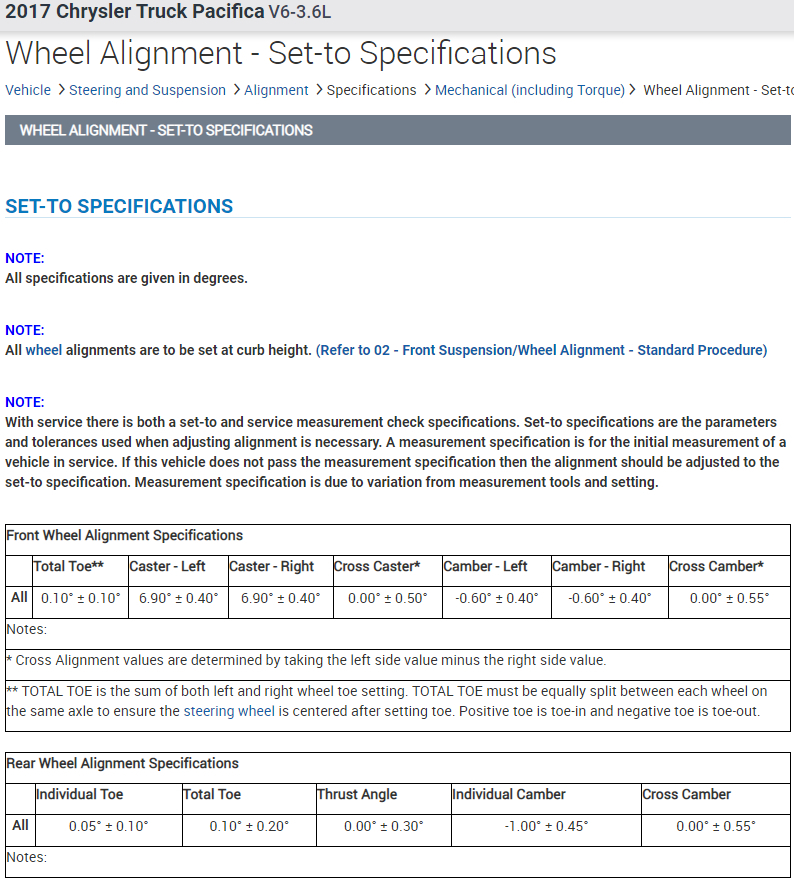

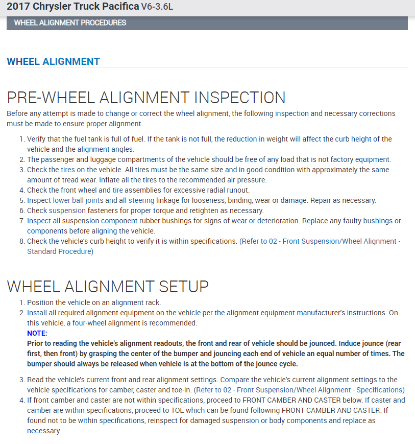

Hello Pawel,
More than happy to help.
I have attached the alignment specifications as well as complete alignment procedures for your reference.
Please let me know if you need any other info.

Hello again,
I got the reply that while wheel alignment in Honda Odyssey I have to do VSA Sensor Neutral Position Memorization. And I have a question about Pacifica - Is this system in Pacifica present? Or should I some system/systems set or reset in Pacifica after wheel alignment?
Sep 1, 2021 at 4:45 PM
SQM
  • 6,383 POSTS
The Pacifica does not require a relearn process like the Odyssey.
