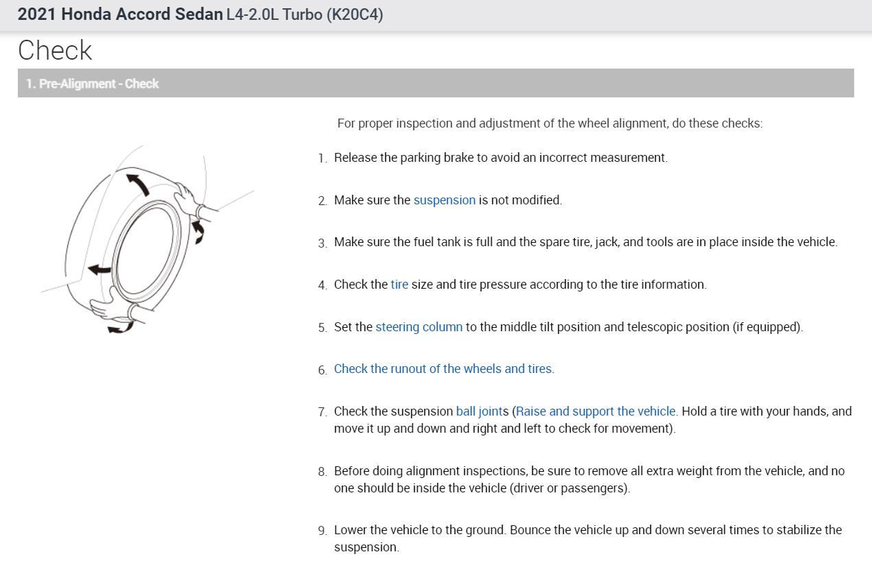

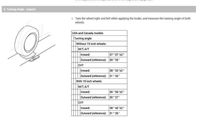

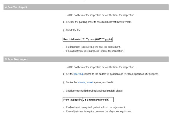

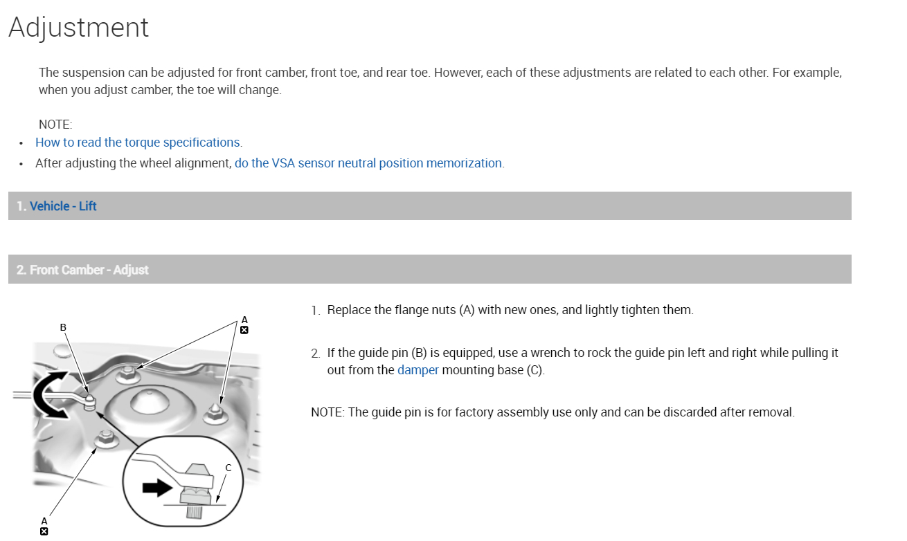

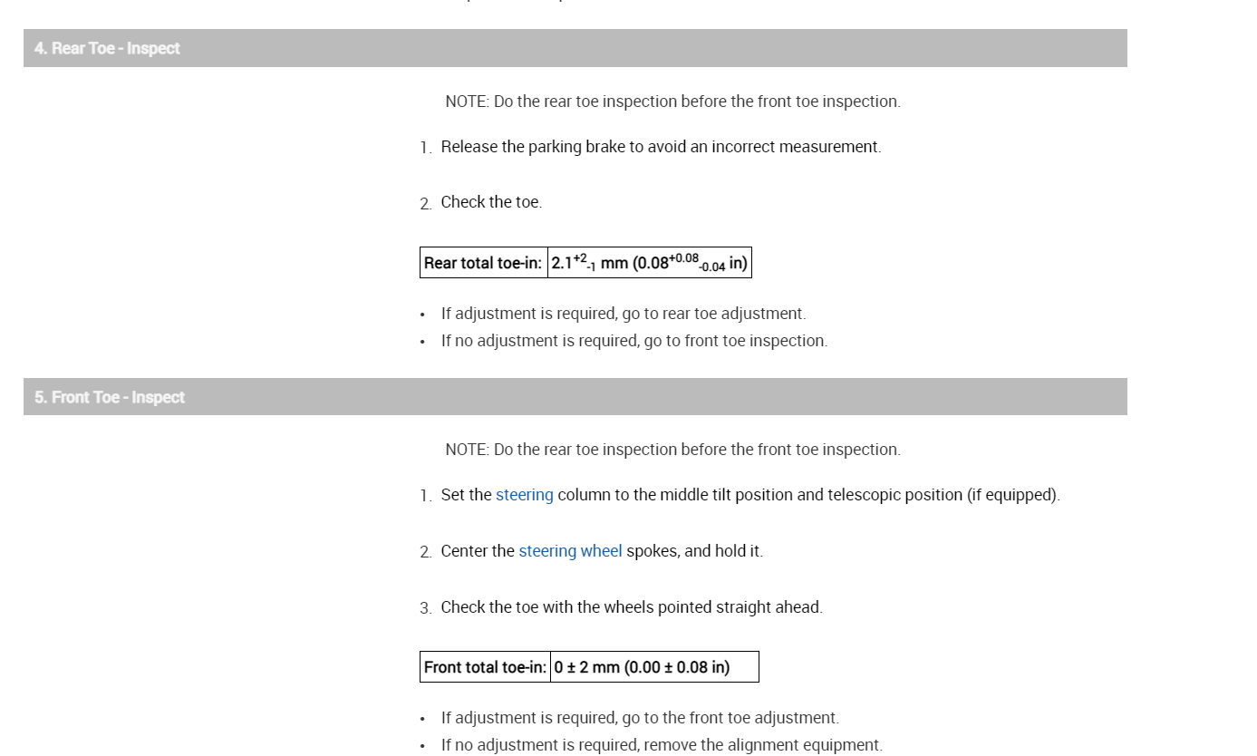

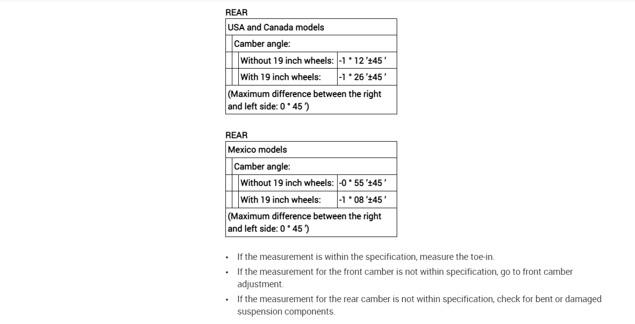

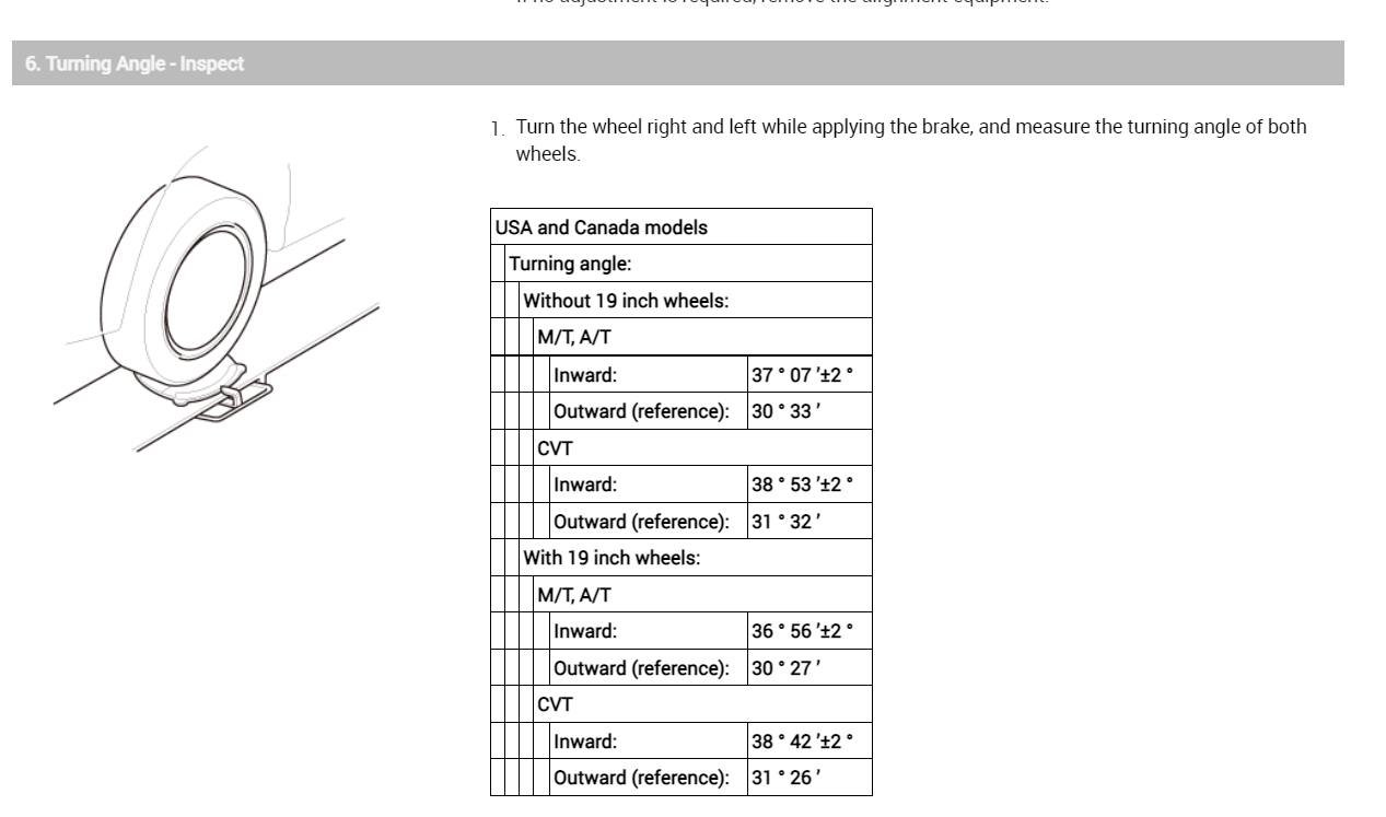

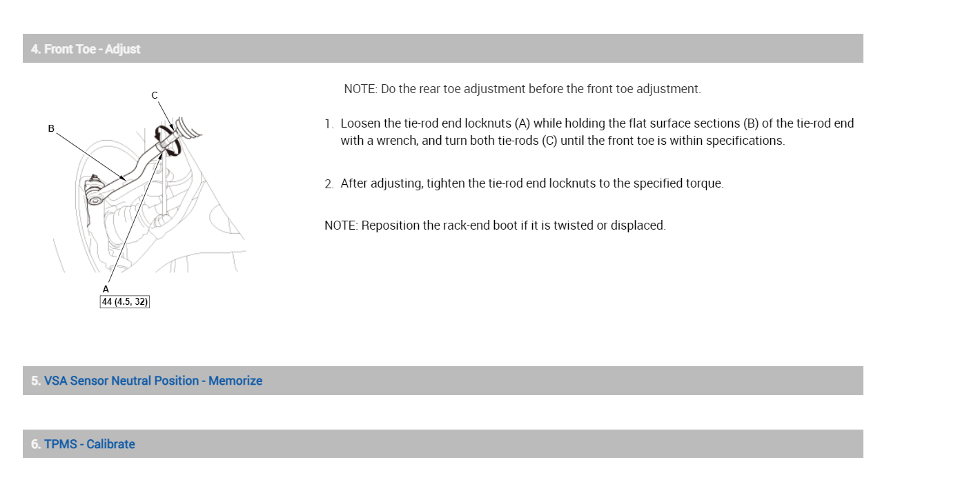

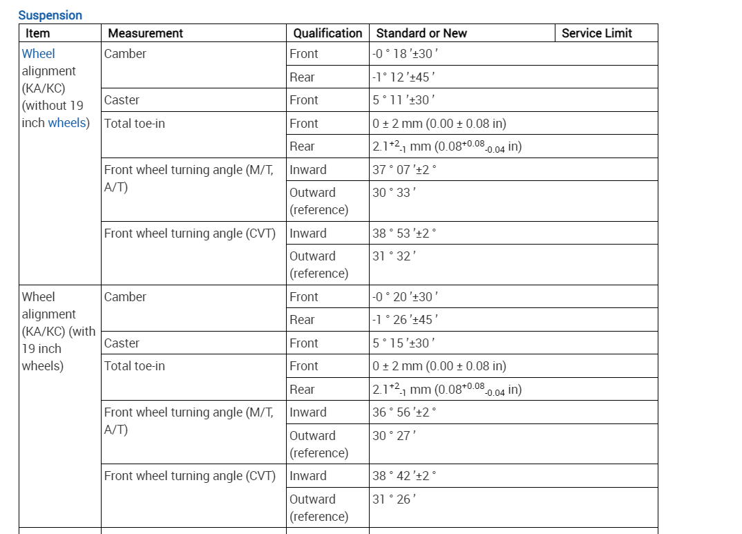

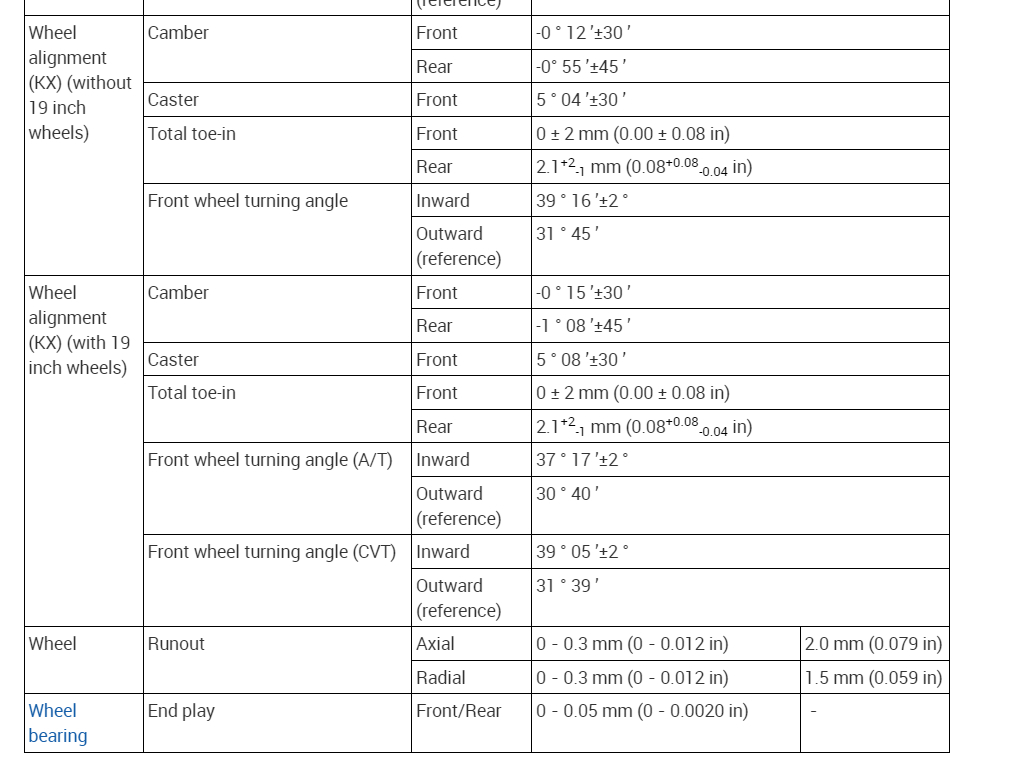

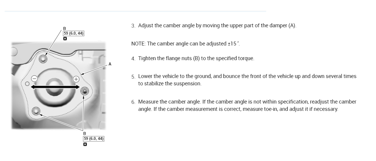

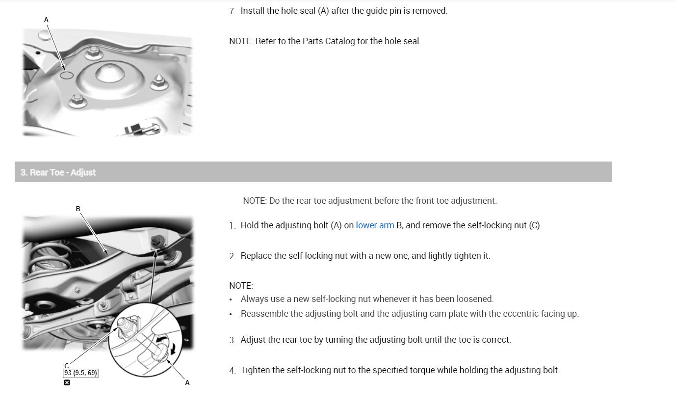

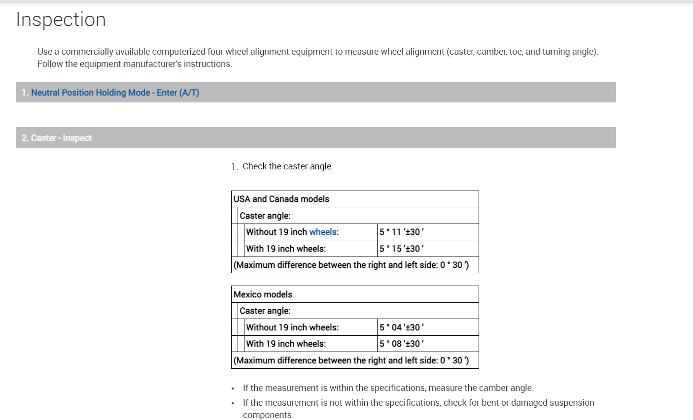

I have the car listed above, wheel size 18, and I am looking for wheel alignment diagram because I went to more than one workshop and they did not have enough information.
Apr 2, 2023 at 12:57 PM
  • 55,433 POSTS

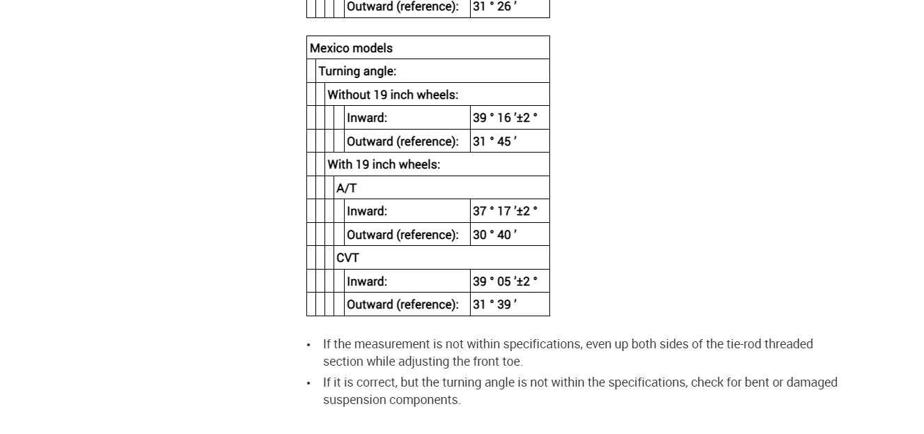

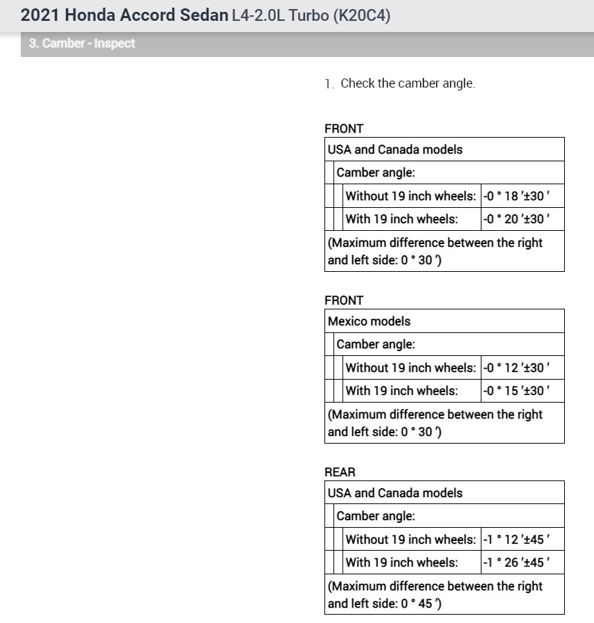

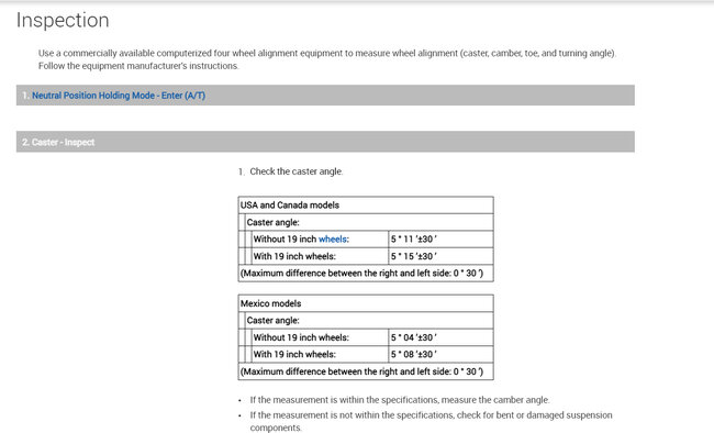

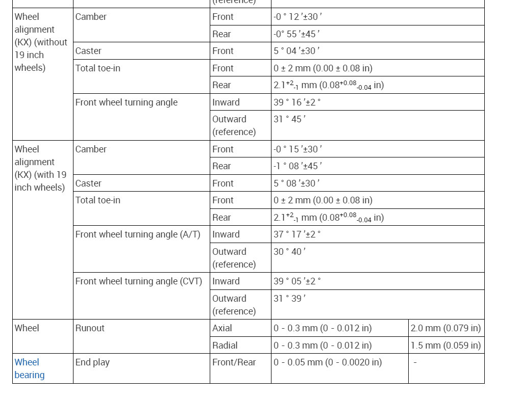

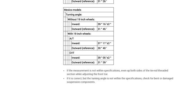

Sure, here are the front and rear end alignment specs and instructions on how to make adjustments in the images below. Please let us know if you need anything else to get the problem fixed.

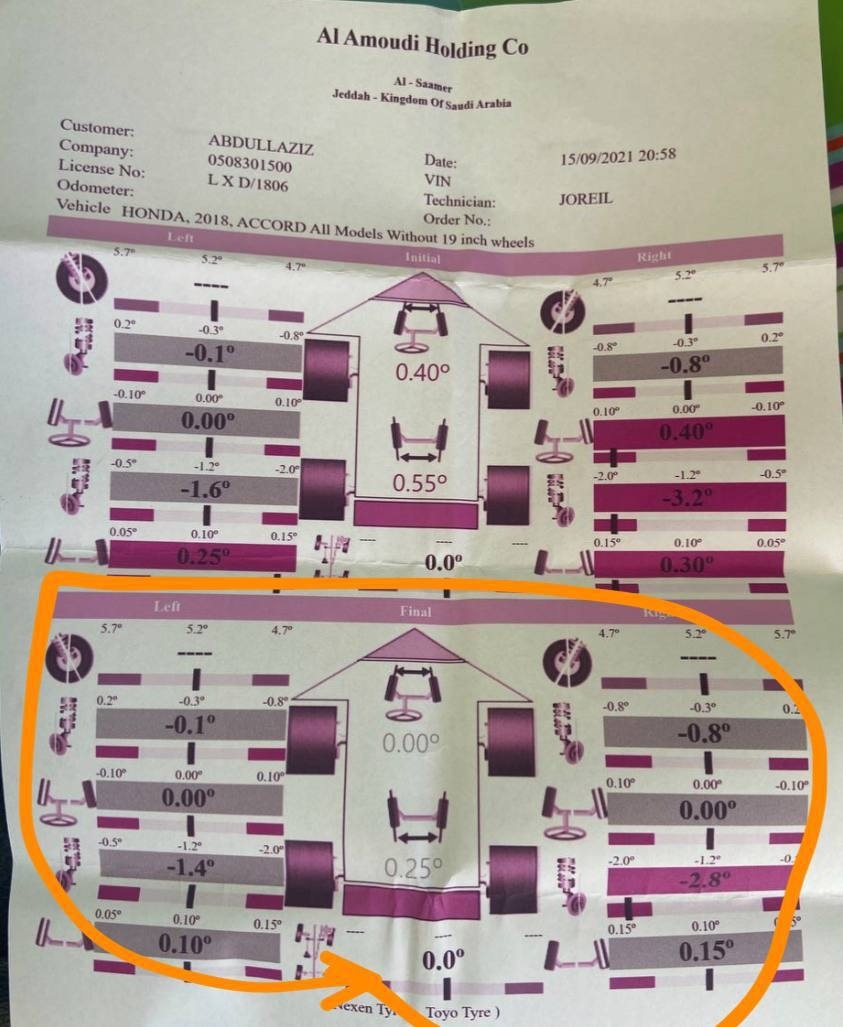

Thank you for your help, but I want a simple explanation like the attached picture if possible or close to it (this is the alignment of my friend's car) and thanks again.
Apr 3, 2023 at 11:04 AM
  • 55,433 POSTS
Sorry, the above instructions are all they give us. Where did you get the readout shown?
Apr 4, 2023 at 3:07 AM
MAHER_14
Thank you for the information. My friend sent it to me when he changed the tires of his car, and the same shop did the alignment of the tires, and I do not know if it is correct or not, the shop is in Saudi Arabia
Apr 7, 2023 at 3:05 AM
  • 55,433 POSTS
The readings look correct. What kind of problems are you having or are you just confirming the specs?
