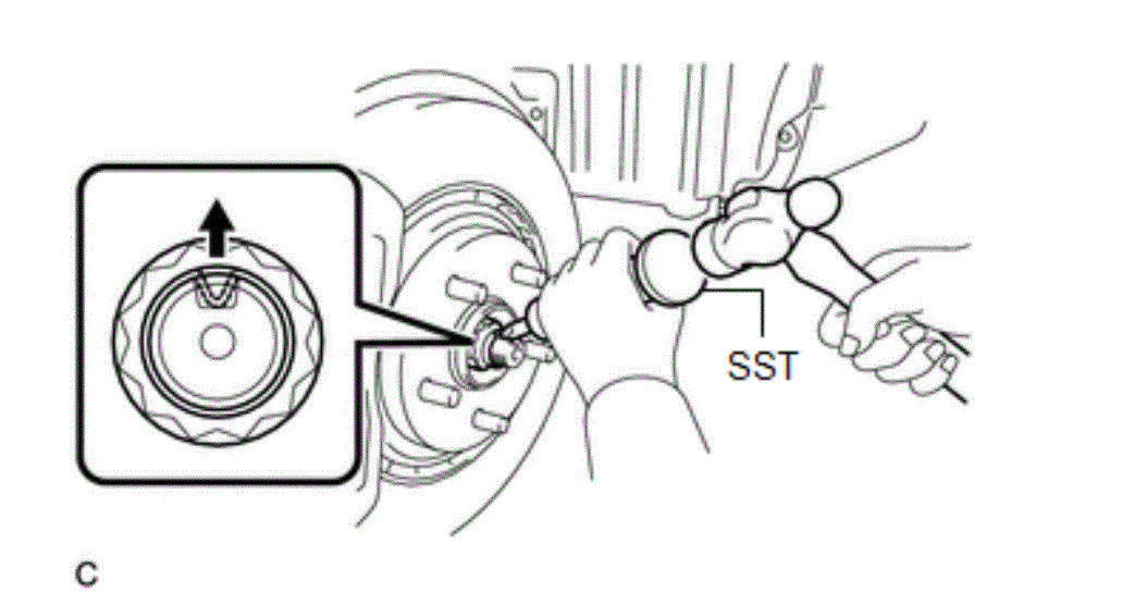

REMOVE FRONT AXLE SHAFT NUT
Using SST and a hammer, release the staked part of the front axle shaft nut.
SST : 09930-00010
NOTICE:
Loosen the staked part of the front axle shaft nut completely, otherwise the threads of the drive shaft may be damaged.

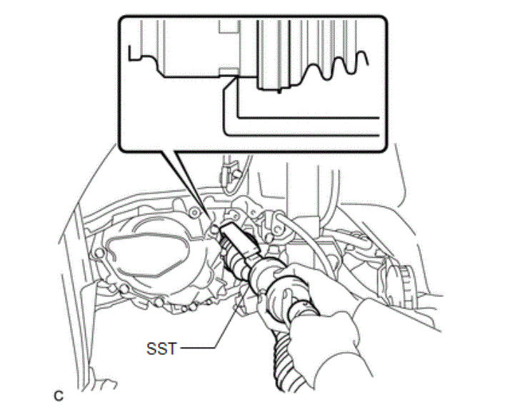

SEPARATE FRONT DRIVE SHAFT ASSEMBLY
Click here [ AXLE AND DIFFERENTIAL: FRONT AXLE HUB: REMOVAL+ ]
REMOVE FRONT DRIVE SHAFT ASSEMBLY LH
Using SST, remove the front drive shaft assembly LH.
