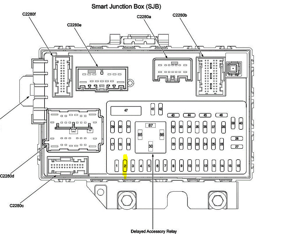

My vehicle suddenly wouldn't move, my transmission completely locked up. I had to override this by sticking a pen into the reset switch, then the shifter moved and the car is drivable, however mostly all electrical seems to be out. My headlights, taillights, front and back blinkers lights are out, brake lights, radio, dome lights, and power windows, so all major systems. The horn works, and the dash lights work but that is about all. I also have a light illuminated in red saying I P. believe this means parking brake however the parking break is disengaged. Took it for a drive to assess all this and an awful, strong, sulfur egg smell filled the car from the A/C, which was working good along with the wipers working. We are on vacation and at a shady hotel, could someone have unplugged something? Possibly from underneath the vehicle? What does my car need? A new battery or something more?

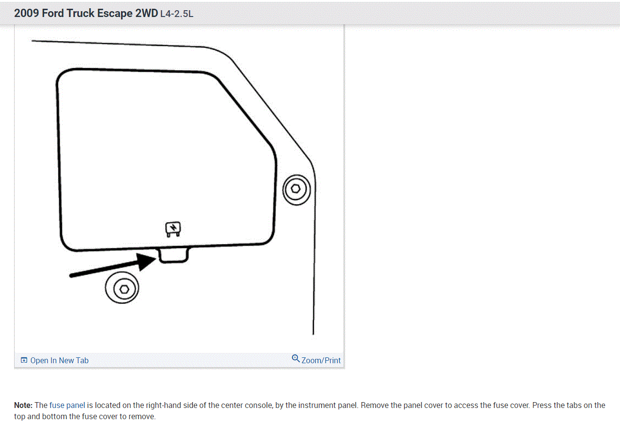

If the brake lights aren't working, that is why you can't shift out of the park. The park lock actuator is powered by the brake light switch. Let's start there. Since it is running bad, there is likely more to it, but I need to know if there is a loss of power to the SJB.
The brake light fuse is in the smart junction box (SJB) to the right of the center console. See pic 1 below. Check fuse 2 in that box (see pic 2). It is for the brake lights. In addition to checking the fuse, confirm it is getting power. Here is a link to help:

Yes, the only two things working as of now are the horn and the wipers, and the starter motor. It's not a hybrid, however it is considered limited edition. I have checked fuses under the hood, they appear to be all plugged in, I will go look under the dash now. I will also check the brake light fuse as you suggested, I will let you know what I find out.

Let me know what you find. Also, it is really important to let me know if the fuse is or isn't getting power, regardless of its condition.
I will wait for your reply.
