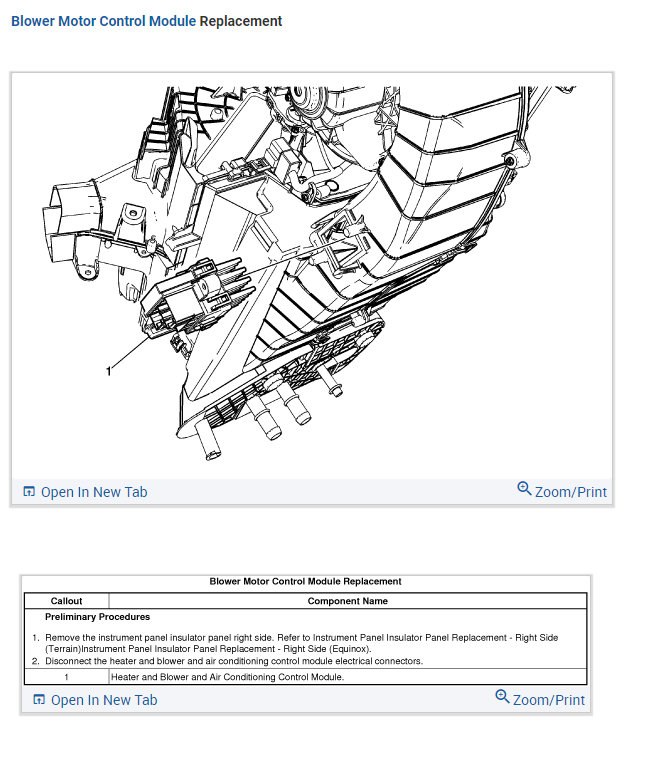

Hello. I have an issue with my vehicle’s A/C-heat speed. The speed stays on full blast and whenever I want to turn it off it doesn’t turn off. I can’t change the speed of the air at all. Whenever I drive I have to drive with either the A/C or heat on, no way for me to turn it off.
Feb 27, 2021 at 3:14 PM
NICKOLAOSF
  • 69 POSTS
Hi CYNDITAMAYO,
We can help you with this information.

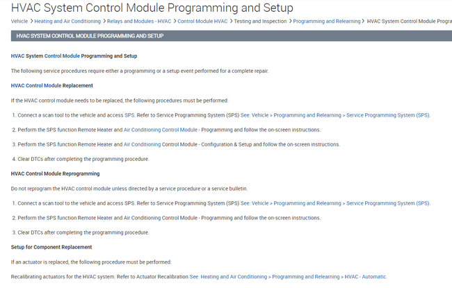

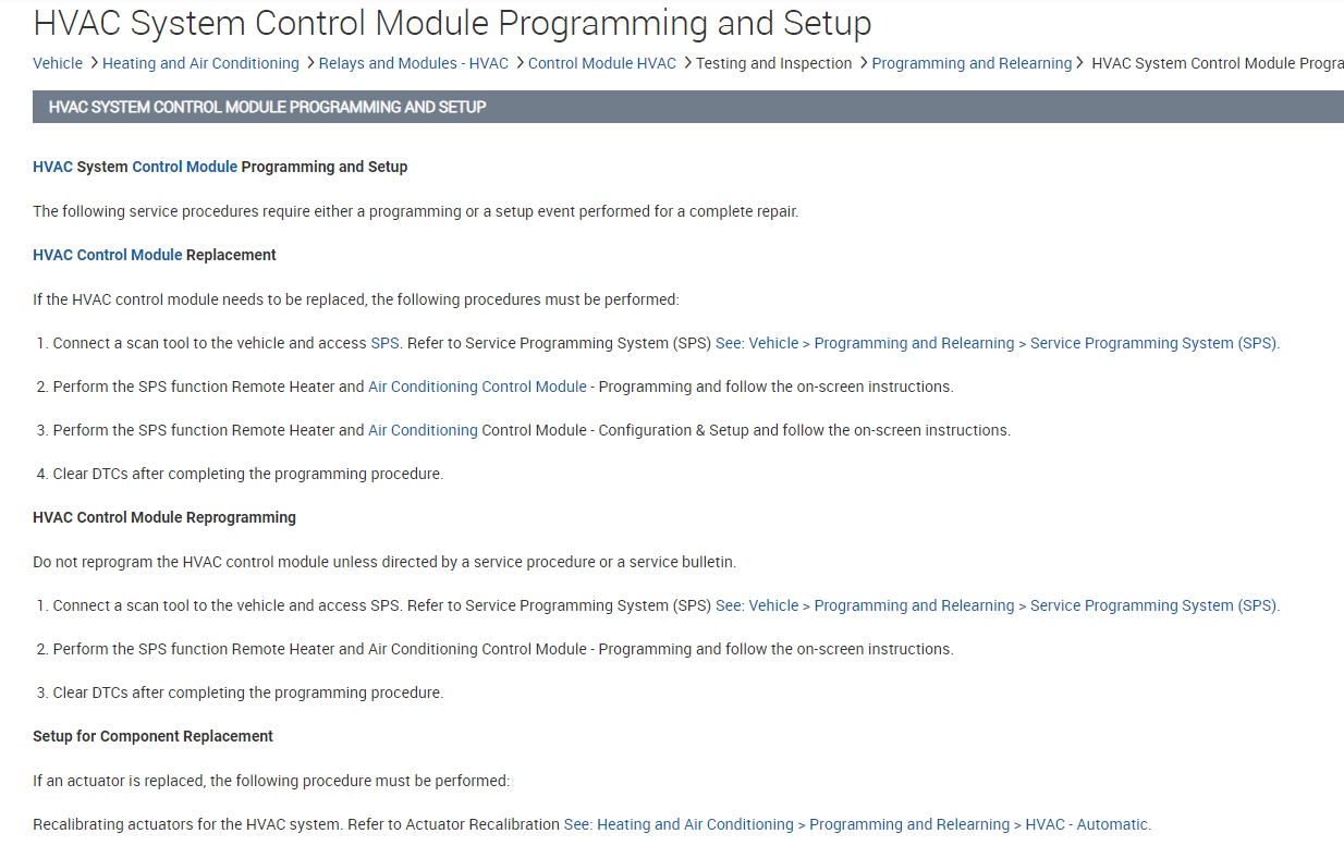

This sounds like you have HVAC control unit malfunction
programing and set up is required.
Cheers, Nick
