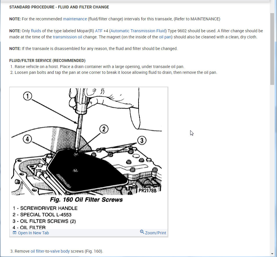

While driving my car will just jerk out of nowhere and it does it when I stop too
124,491 MILES • 2.0L • 4 CYL • 2WD • MANUAL
TOPKK83
And when it jerks my speedometer goes down then jumps right back up to where it was. And a couple of times when I'm sitting in the car it will jerk then shut off.
May 3, 2021 at 6:19 AM

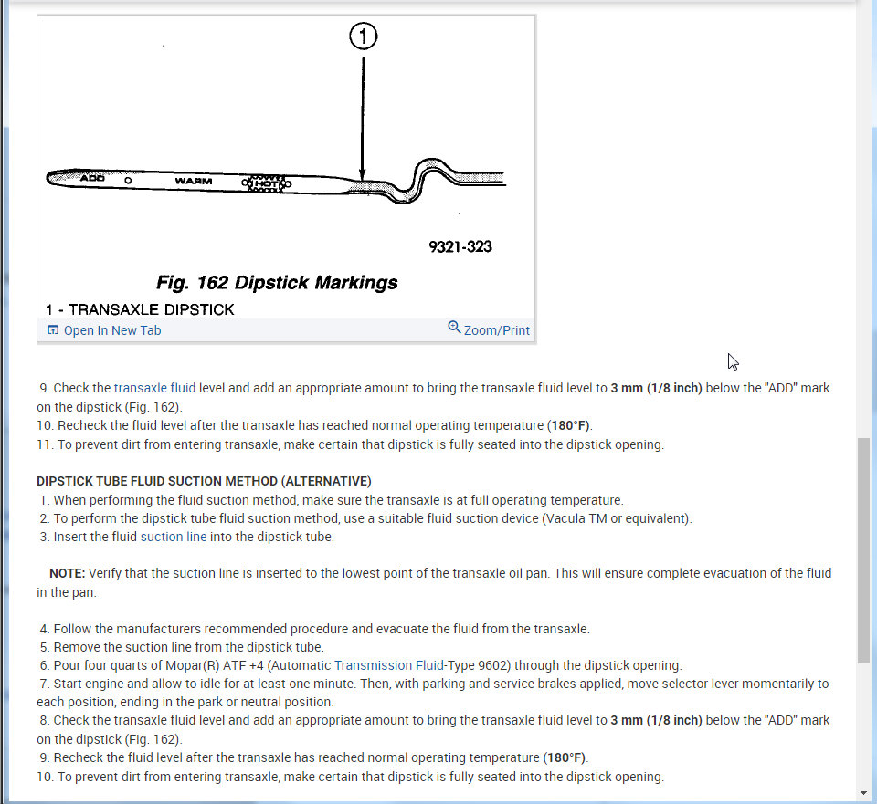

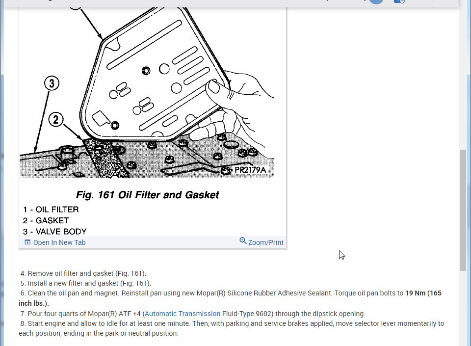

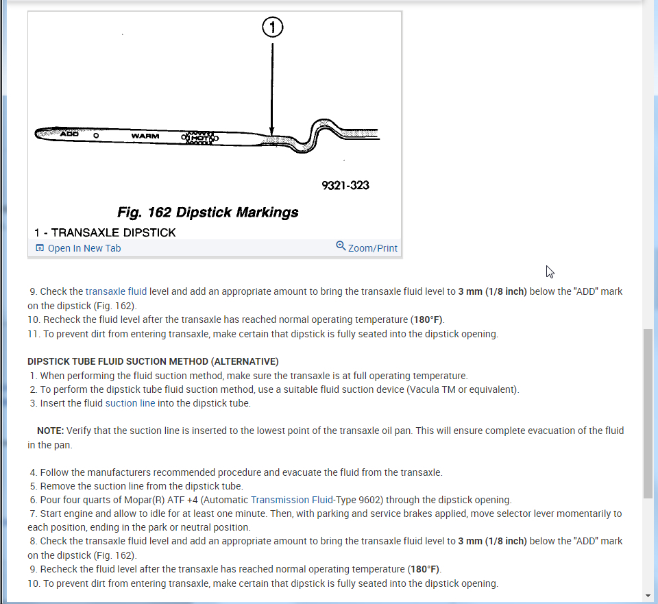

This sounds like a torque converter issue since it is shutting off, but we need to start with checking the fluid level and condition.
Below is the process on how o change the fluid and filter which is what I would do if the level is a little low or dirty.
Let us know what you find with this and we can go from there. Thanks
