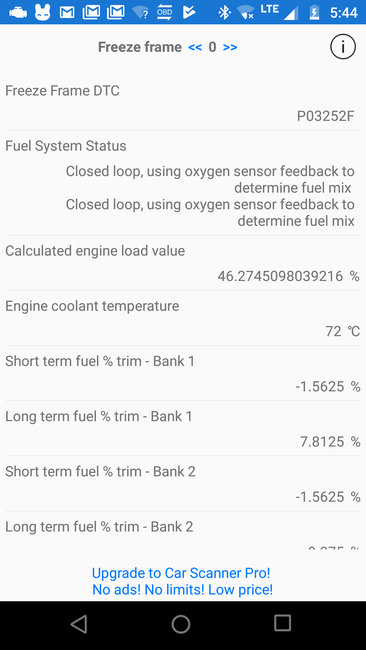

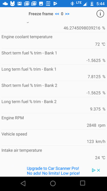

OBD2 keeps freeze framing this. Not sure what it means. Shows the DTC is p0325f. What is that?
Sep 21, 2019 at 12:51 PM
JIS001
  • 3,412 POSTS
If it is P0325 then that will be for the right side bank knock sensor. What brand sensor did you use? As stated earlier, if it was accidently dropped it makes it useless. And when you say you replaced the harness which harness are you talking about? The engine harness alone can run almost $3000 let us know please.
