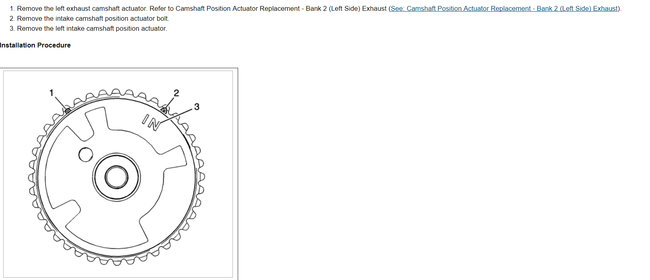

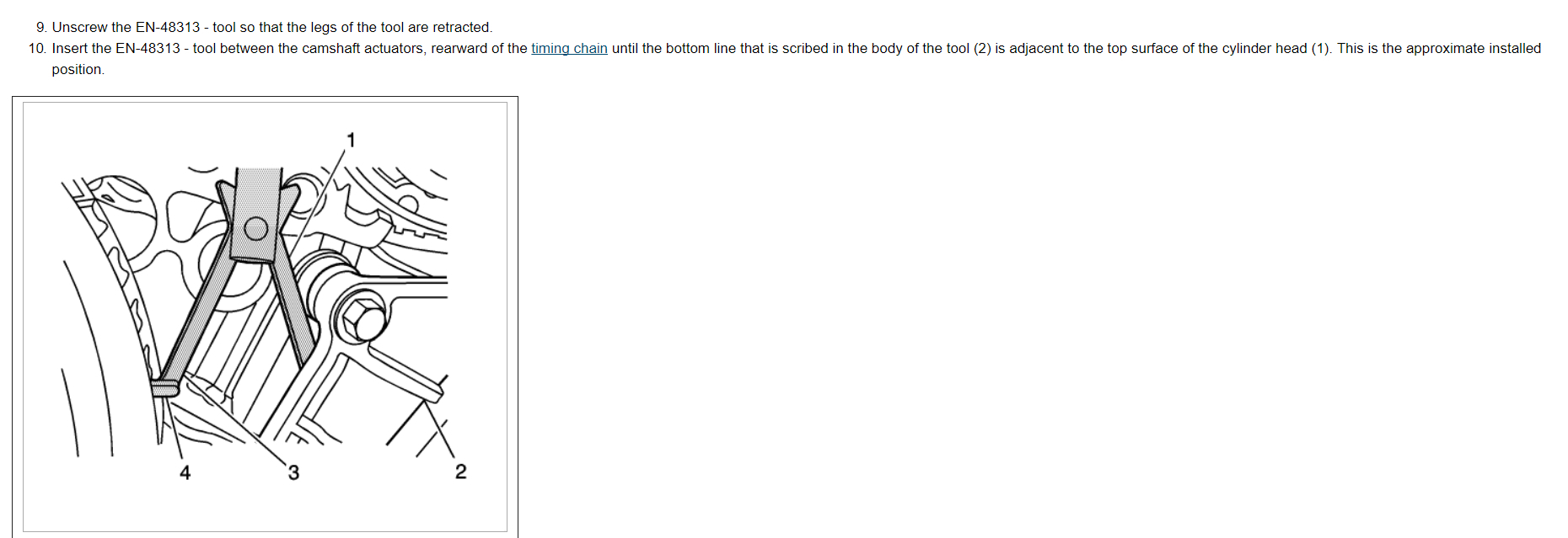

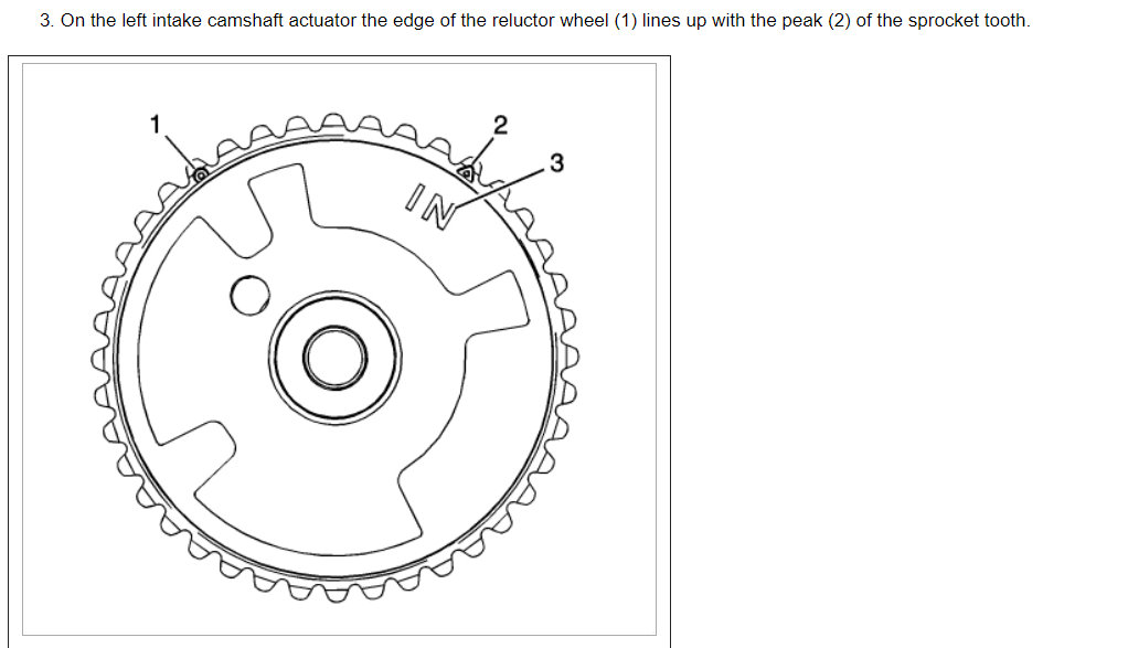

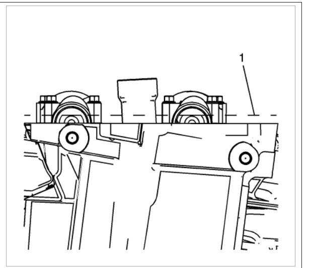

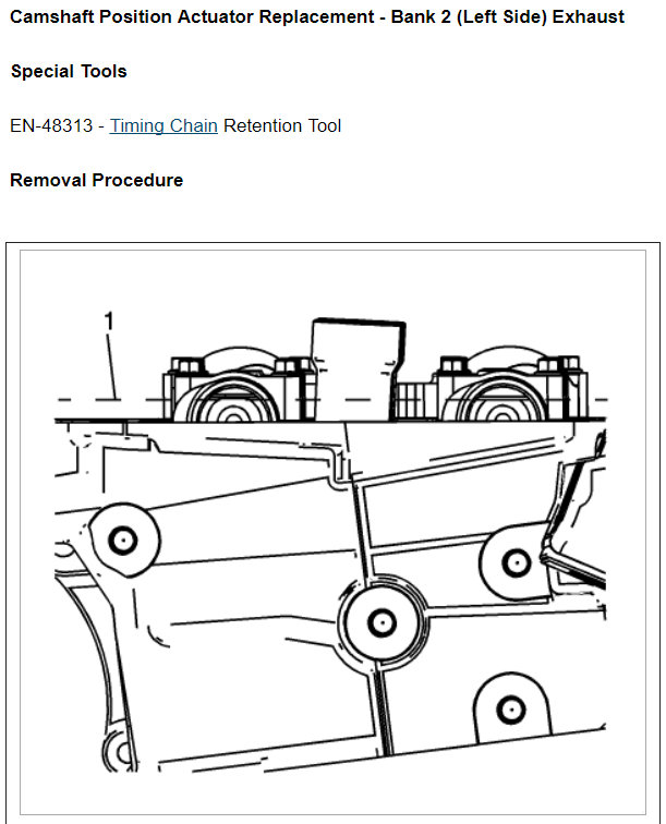

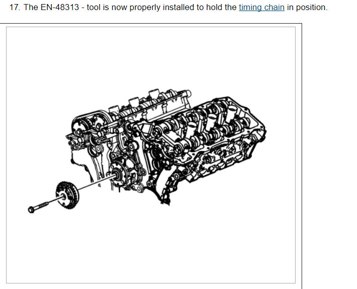

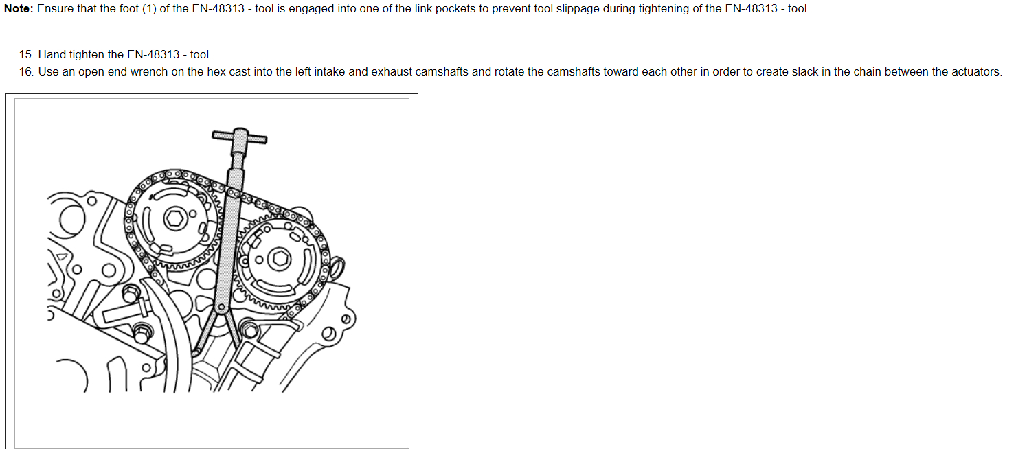

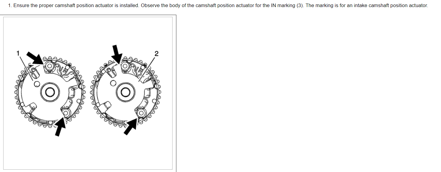

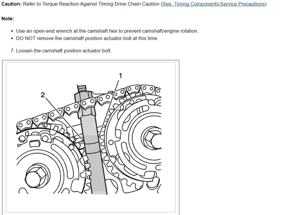

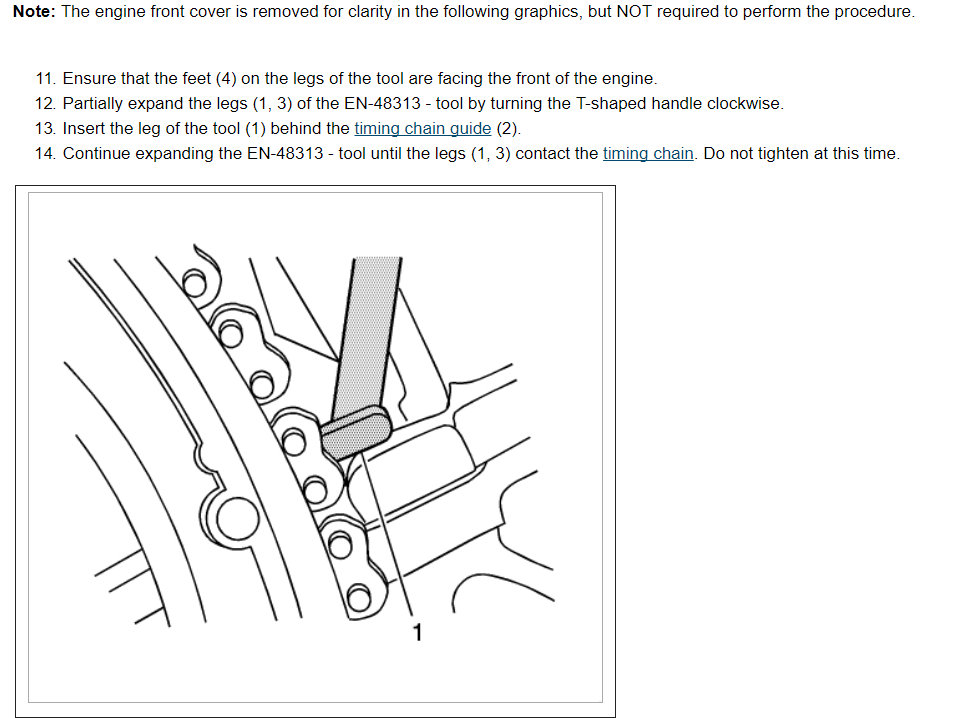

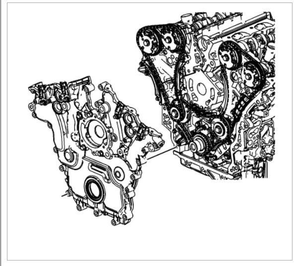

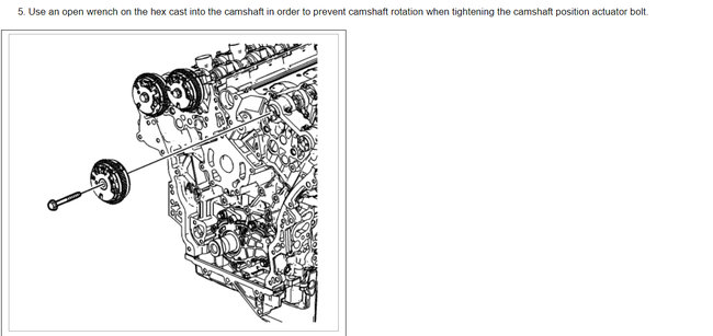

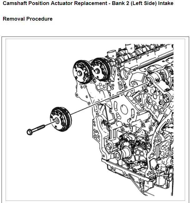

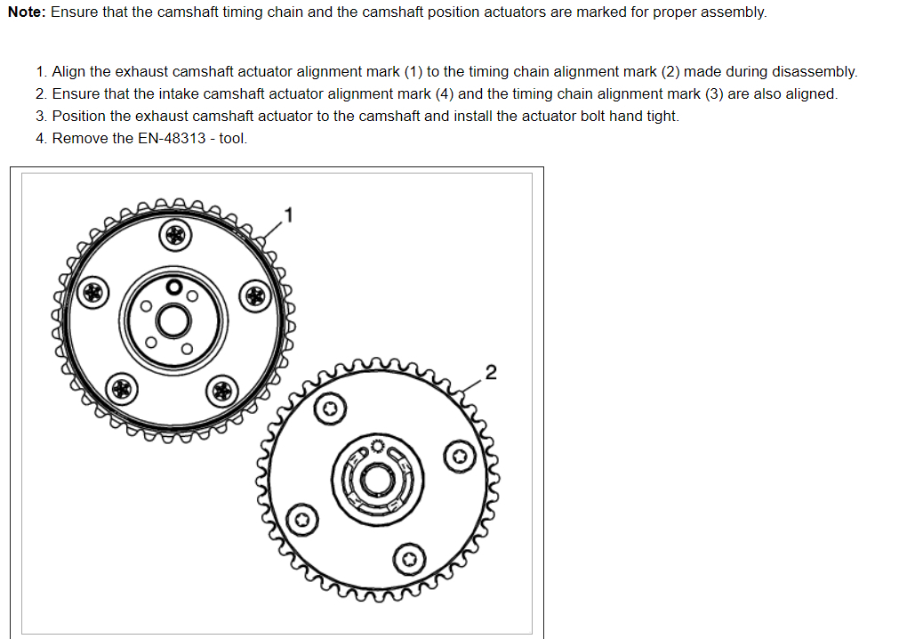

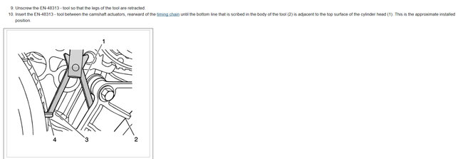

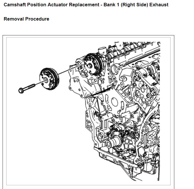

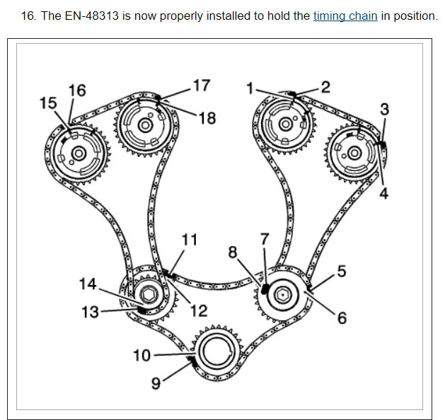

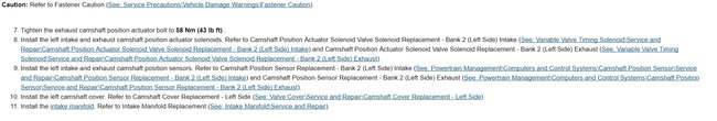

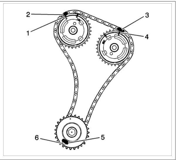

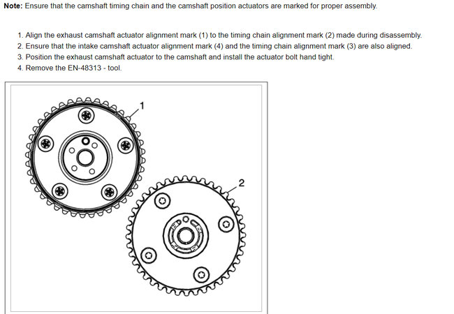

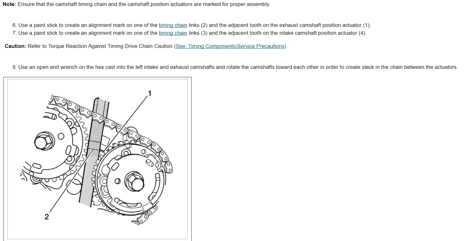

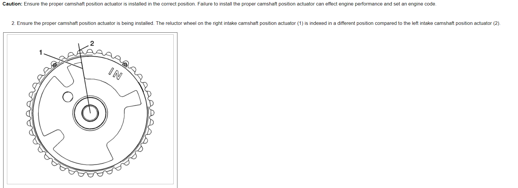

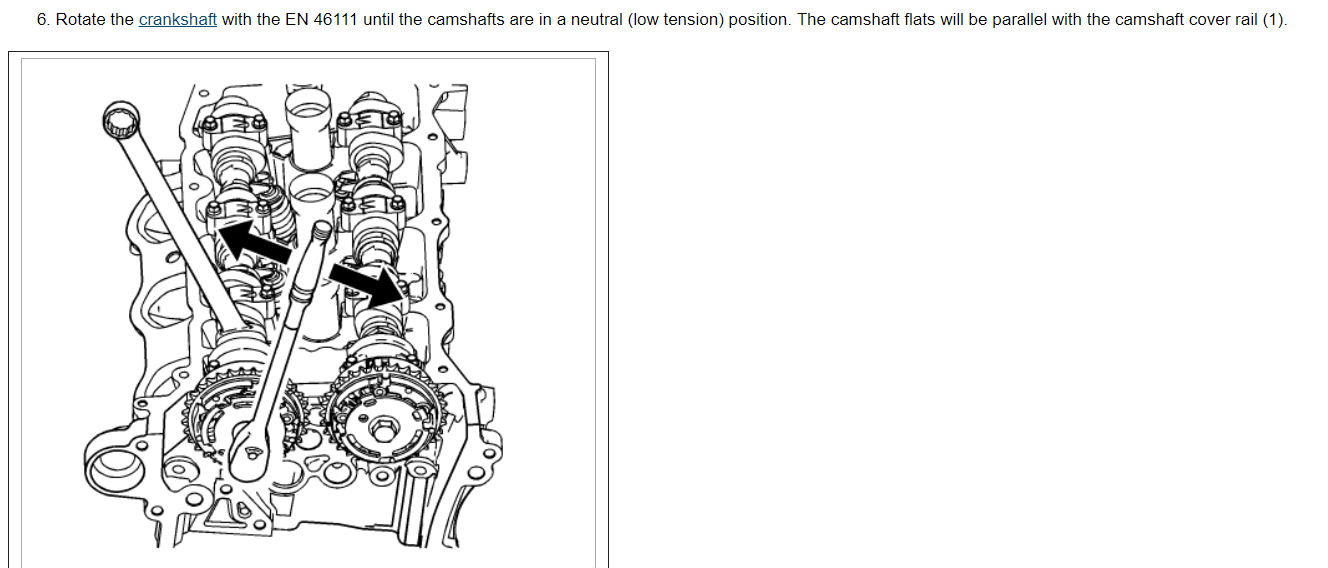

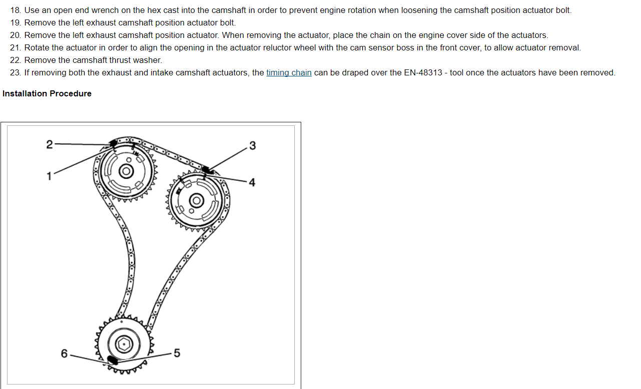

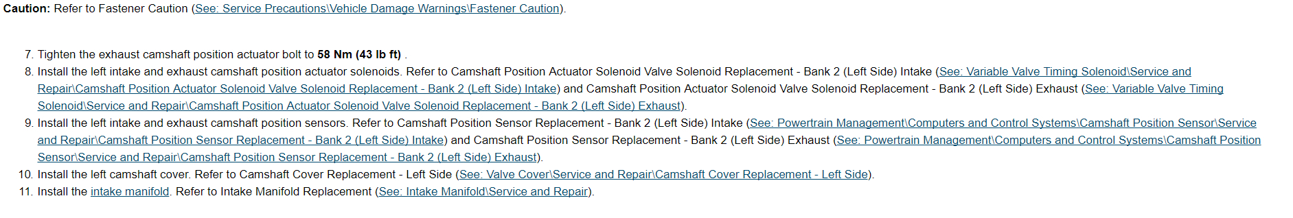

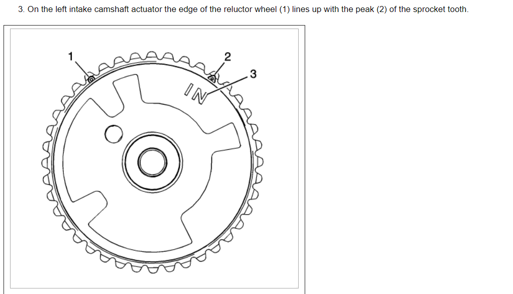

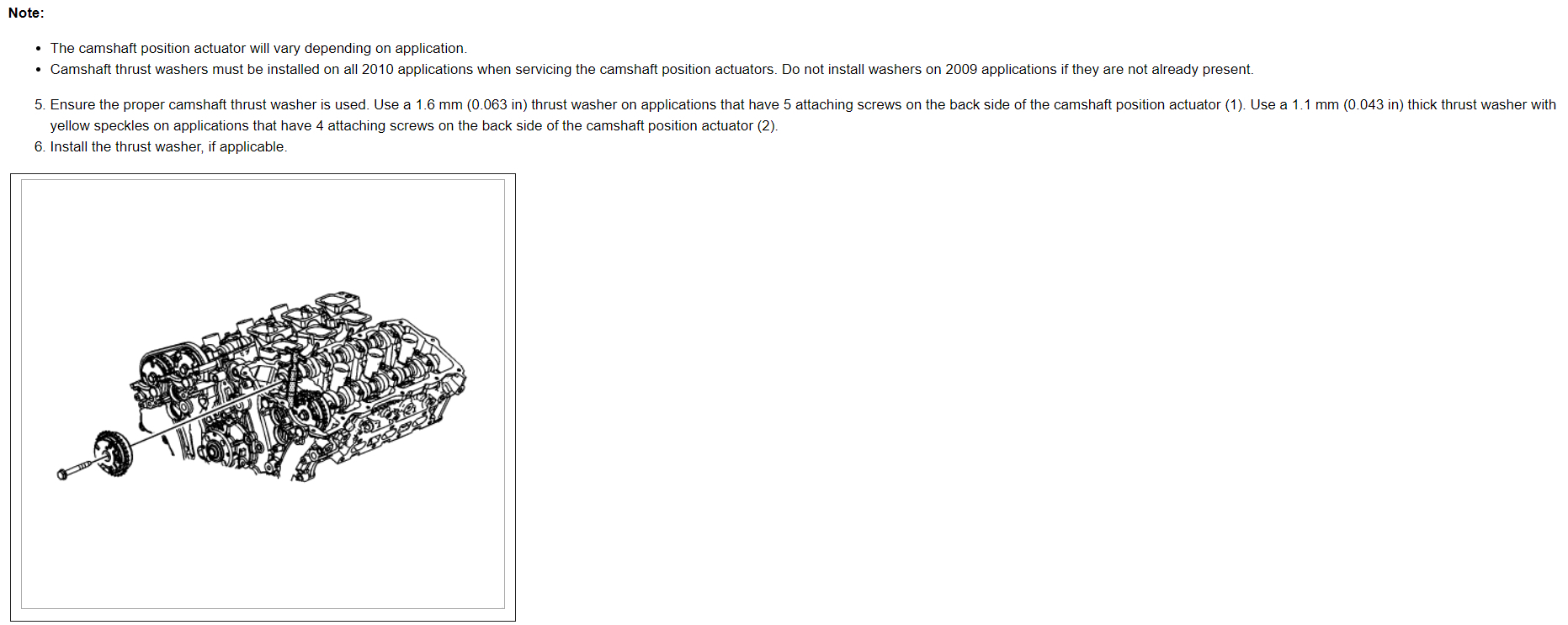

It sounds like you have a camshaft actuator/timing chain issue with the engine which is common. Below are diagrams on how to do the job.
You will need to pull the balancer here is a guide:
https://www.2carpros.com/articles/how-a-harmonic-balancer-works

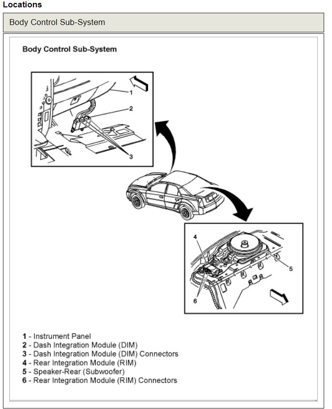

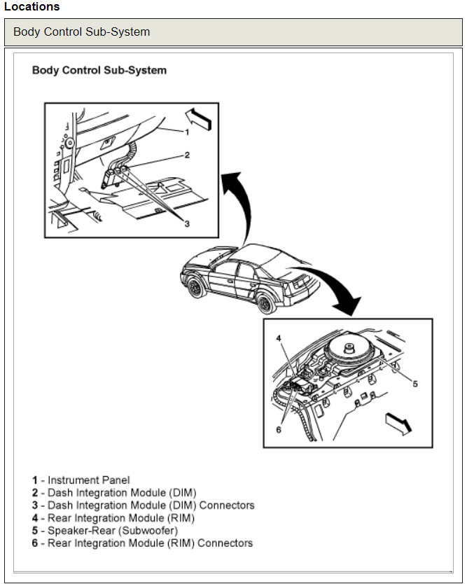

Okay, in the fuse box under the hood of my car is a i believe a black and yellow wire. You touch that wire and just put it on anything to ground and the starter will turn over. But you must have the key on for it to start. But the last time i did it it would not work. So i took the battery post off and tried it, no good. Then the fan inside the would come on full blast. turned the fan off post off then back on. There goes the fan again. Post off then on turn the key use the jumper wire then it would start. The car is possessed or the computer is fried. I do not know. I am going to do a leak down test today and if that is good I am going to see if the injectors are getting fire then the brain box. Then who knows?
Jan 7, 2018 at 1:47 PM
  • 55,732 POSTS
It sounds like a BCM issue which contains the security system. I would have the BCM codes run to confirm the issue. If you need it replaced a shop will need to program it for you. Below is the location.
