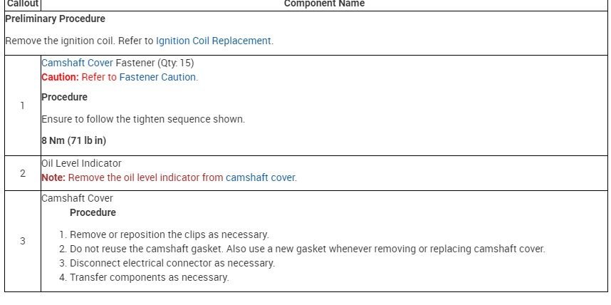

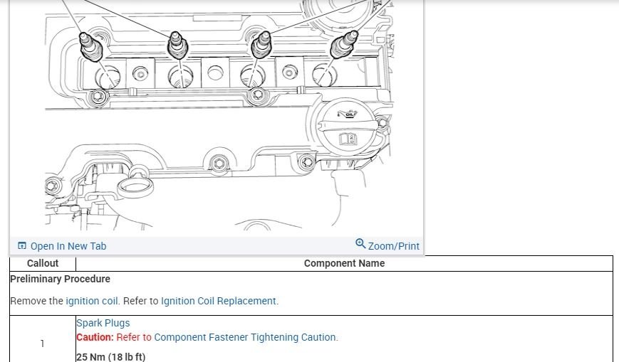

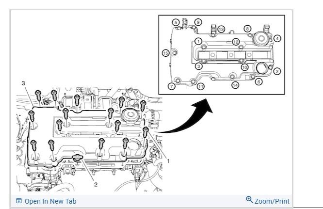

What is the torque specification on the valve cover plus spark plugs
2018 CHEVROLET TRAX
80,000 MILES • 1.4L • 4 CYL • 2WD • AUTOMATIC
TERRY GASTON
I need to replace valve cover and replace spark plugs.
Jan 2, 2020 at 8:59 AM

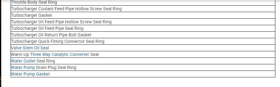

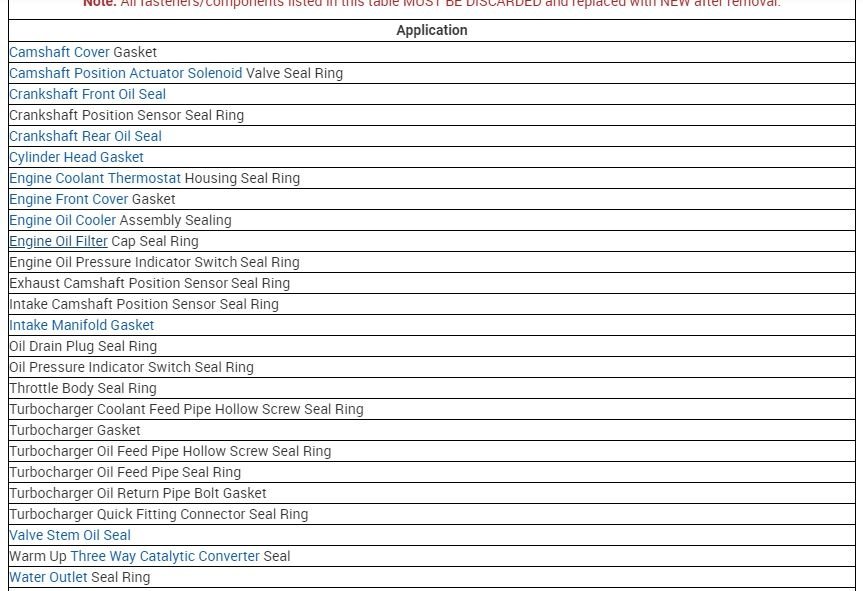

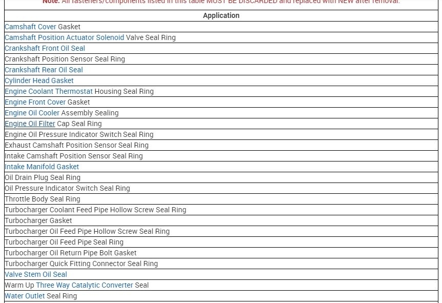

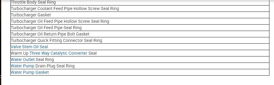

Good afternoon,
I attached all the specs for the engine as well as the plugs and valve cover below for you. Check out the diagrams (Below). Please let us know if you need anything else to get the problem fixed.
