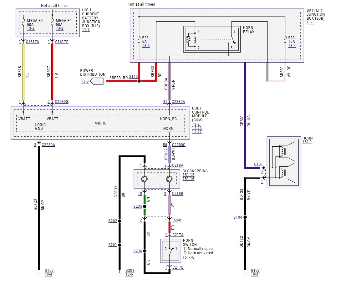

Do you guys know the name of the wire that's the next wire up from the horn and immediate horn connector on a car? Not this wire in the picture, but the one it connects to. It is one half of a Y wiring harness that comes from a large connector and splits, one end going to the horn. Thank you.

This is the horn wiring diagram for that car. Are you looking at a Black wire with yellow or gray? If so, then that is simply a ground that is shared through the splice.
Any image you sent did not make it through.
