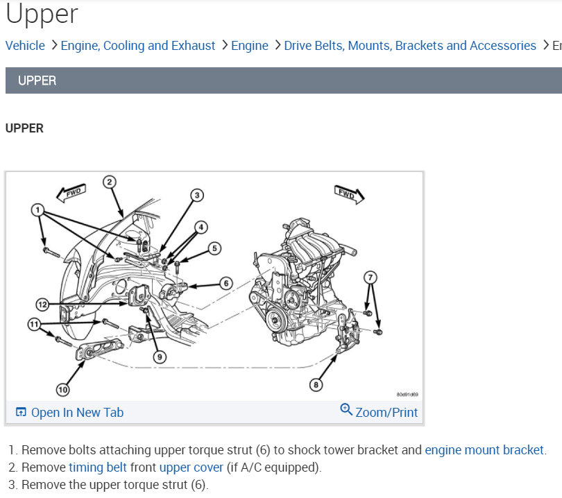

I was told that I need to replace the Torque Strut Mounts and Transmission Mounts for my car listed above. I found and purchased a kit that has four parts - Front Right Lower Motor Mount, Front Right Upper Motor Mount, Rear Motor Mount, and Automatic Transmission Mount.
When I do a search for the Torque Strut Mount, it looks like the parts that I just bought.
Help!

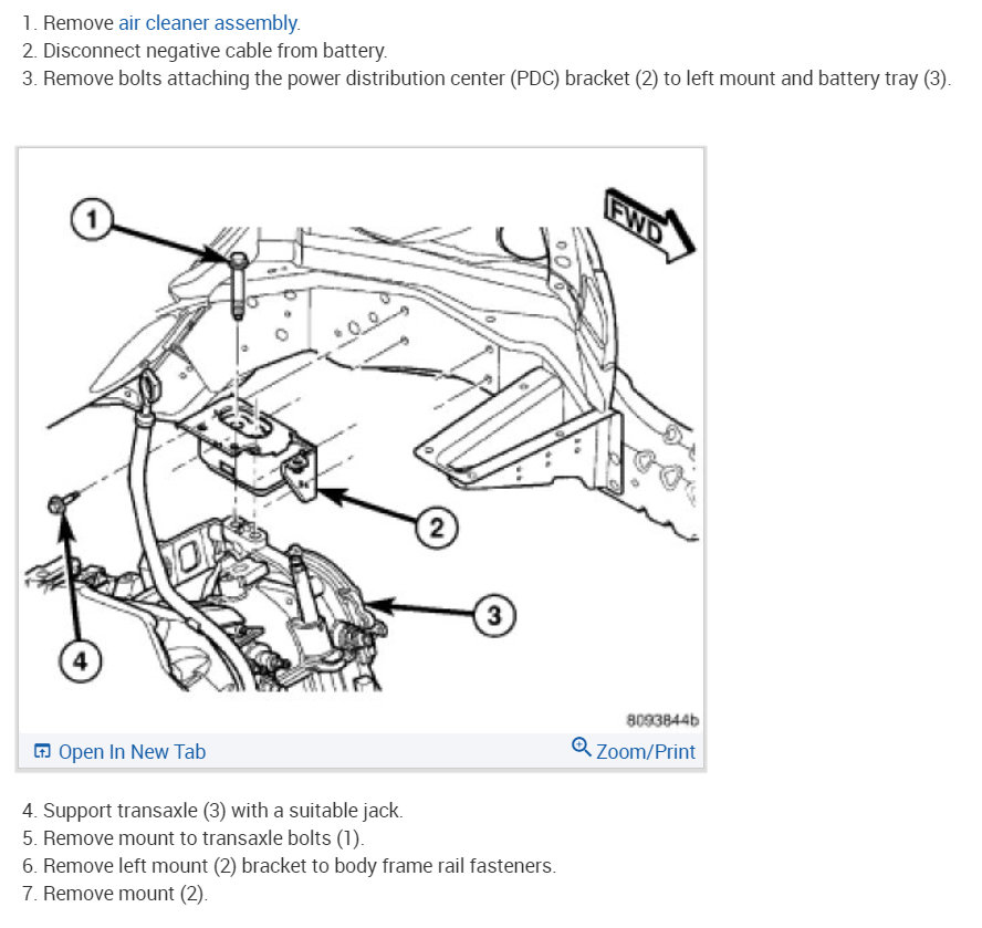

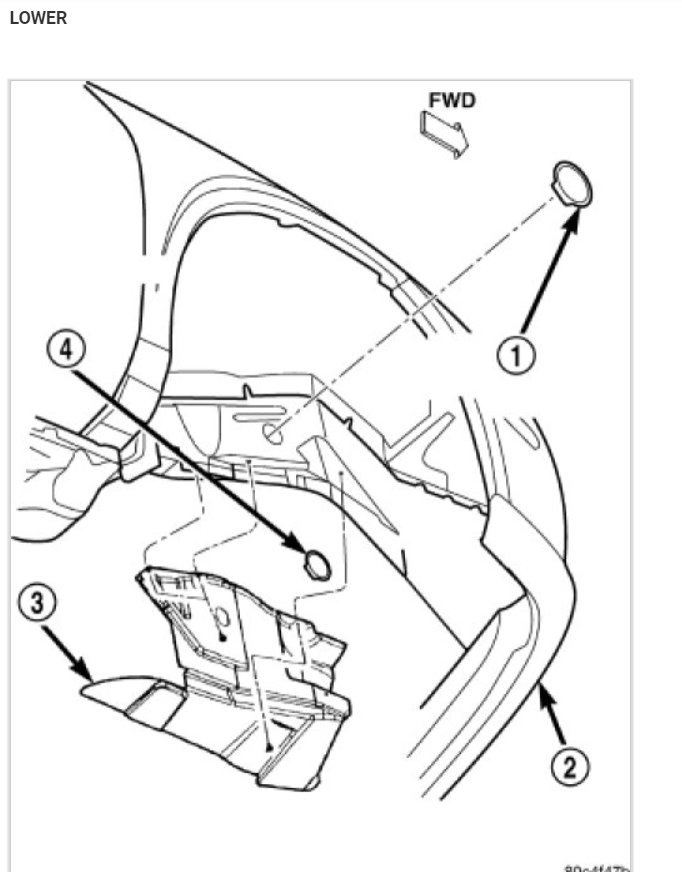

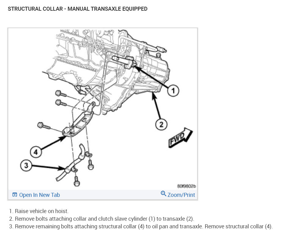

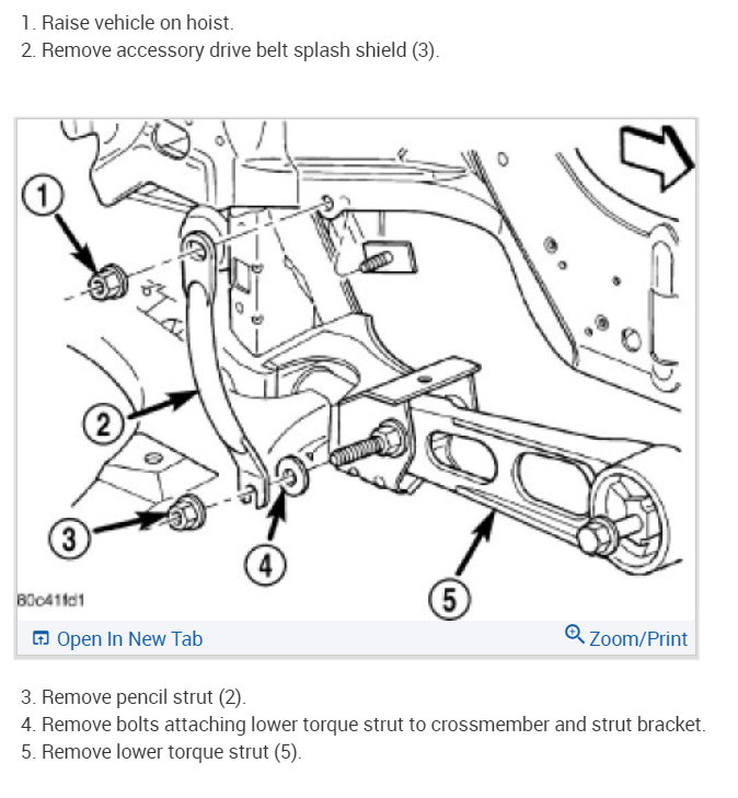

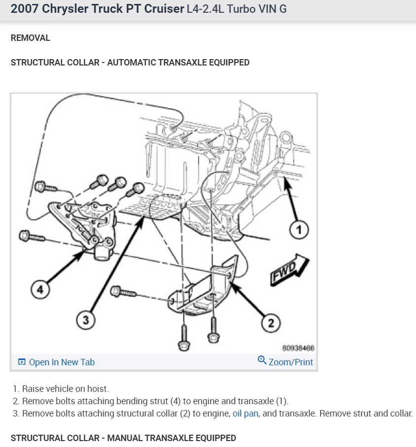

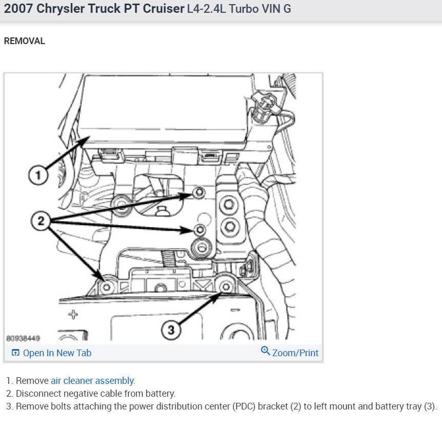

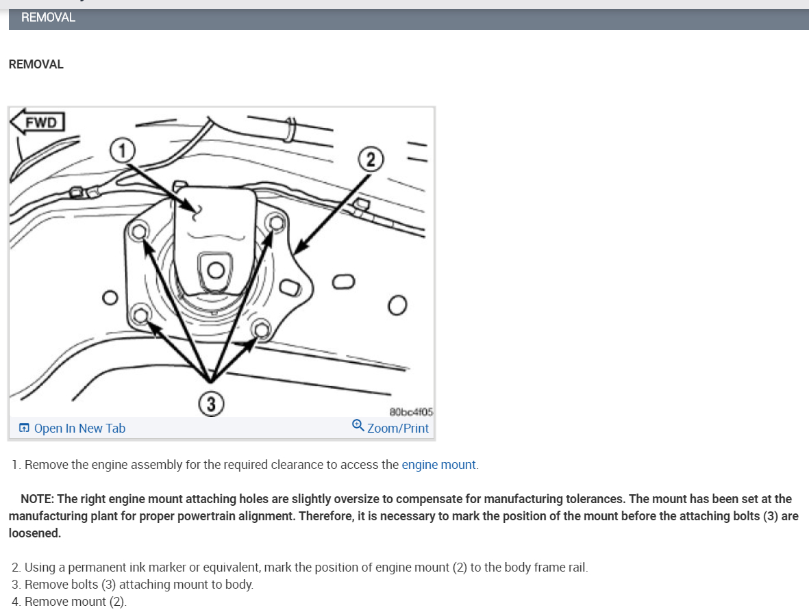

Here is a video that shows the torque mount being replaced with diagrams below to show you all of the engine mounts and how to replace them:
https://youtu.be/mFDRuoF4NWk
