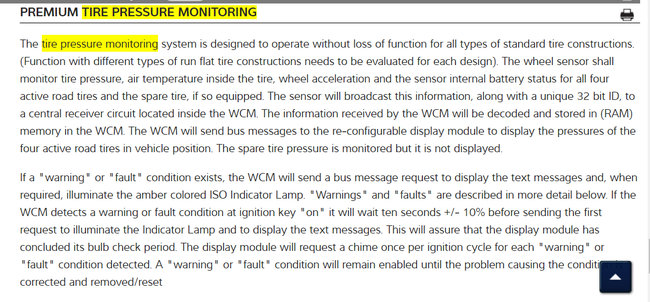

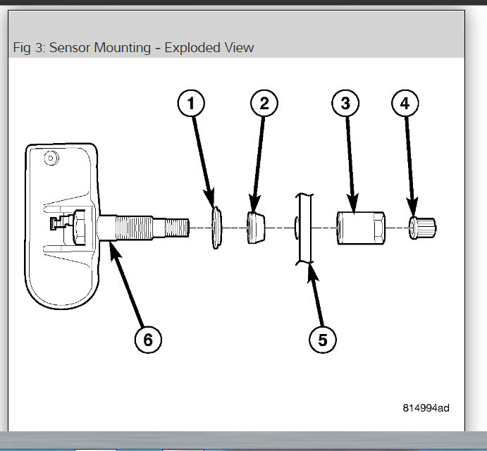

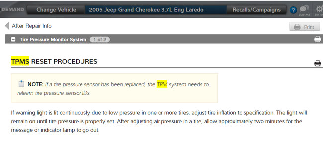

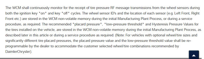

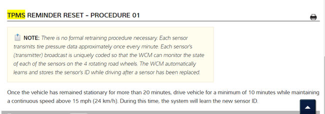

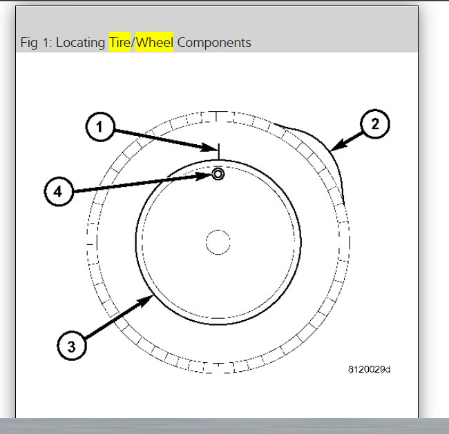

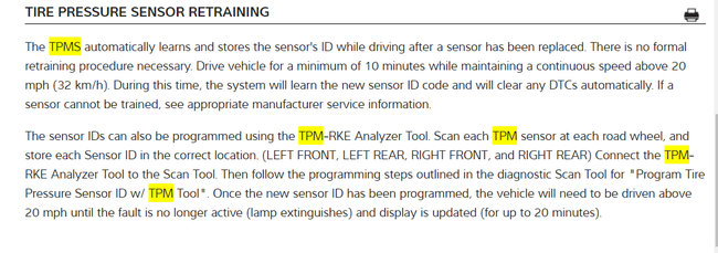

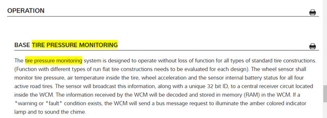

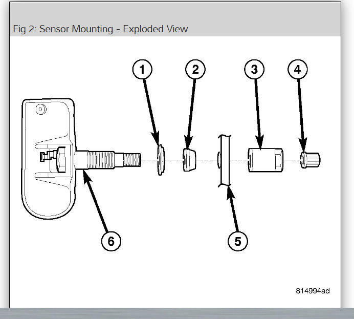

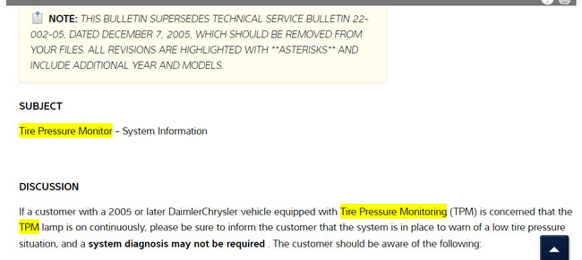

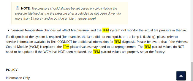

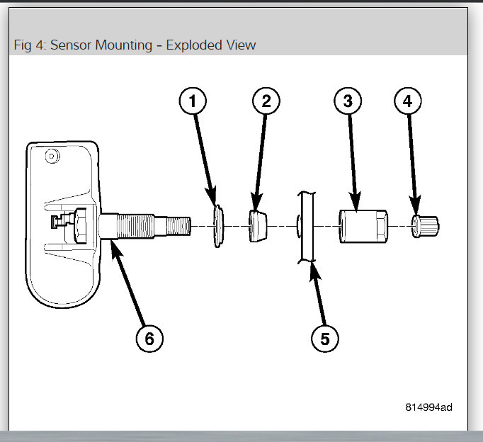

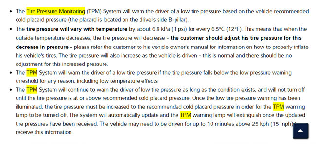

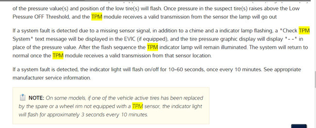

Hello, can some one please tell me about tire pressure sensors on the vehicle listed above? I am not able to know how it is numbered. I have to relearn sensors on scanner. I have no idea in which tire should I start. it is complicated process, appreciate.

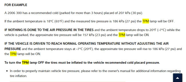

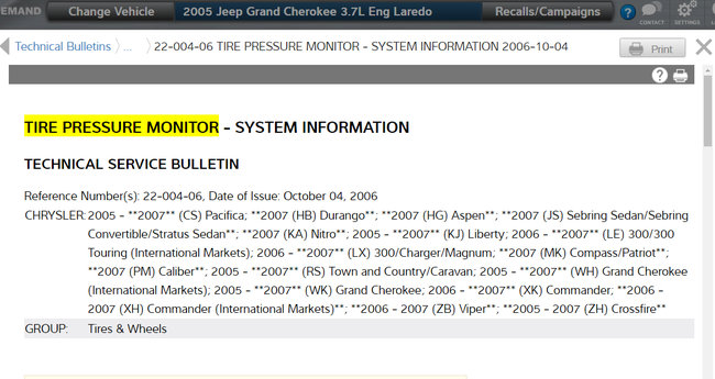

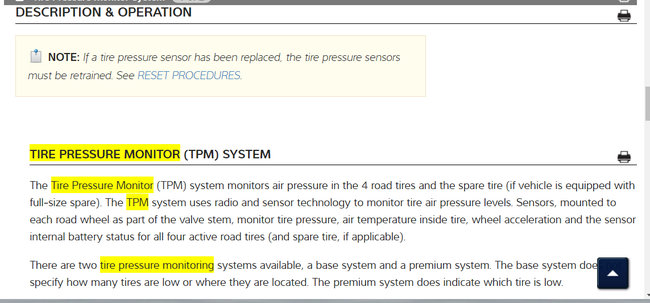

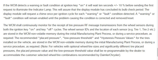

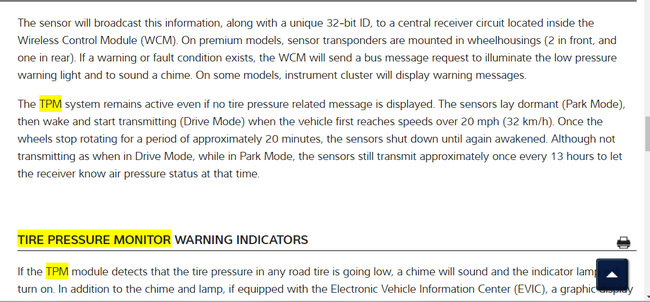

I have included all the information that you requested in the diagrams down below. I have included a description of how the Tire Pressure Monitoring System (TPMS) works on your vehicle, location of system, and the relearn procedure from the factory. Please go through these guides and get back to us with how everything goes for you.
Thanks,
Alex

Hello again,
This is all the information that we have in our reference for the TPMS on this vehicle. Is your Malfunction Indicator Lamp[MIL] or "check engine" lamp illuminated?
Thanks,
Alex
2CarPros
