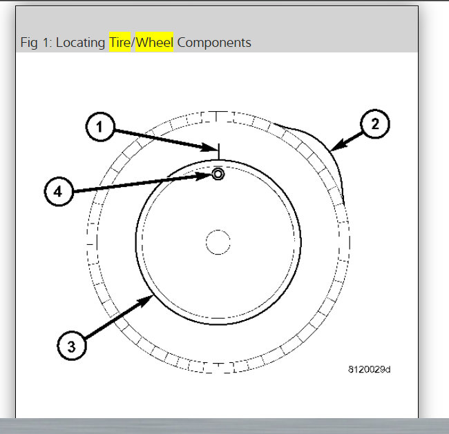

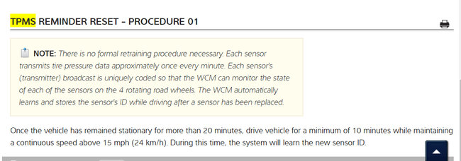

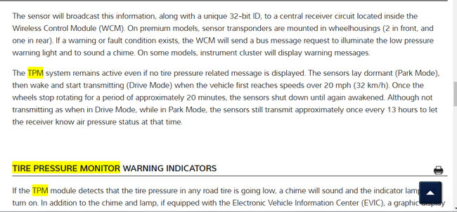

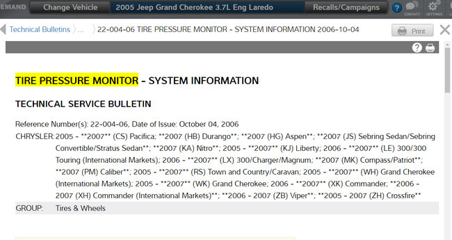

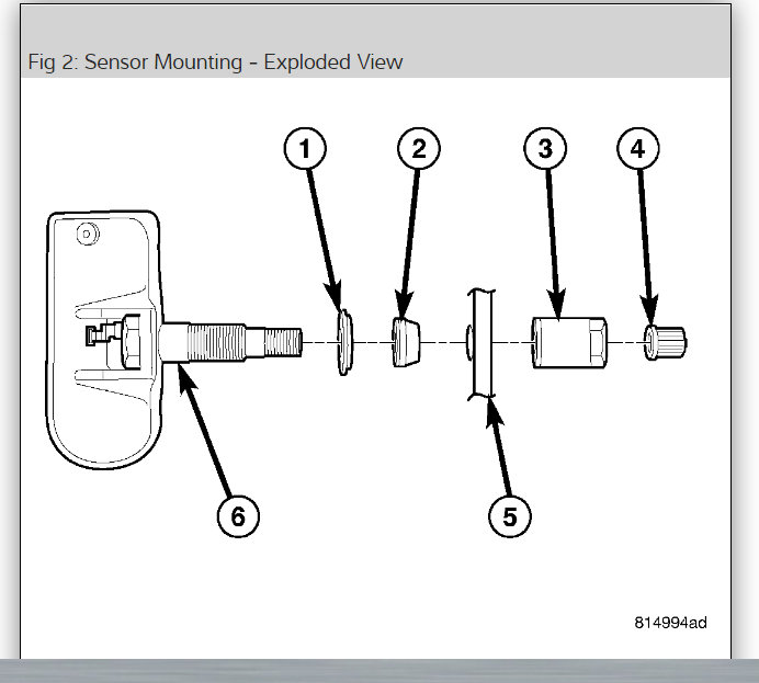

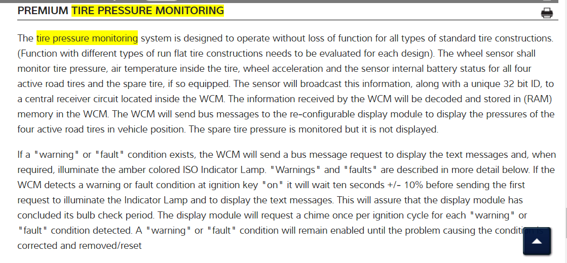

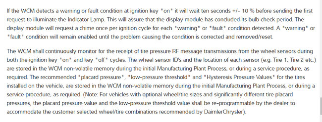

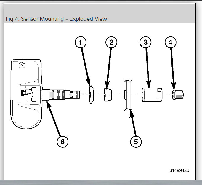

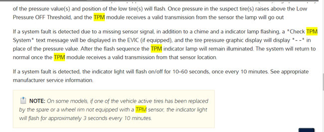

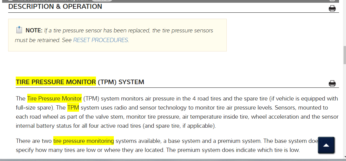

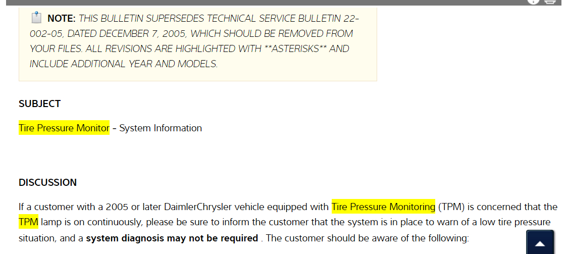

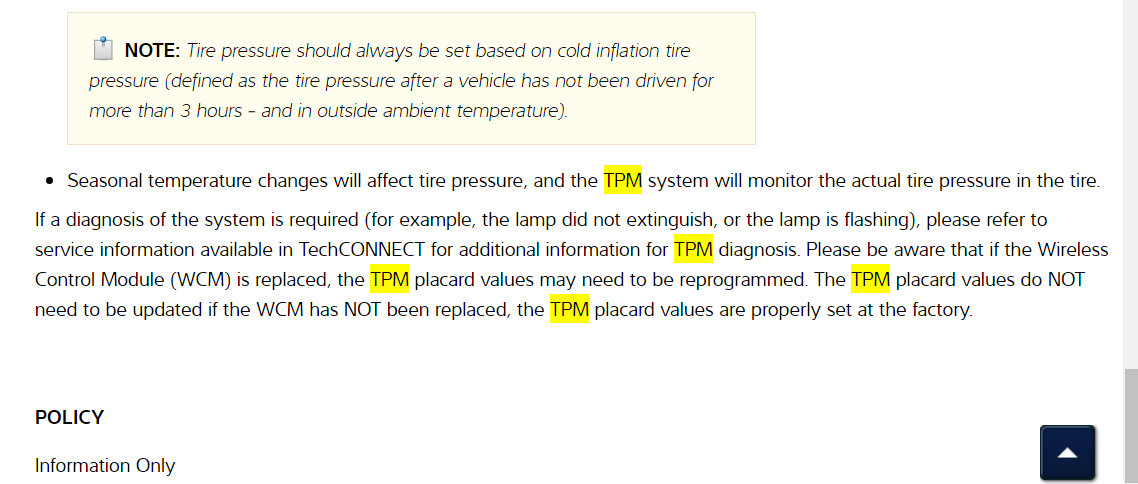

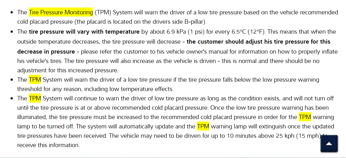

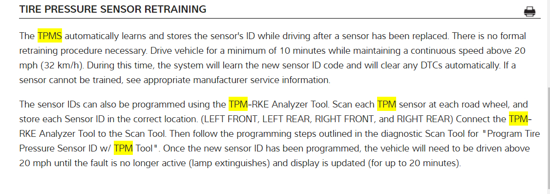

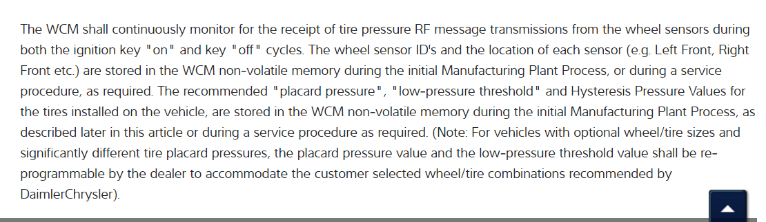

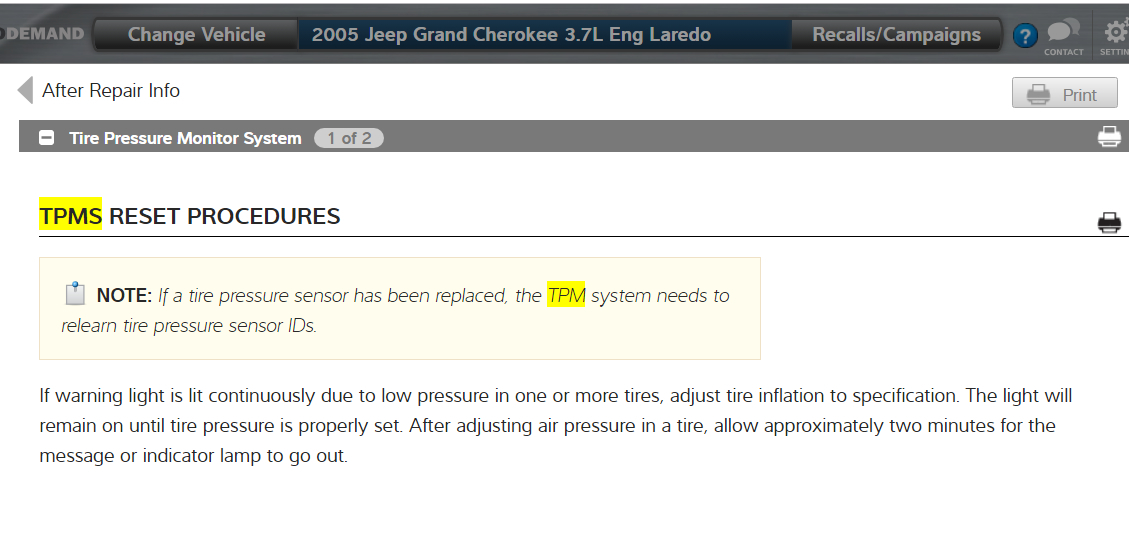

Hello, can some one please tell me about tire pressure sensors on the vehicle listed above? I am not able to know how it is numbered. I have to relearn sensors on scanner. I have no idea in which tire should I start. it is complicated process, appreciate.
May 2, 2019 at 6:45 AM
SCGRANTURISMO
  • 4,897 POSTS

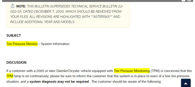

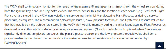

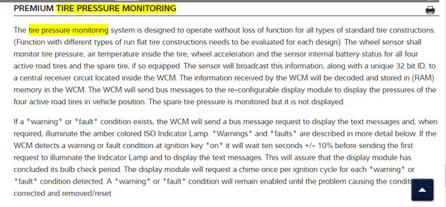

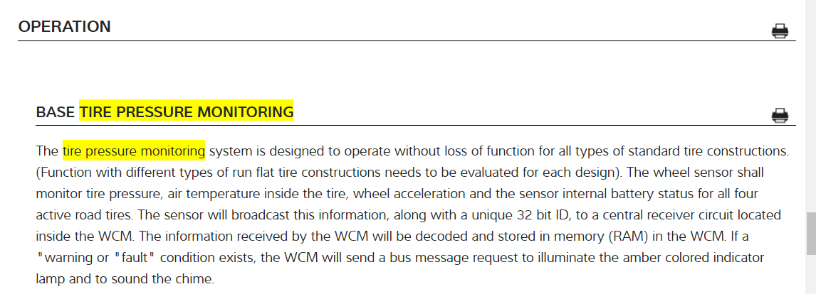

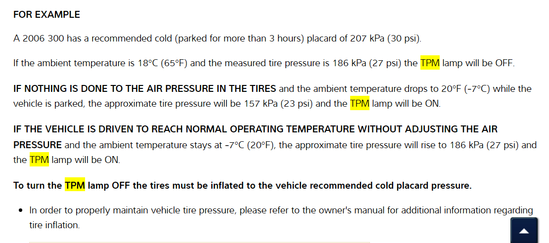

I have included all the information that you requested in the diagrams down below. I have included a description of how the Tire Pressure Monitoring System (TPMS) works on your vehicle, location of system, and the relearn procedure from the factory. Please go through these guides and get back to us with how everything goes for you.
Thanks,
Alex
2Carpros
May 2, 2019 at 7:28 AM

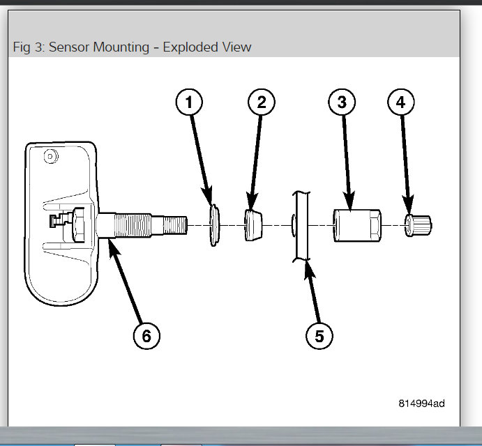

SCGRANTURISMO that saves us time looking for these info. We need a reference as well for TPMS checking of this F150 which was garaged kept after involving in an accident. We're waiting for the parts from 4WheelOnline to arrive and installed on it. It's been sitting for 5 years and the owner lost it's papers.

Hello again,
This is all the information that we have in our reference for the TPMS on this vehicle. Is your Malfunction Indicator Lamp[MIL] or "check engine" lamp illuminated?
