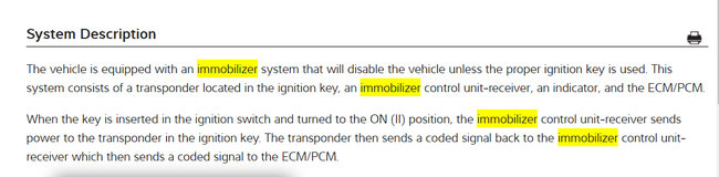

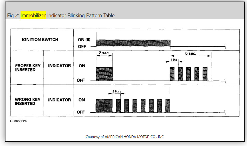

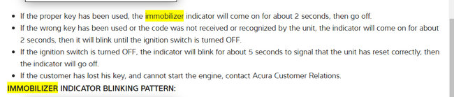

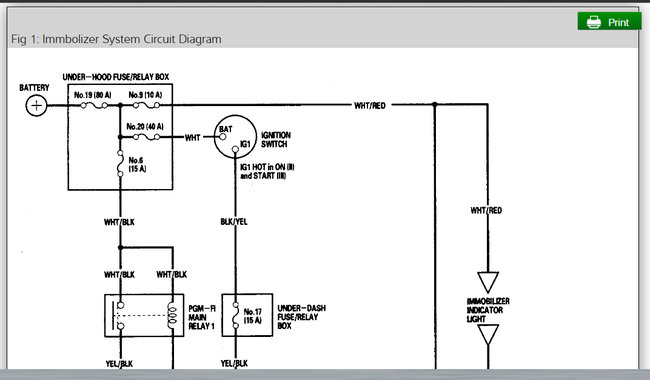

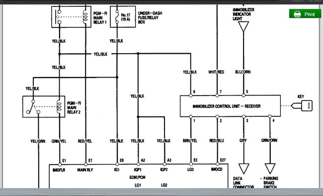

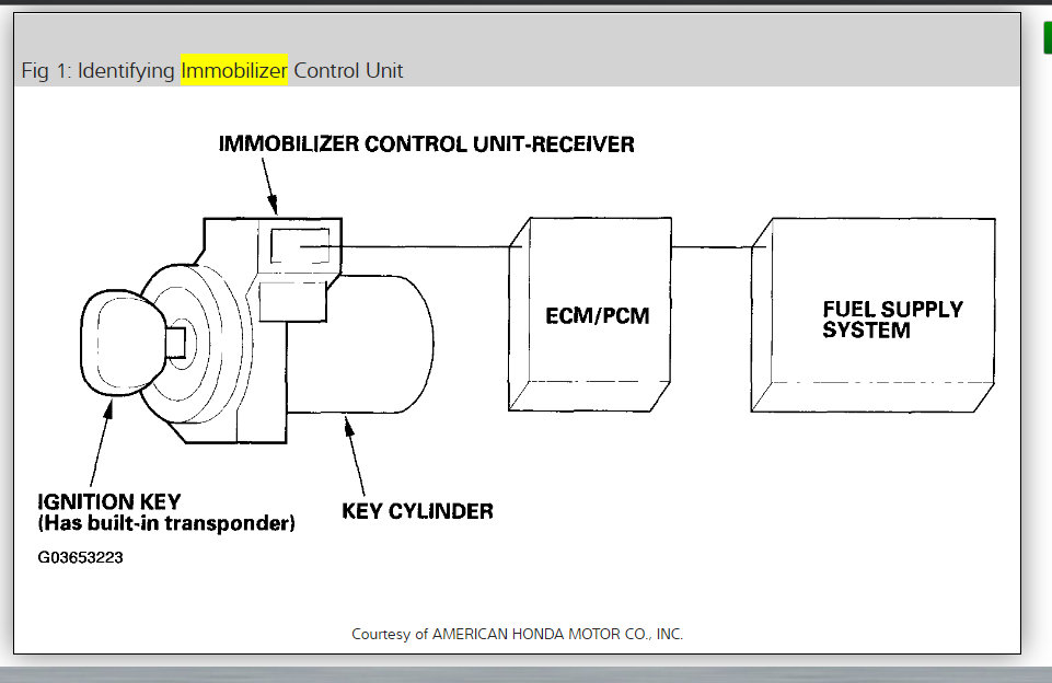

This could be a problem with the immobilizer ignition system. I have included a description of the immobilizer's operation. Troubleshooting the system though requires a Honda Scan tool called a HDS, so I didn't include any factory troubleshooting guide along with everything else. Please go through the information and get back to us with what you decide to do or if we can help in any other way.
