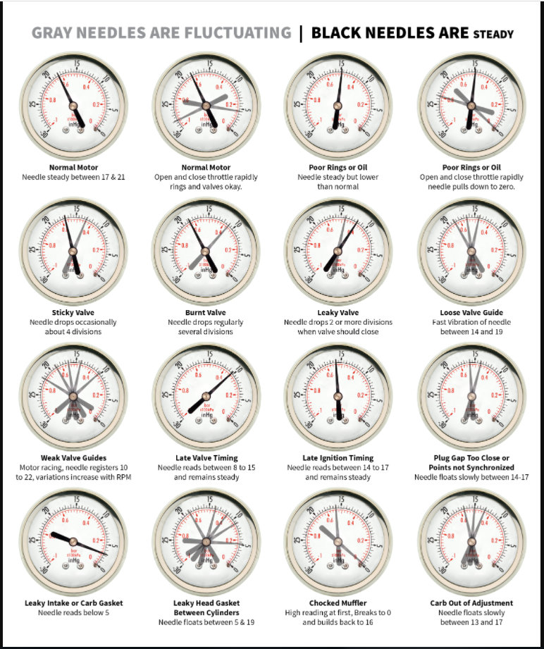

Also, below is a chart that will help with vacuum gauge readings but if you can get a video of the gauge, that will as well.
Let us know what questions you have on this. Thanks

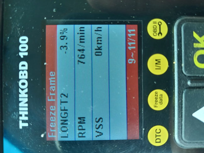

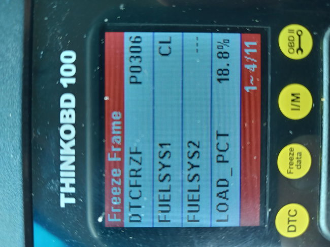

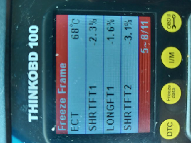

AROBTAYLOR
  • 10 POSTS
Here are the vacuum test results and freeze frame data.
May 5, 2021 at 4:58 AM
No issues with vacuum. Short term is slightly rich but that would not effect just cylinder 6.

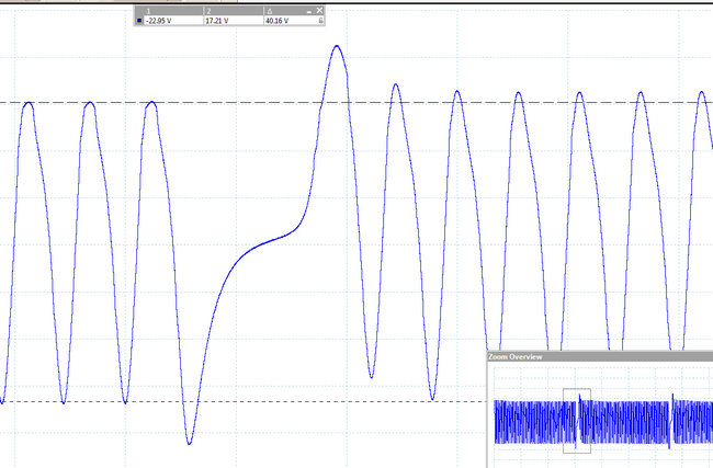

Totally forgot that this engine has an inductive crank sensor not a hall effect, so it gives this type of pattern, like an AC circuit, and not a square wave.
I attached below a known good pattern so I think the scaling on your tools is wrong as it should be a 12 volt scale but that is a good pattern.
At this point, everything in the base engine operation that would cause a misfire appears to be checking out.
So did the misfire happen after the balancer issue or was it there prior?

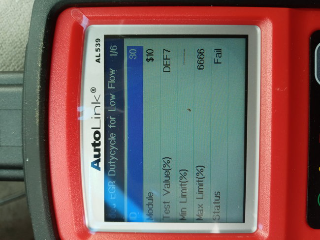

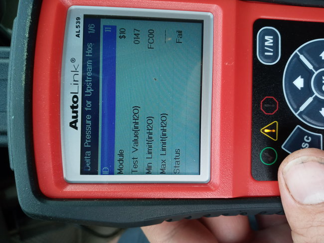

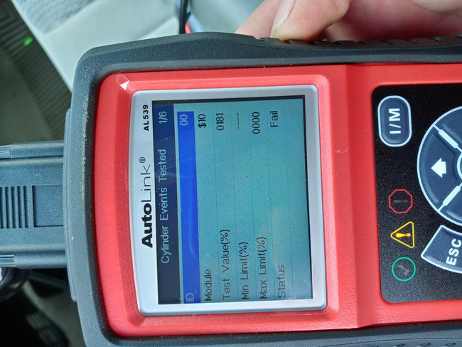

AROBTAYLOR
  • 10 POSTS
Here are the failed monitors that I found on the scan tool. I haven't tested the injectors yet.

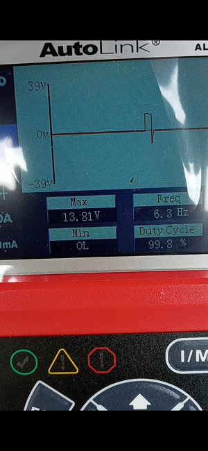

AROBTAYLOR
  • 10 POSTS
Fuel injector waveform.
May 8, 2021 at 11:06 AM
The lower voltage would not cause this on a single cylinder. I suspect that is just what the scan tool displays it as and it is not actually 6 volts. This is not uncommon on these scan tool to have scaling inaccuracies.
Can you feel the misfire? Meaning does it run poorly? Sounds like it is just setting the code because you are unplugging the injector and then you feel it misfire.
So if it doesn't feel like it is missing then we may have an o2 sensor issue.
The Delta for upstream o2 sensor monitor is interesting.
What are the o2 sensor voltages? The scan tool should have that and they should be between 0 and .9 volts.

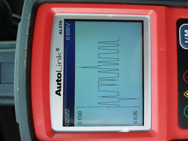

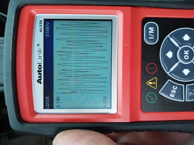

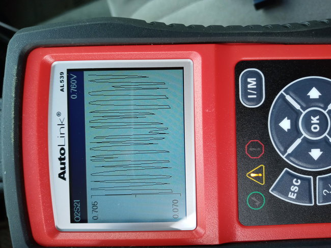

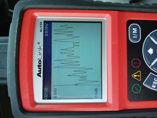

AROBTAYLOR
  • 10 POSTS
The engine has a slight shake. I don't believe it's a dead misfire.
I see what you're saying about the code. I have reset the code or unplugged the battery after any change or swap in parts. The code will return without any tampering.
Attached are the o2 readings.
May 10, 2021 at 3:02 AM
So cylinder 6 should be driver side second one back on this engine so that makes this bank 2. Bank 2 upstream is showing an average of .76 volts.
Bank 1 is showing .59 volts which is where this should be. It needs to be close to the middle as the lower voltage is lean and the higher close to .8 is rich.
I would swap the o2 sensors side to side and see if bank 2 remains rich or the misfire move cylinders.
Clear the codes and then drive and watch the bank 2 upstream sensor and see if it is still reading rich.
