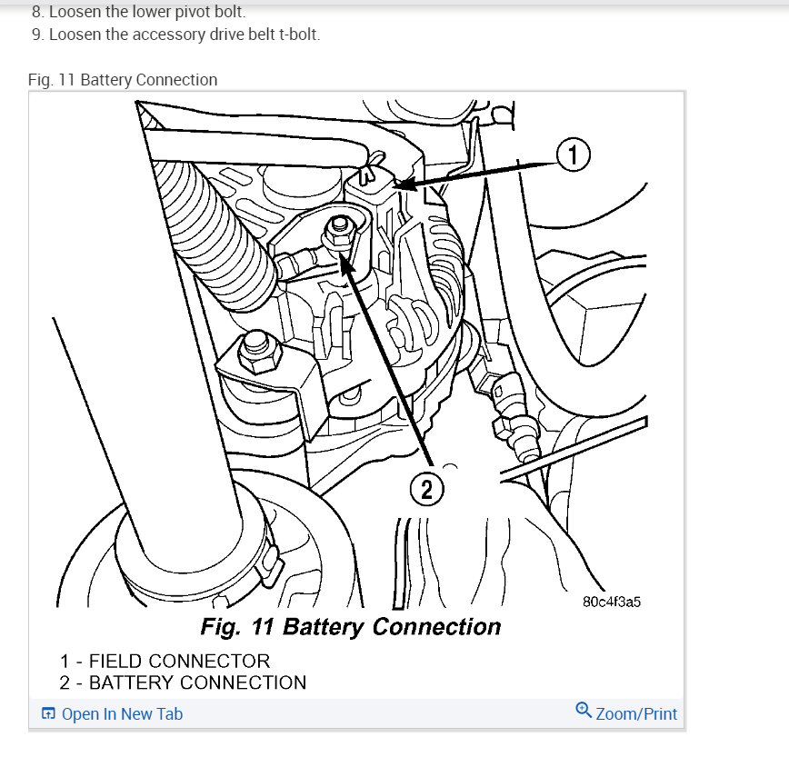

I have a bad alternator on the vehicle listed above that I recently purchased. I can't really afford what a new alternator is going for and I am having difficulty locating a used one locally that came from a 2003. Just curious if there is another model year that would work?

it is hard to say if the part numbers are correct, they will interchange, they have some pretty inexpensive units on Amazon $116.00.
https://amzn.to/3i2DdG1

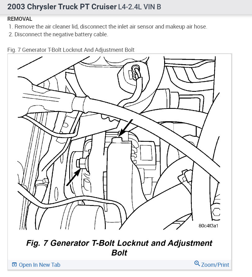

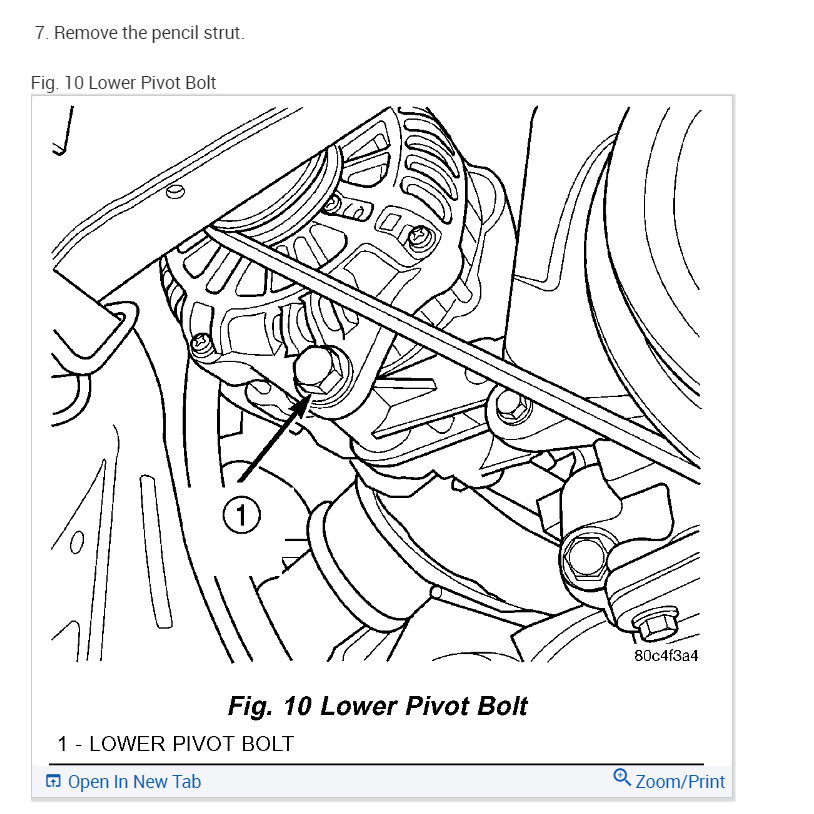

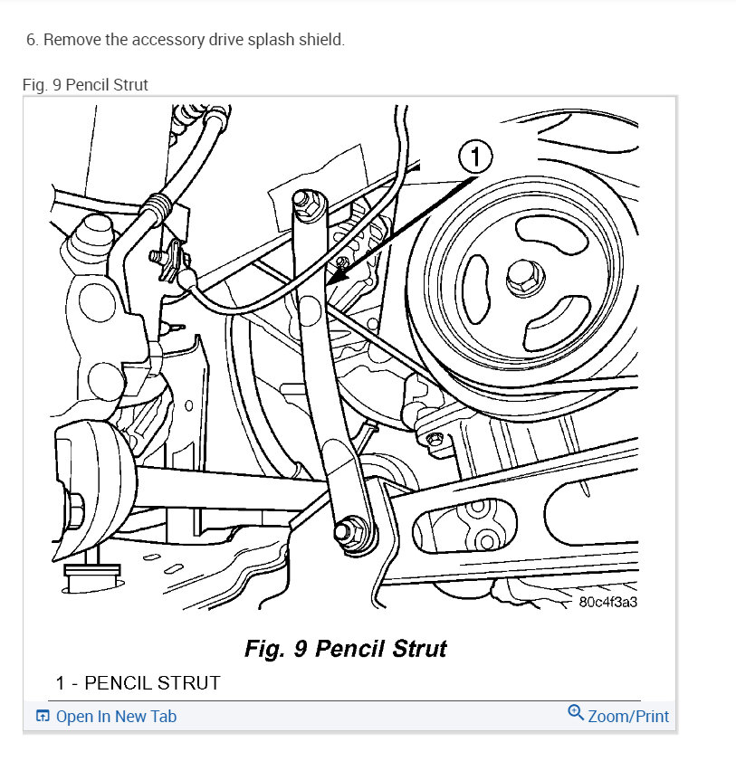

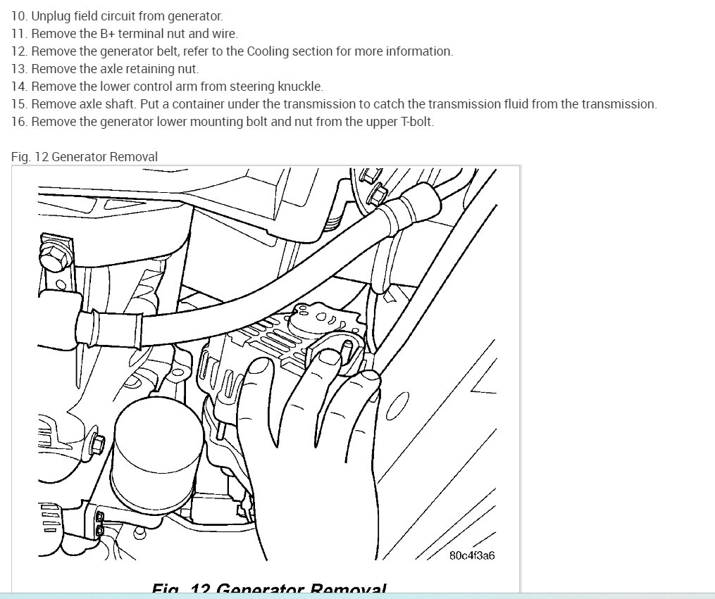

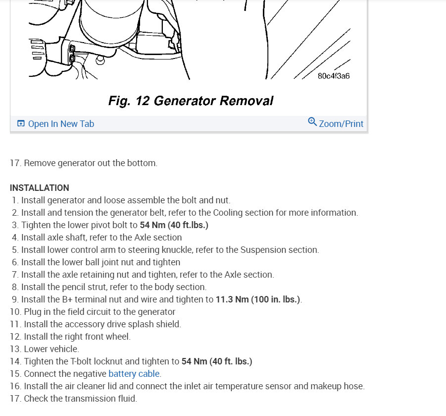

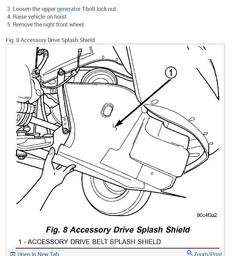

Here is how to change the unit out in the images below with a generic guide to help walk you through the steps:
https://www.2carpros.com/articles/how-to-replace-an-alternator
Disconnect the battery first. Check out the images (below). Please let us know if you need anything else to get the problem fixed.
