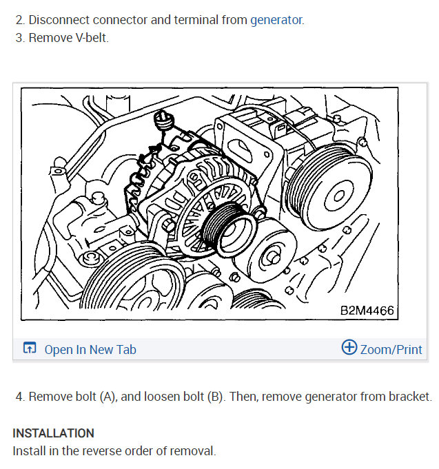

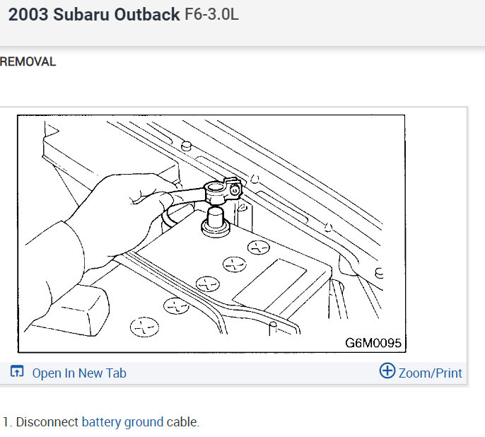

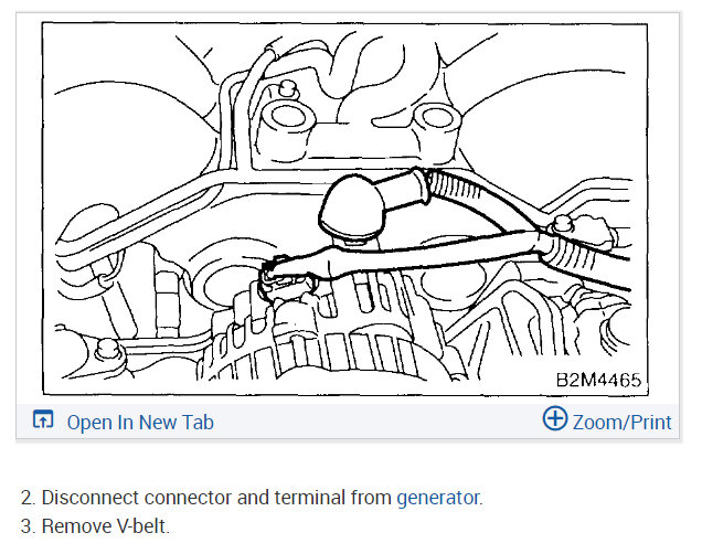

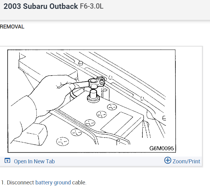

This could be the battery or alternator, I would remove the battery and take it to the auto parts store for testing and once the car is running again test the alternator using this guide:
Here is how to change the alternator out in case you need it. Check out the images (below). Please upload pictures or videos in your response of any problems so we can see what to help you with.
