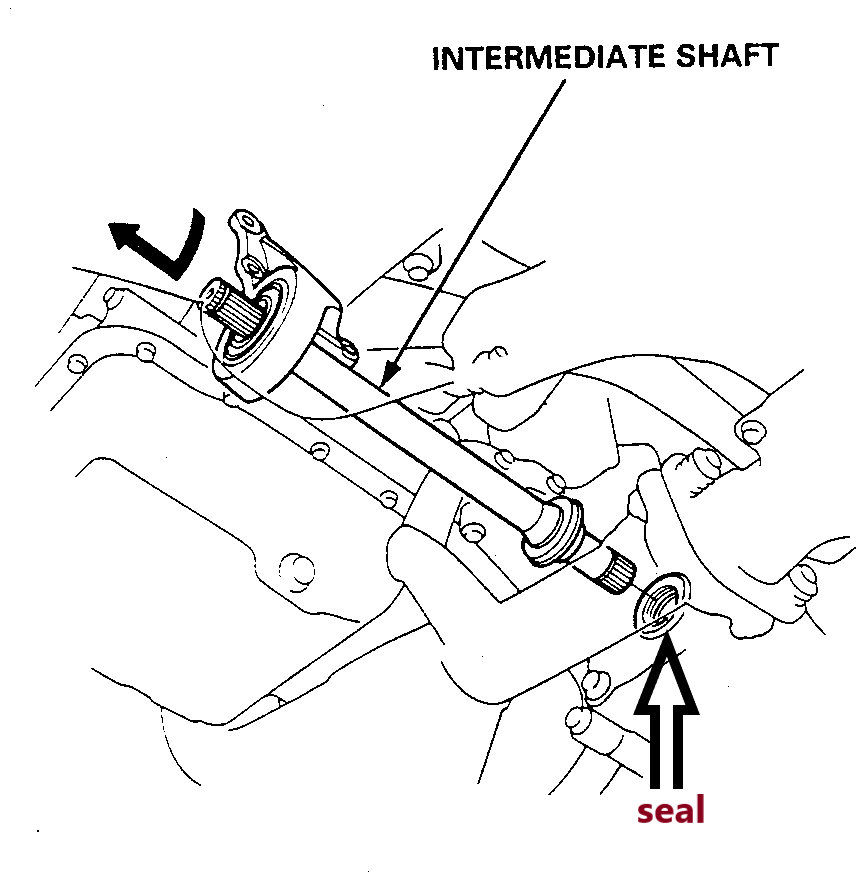

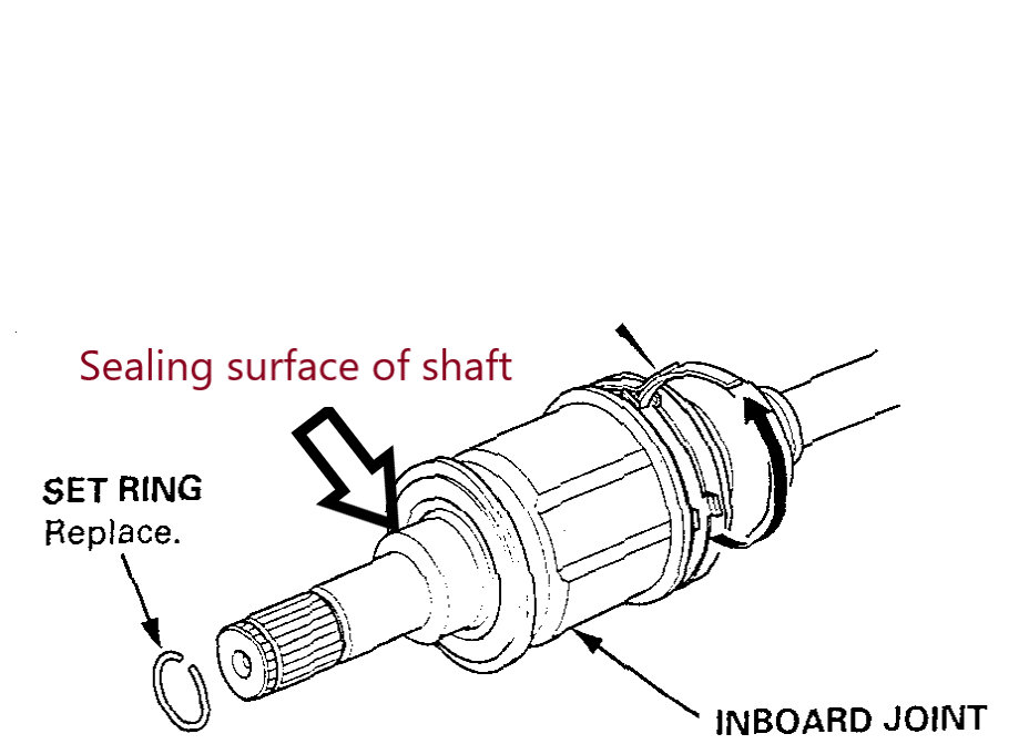

The only correlation that CV axles and the transmission have in common is where they meet, where the axles slide in to the transmission through seals. If the wrong axles are installed it would be possible that these seals are damaged or don't seal properly due to size difference of the axle shaft sealing surface in particular. If it did not seal correctly, transmission fluid can leak out and then you have a transmission running low on fluid which can cause catastrophic failure. This is just a possibility and I was not there to see this so I cannot guarantee that this is what happened, just telling you what I've seen happen before. I would ask them what the difference was and was.
