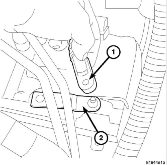

It sounds like the shift cable has come of the selector arm. Here is what I am talking about, also do the shift lights change when toy move the selector? This is on top of the transmission. Check out the images (below). Let us know how it goes.
