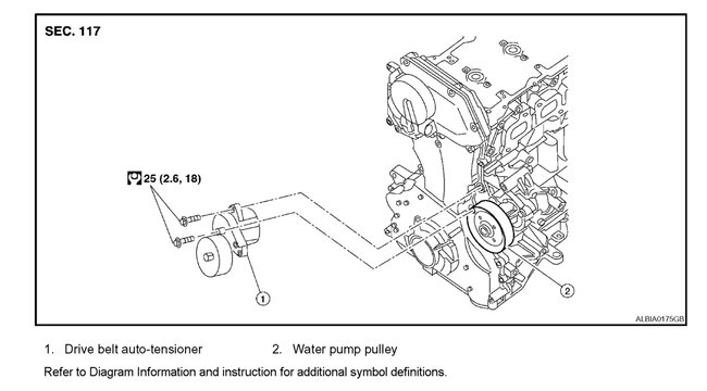

My car's power steering assist fails when i rev over 4,000 RPMs.
Sometimes it returns quickly and sometimes i will come back to my car later and will still be difficult to turn the steering wheel.
What part(s) should i check that can possibly be the culprit ?
Apr 14, 2021 at 5:19 PM
Good morning,

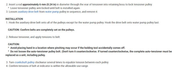

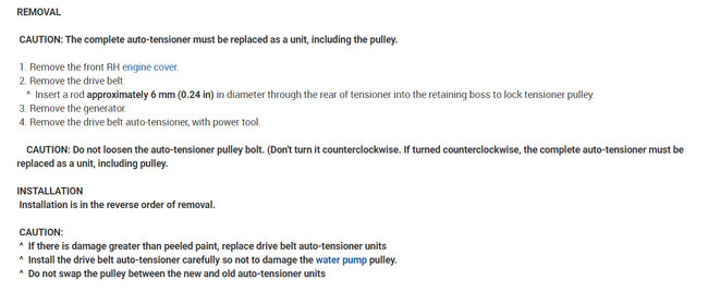

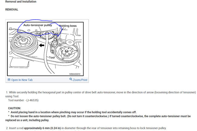

This could be the drive belt slipping when the RPM is high. At that point, the tensioner is not keeping the belt tight.
https://www.2carpros.com/articles/power-steering-problems
I attached the instructions for the belt and the tensioner.
https://www.2carpros.com/articles/serpentine-belt-tensioner-replacement
