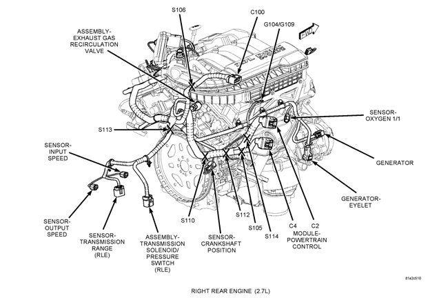

I have had my car for three months and for the past month and a half it has been randomly shutting off on me without warning with no warning lights. It seems to only happen after I go over 30 mph. I have had it out on two different computers and the only code that comes up is for a bad skim key. Car starts and runs fine normally, but there is those times I will be driving in heavy traffic and it just shuts off. I pull over put in park turn the key off wait about a minute, try to start and it just cranks until I push the gas then it starts. It will do this between three and five times, then it runs fine and I can make it home. I have had new plugs put in, and had the throttle body cleaned. I do not want to throw money I do not really have at it when no one can tell me what exactly is wrong with it. This is my daily driver that I drive my kids around in. Someone please help.

It sounds like a bad fuel pump. When the engine stalls can you still hear the fuel pump in the tank working? When the engine wont run turn the key to the on position without cranking the engine over to see if you can hear the pump. The skim codes is a security issue can you try your spare key? Does the security light flash?

Hello Ken... I can hear the fuel pump kick in when the key is turned to the on position. It always starts and idles fine, but once I start driving it will randomly die. Its done it 2 mins after I started to drive, and its done it after 20 mins... its just very random. Once it dies I have to put it in park, turn the key off wait a min then it starts right back up. Sometimes it will immediately die again 2 or 3 times, and sometimes it starts back up and runs fine. I don't have a spare key, I believe the loan company has it. I did notice a couple times that while I was driving the security light was flashing, so I pulled over shut the car off, restarted it and the light was off. I just had the throttle body cleaned and that didn't help either

This sounds like a classic crankshaft angle sensor which will not leave a code or trigger a check engine light.
Here is a guide that will walk you thought he steps and the location below.

This is sounding more like a crankshaft angle sensor when they go out they dont leave a code. I would try that first.

Okay... Thank you so much, I really appreciate all your help. I was thinking the egr valve, but this makes a little more sense. If I change that sensor and it still does it I'll let you know. Thank you again
