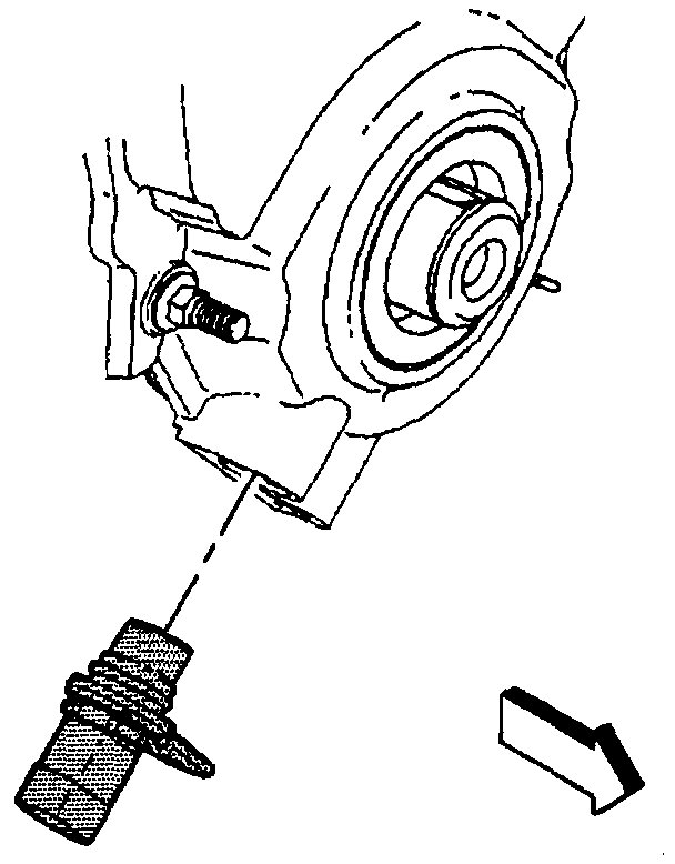

pic 1

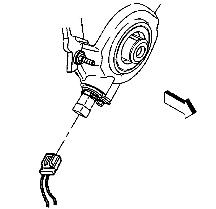

pic 2

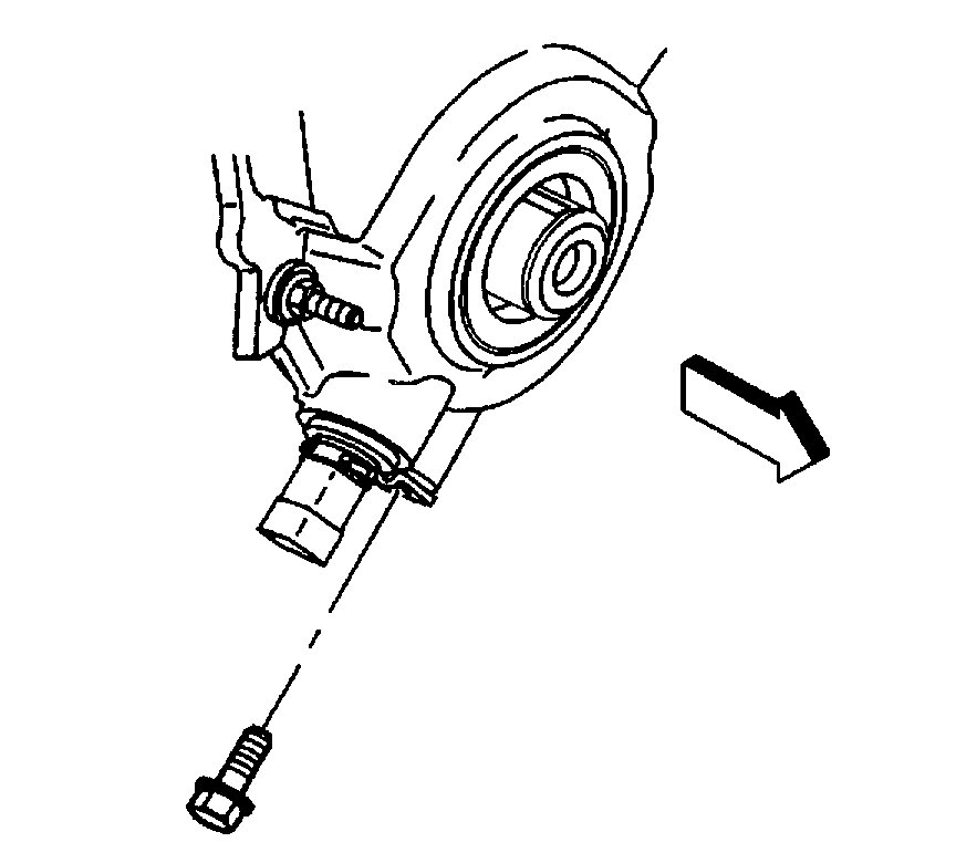

pic 3
REMOVAL PROCEDURE
1. Remove the electrical connector.
2. Remove the sensor hold down bolt.
3. Remove the sensor from the timing cover.
NOTE: When installing or removing a crankshaft position (CKP) sensor make sure the sensor is fully seated and held stationary in the front cover before torquing the hold down bolt into the front cover. A sensor which is not seated may result in erratic operation and lead to the setting of false codes.
4. Inspect the sensor O-ring for wear, cracks or leakage. Replace if necessary. Lube the new O-ring with clean engine oil before installing.
INSTALLATION PROCEDURE
NOTE: Make certain that the Crankshaft Position (CKP) sensor mounting surfaces are clean and free of burrs before installing the CKP sensor.
1. Install the sensor into the timing cover.
2. Install the sensor hold down bolt.
Tighten
^ Tighten the hold down bolt to 8 Nm (71 lb in).
3. Install the electrical connector.
