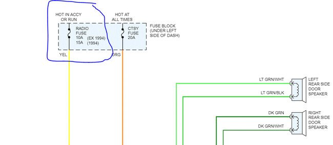

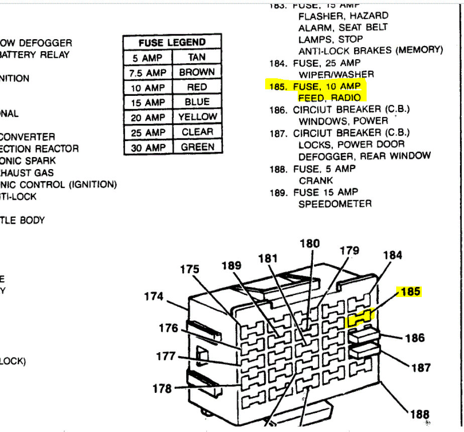

First, in addition to checking the fuse, confirm there is power to it. See pic 1 for radio fuse. Pic 4 shows fuse location in vehicle. Here is a link to help with testing:

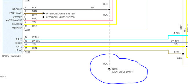

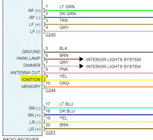

If the fuse is good and power is available, check the yellow wire in the connection to the rear of the radio for ignition power. See pic 2.
If there is power, then check the ground for the radio. See pic 3

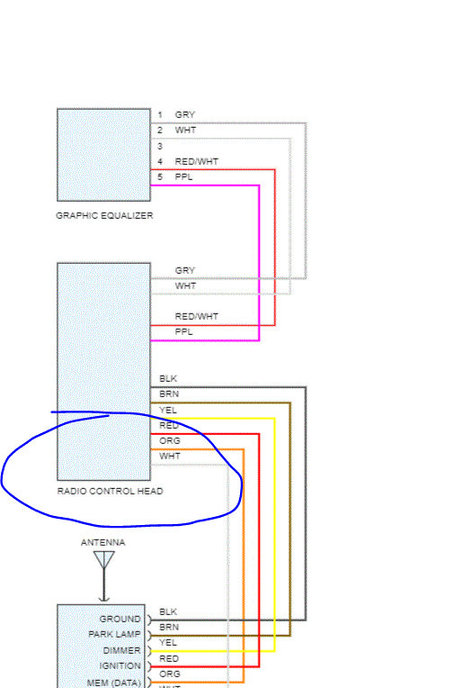

Are you referring to the control head when you say control data module? See attached pic. Also, when you turn it on, does it turn on and there is no sound?

It will not turn on, but there are some things lit up but nothing can be done with the radio.
