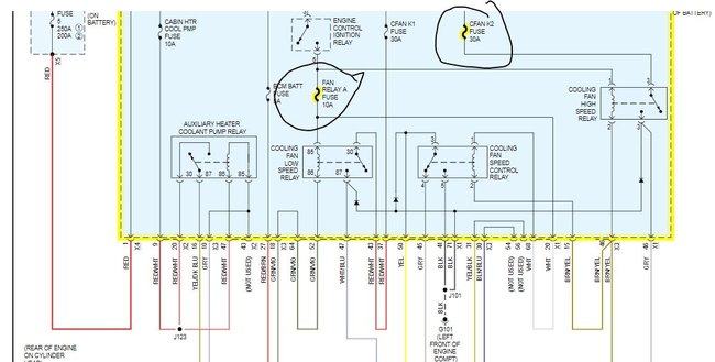

I know for a fact that the fuse, relays and the fan motor are good. When I turn on the air conditioner the drivers side fan comes on but the passenger side fan doesn't come on at any time.
When I hot wired the passengers side fan and it will work.
It must be some kind of sensor or similar part that's stopping the fan motor from working.
I need a wiring diagram of the electrical circuit of the fan motors for the passenger side and drivers side circuits.

Good afternoon,
I attached a wire diagram. Check the fuses listed for power with a test light or voltmeter. Make sure there is power. Check the 2 fuses I circled for power.

It has power at these fuses, what else could it be ?
Jul 30, 2019 at 10:47 PM
Okay, go to the relays. remove the relays and turn on the key. Test for power at the pins in the fuse box where the relay plugs in. Let me know the voltages and what pins.

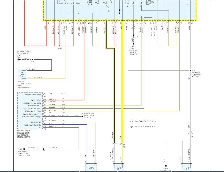

The computer is not sending the ground back to the relay that energizes the fan is what someone has said,we are not sure what all is in the circuit to make the fans work.
Are there any sensors in the radiator or on the head that plays a part in the fans working the correct way, that you know of ?
Jul 31, 2019 at 7:39 AM
The only sensor is the coolant sensor.
You should also verify voltages to the relays as I suggested.
Remove the connector while the engine is running and see if the fans come on.

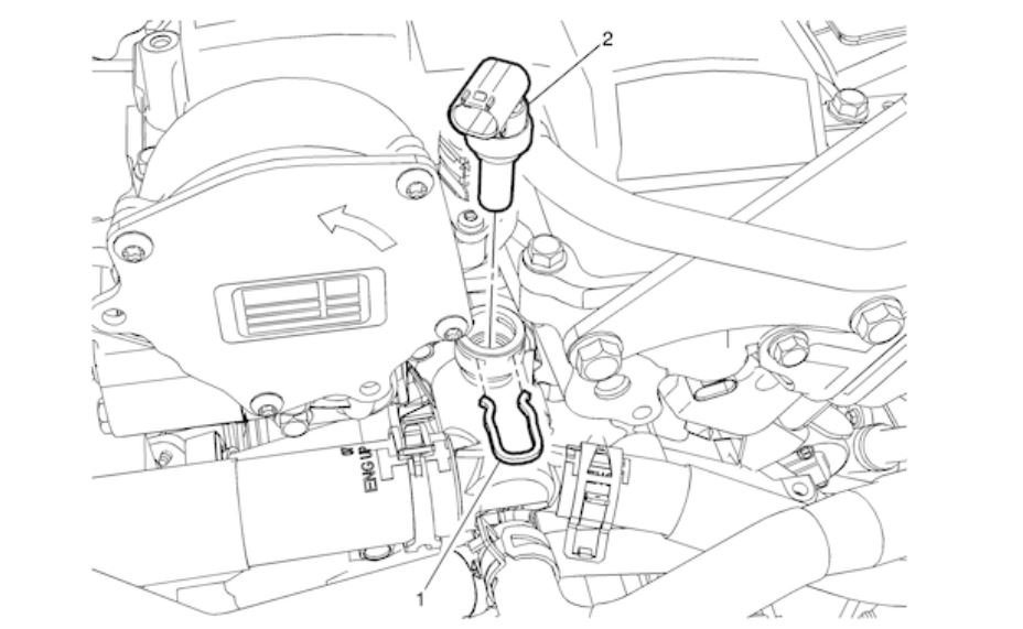

We disconnected coolant sensor and started the engine and the drivers side fan worked but passenger fan didn't work. When the engine was turned off the fan kept running, had to remove the fuse to stop the fan. Let me know what you think.

Replace the coolant sensor. start there.
If the fan came on then the circuit is good. That leaves the sensor.

That coolant sensor done the job, got the fans going.
Does that coolant sensor have a thermistor in it ? Thanks a lot
Aug 5, 2019 at 9:43 PM
No. It is temperature sensitive.
