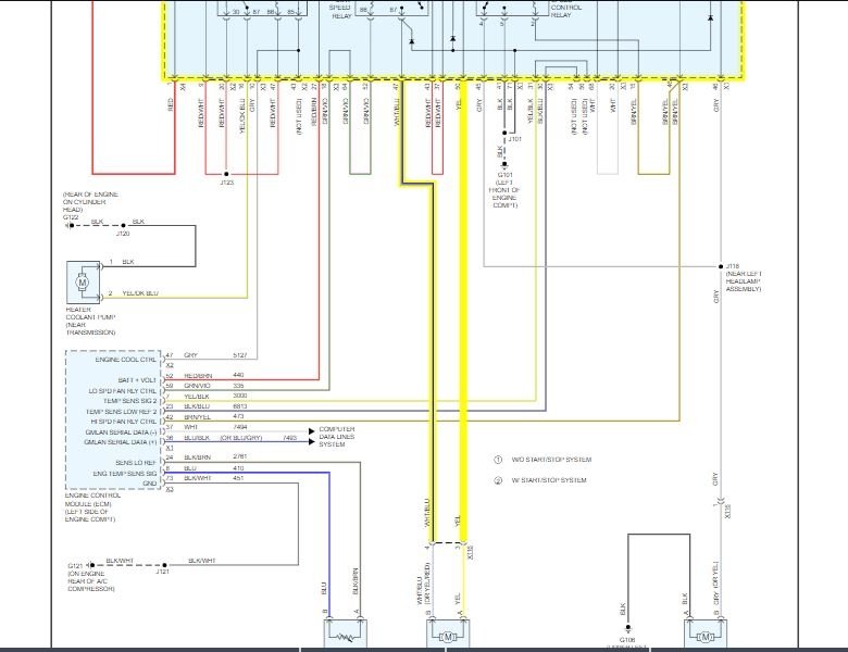

I need a wiring diagram of the electrical circuit of the fan motors for the passenger side and drivers side circuits.

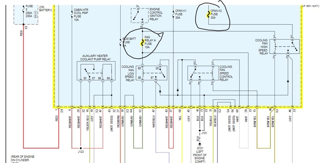

I attached a wire diagram. Check the fuses listed for power with a test light or voltmeter. Make sure there is power. Check the 2 fuses I circled for power.

It has power at these fuses, what else could it be ?
Jul 31, 2019 at 5:47 AM
Okay, go to the relays. remove the relays and turn on the key. Test for power at the pins in the fuse box where the relay plugs in. Let me know the voltages and what pins.

The computer is not sending the ground back to the relay that energizes the fan is what someone has said,we are not sure what all is in the circuit to make the fans work.

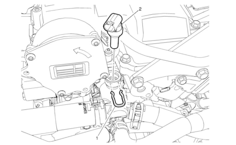

We disconnected coolant sensor and started the engine and the drivers side fan worked but passenger fan didn't work. When the engine was turned off the fan kept running, had to remove the fuse to stop the fan. Let me know what you think.

Replace the coolant sensor. start there.
If the fan came on then the circuit is good. That leaves the sensor.

That coolant sensor done the job, got the fans going.
Does that coolant sensor have a thermistor in it ? Thanks a lot
Aug 6, 2019 at 4:43 AM
No. It is temperature sensitive.
