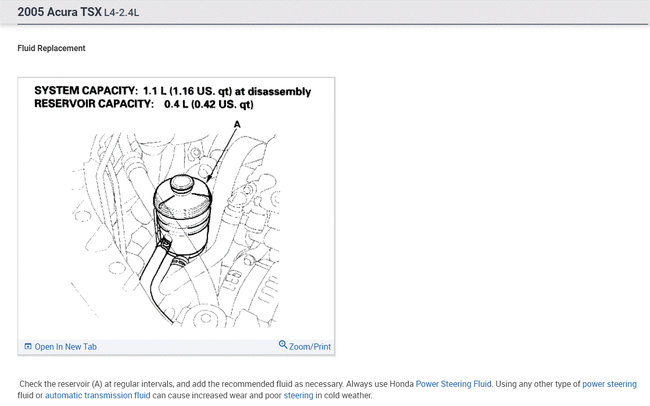

What type of steering fluid does this vehicle use?
2005 ACURA TSX
179,000 MILES • 2.4L • 4 CYL • 2WD • AUTOMATIC
XXMAYNORXX
I'm having problems with my steering wheel. It gets hard i put the steering wheel fluid make for Honda's and Acura's and it's still hard to turn and i think i put on the wrong steering wheel fluid.
Feb 19, 2022 at 2:39 AM
  • 110,240 POSTS
The original Acura part number for the power steering fluid is 17778-01025336 and is vehicle specific. Is that what you are using?

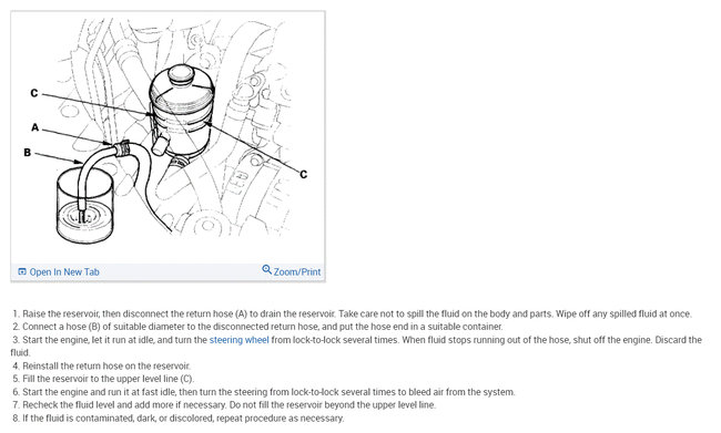

Also, have you tried flushing the PS system? I attached directions below for you. If you haven't, you may want to consider trying it.
