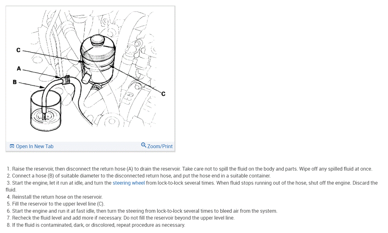

I'm having problems with my steering wheel. It gets hard i put the steering wheel fluid make for Honda's and Acura's and it's still hard to turn and i think i put on the wrong steering wheel fluid.
Feb 19, 2022 at 2:39 AM
  • 110,244 POSTS

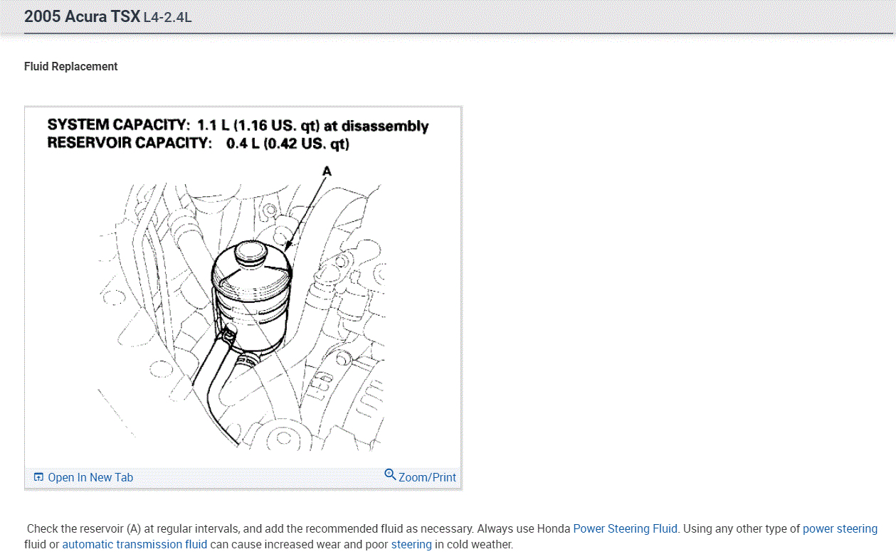

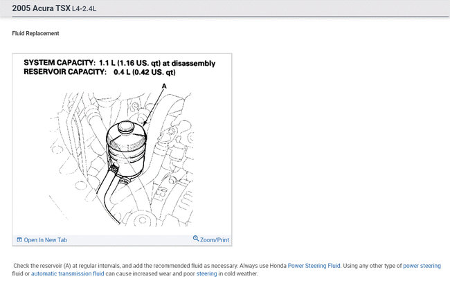

The original Acura part number for the power steering fluid is 17778-01025336 and is vehicle specific. Is that what you are using?
Also, have you tried flushing the PS system? I attached directions below for you. If you haven't, you may want to consider trying it.
