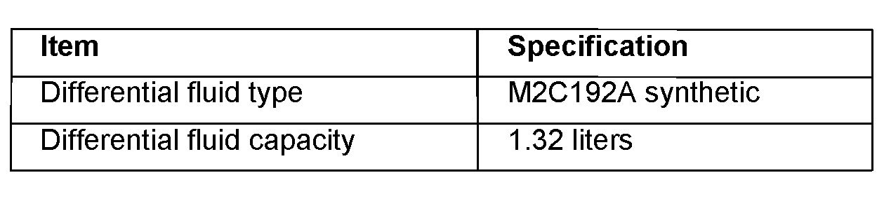

Hello, good afternoon, can you please tell me what type of oil does the differential in the car use? Thank you for a speedy response as always.

I attached the fluid and amount needed for the fluid. Use only Jaguar fluid.

Hello, can you please tell me if the Ligui Moly oil can be used in the transmission instead of the Shell M1375.4? because I cannot get the Shell to buy where I am living. Thanks
Feb 9, 2019 at 4:50 AM
No, it is not compatible at all.
You need the oil with that exact designation or damage will result.
