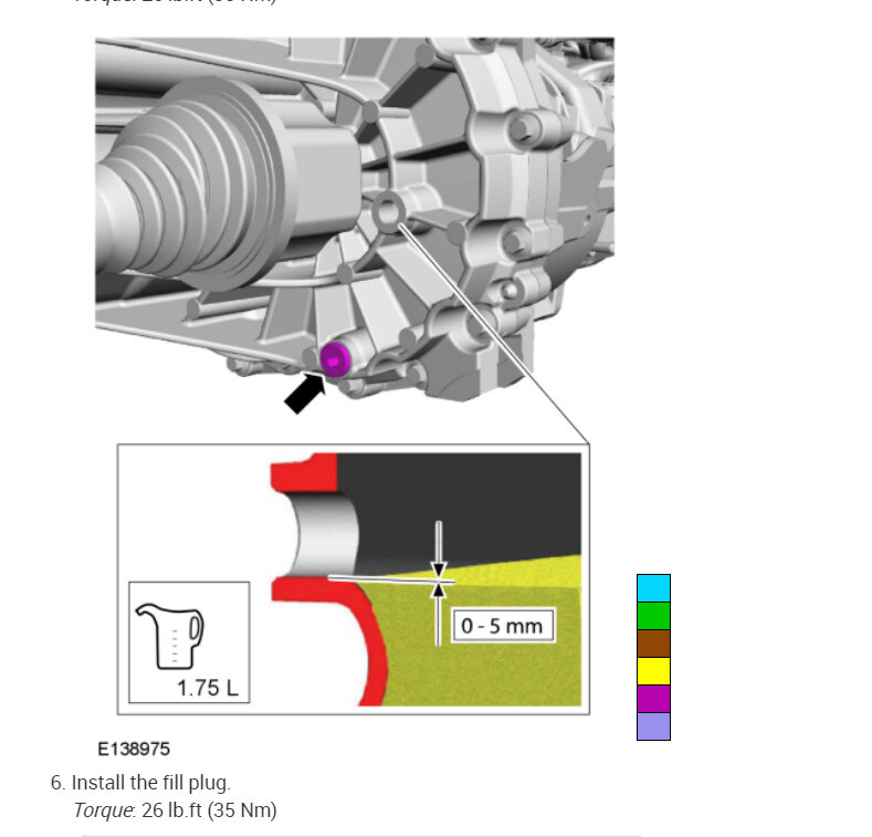

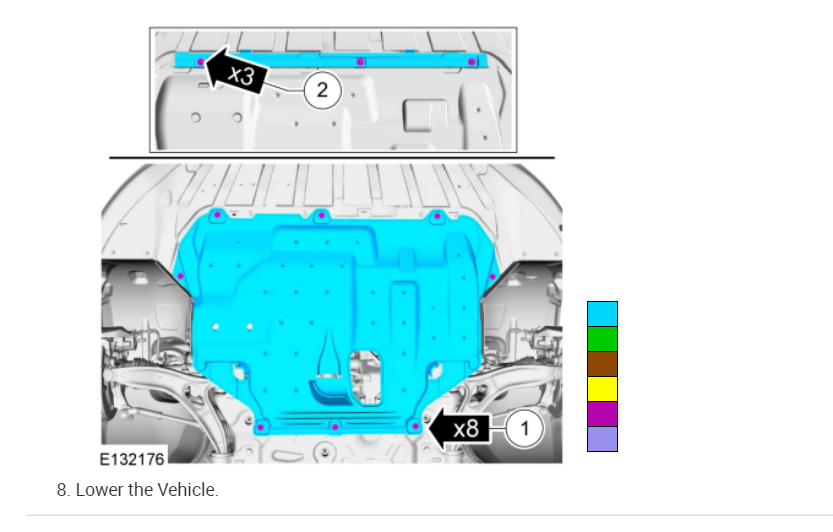

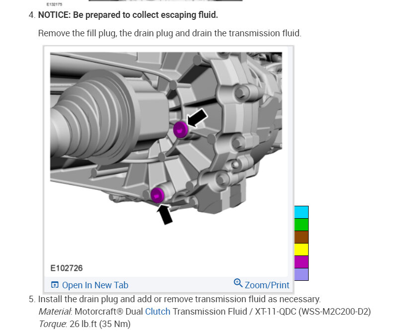

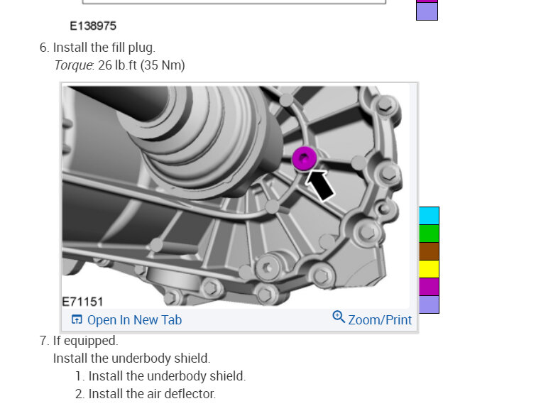

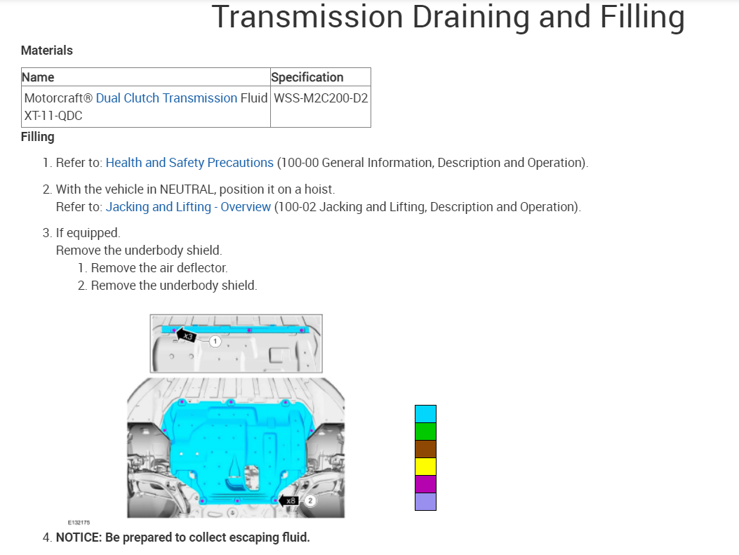

Hello, I need to change the gearbox oil on this car, can you tell me what kind of oil and where is the overflow screw? This model has 6 gears.
A thousand thanks.
Jan 19, 2023 at 1:25 PM
  • 55,423 POSTS
Sure, here is the gear oil type with how to change it out in the images below
Motorcraft Dual Clutch Transmission Fluid XT-11-QDC WSS-M2C200-D2 2.01 qt ( 1.9 L) (0- 5 mm below the lower edge of the fill plug hole)
Check out the images (below). Please let us know if you need anything else to get the problem fixed.
