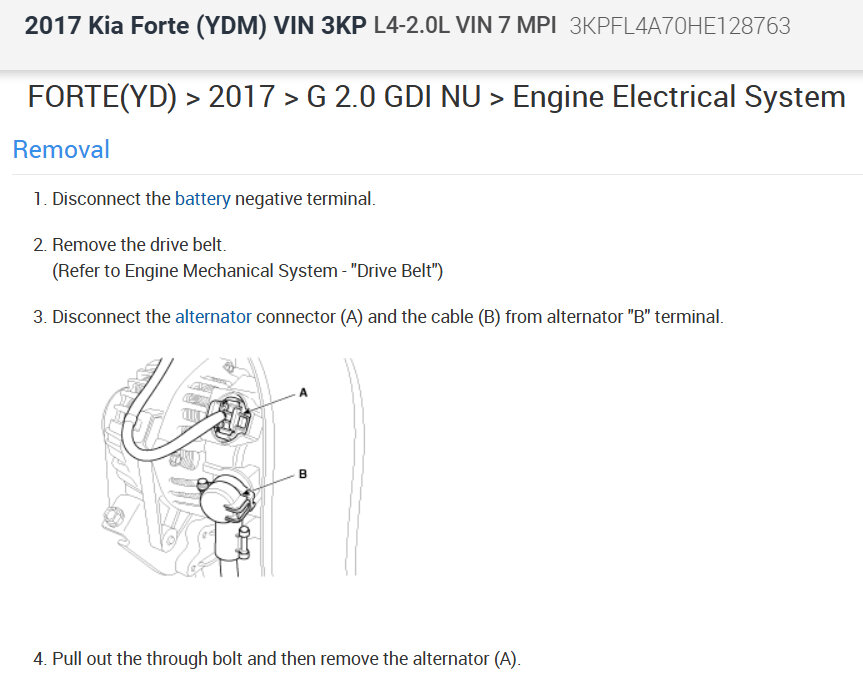

What type of alternator is needed for this car?
2017 KIA FORTE
128,000 MILES • AUTOMATIC
JESSICABAXTER
VIN 3kpfl4a70he128763 I bought an alternator from AutoZone, but my mechanic is saying I need to get the Oem number?

Sure, here is the OEM part number for your alternator and the OEM alternative part number.
OEM Part Number: 37300-2E600
Alternative OEM Part Number: 37300-2E601

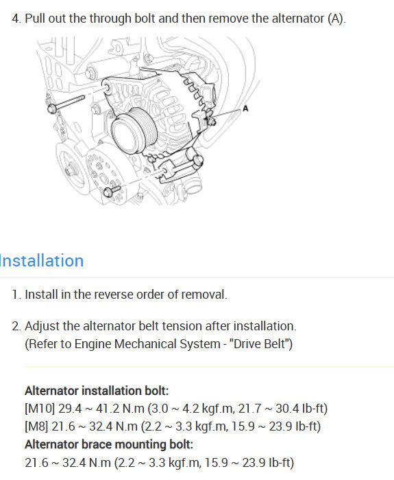

Here is how the alternator is changes out in case you want to know. Check out the images (below). Let us know if you need anything else.
