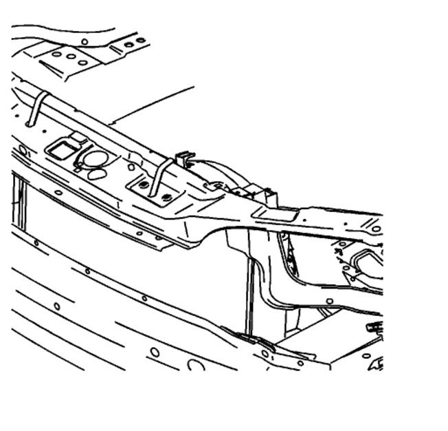

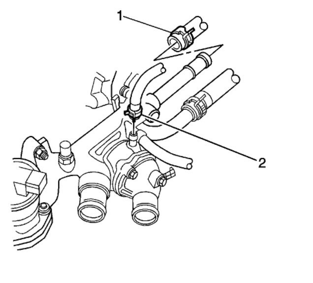

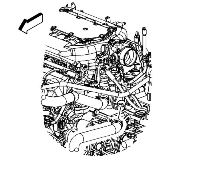

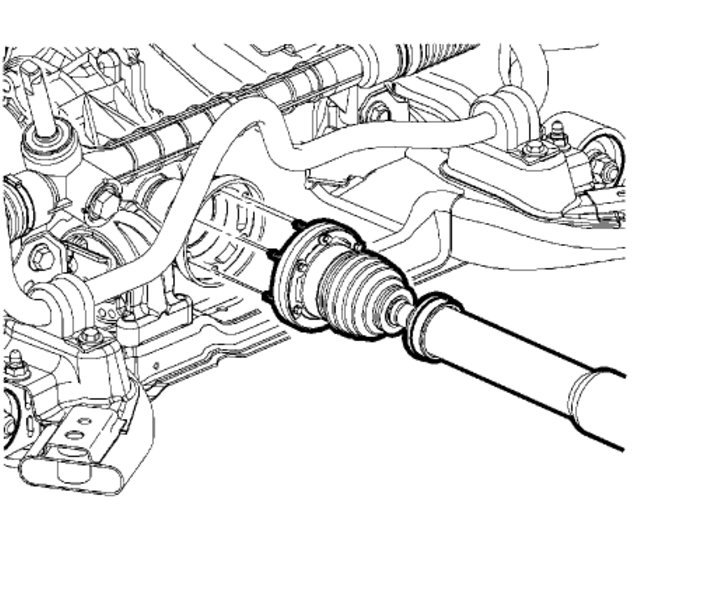

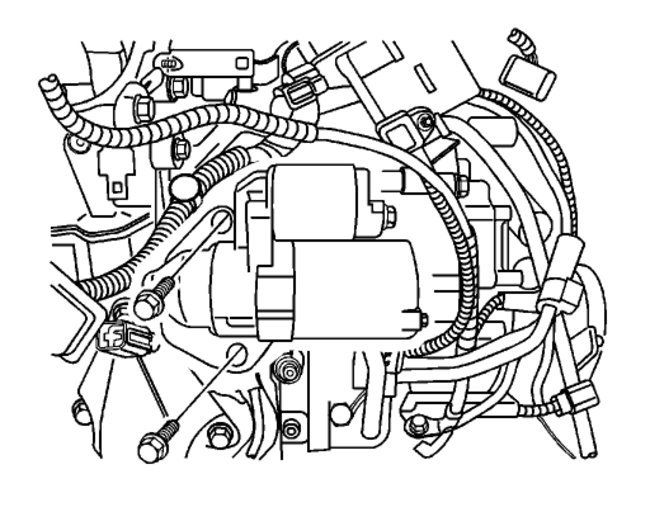

To change the rear main seal you will need to remove the transmission. Here is a guide that will show you how to jack the car up to get started. Disconnect the battery first
Here is a guide that will give you an idea on what you are in for when doing the job.
https://www.2carpros.com/articles/transmission-replacement-removal-manual
and
https://www.2carpros.com/articles/crankshaft-main-seal-replacement-rear
Here are some diagrams (below) to show you what it will be like on your car.
