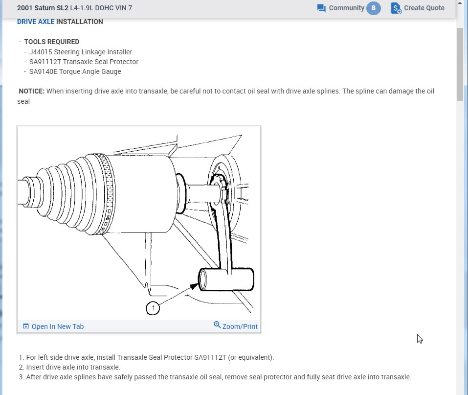

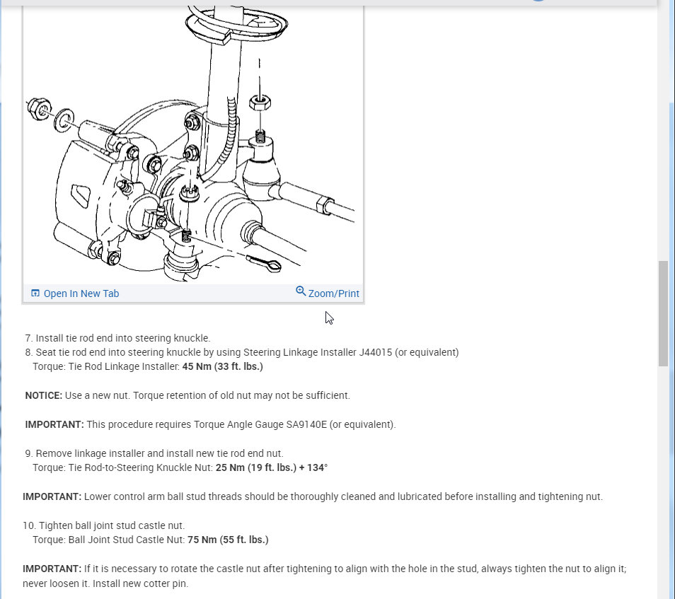

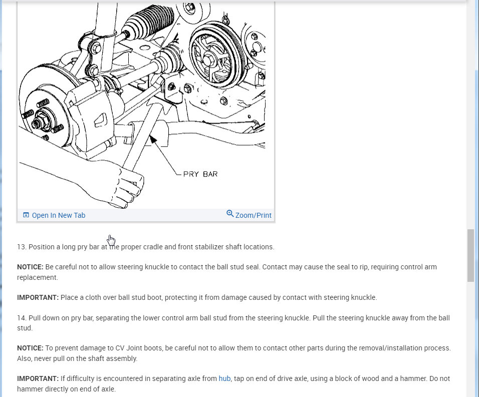

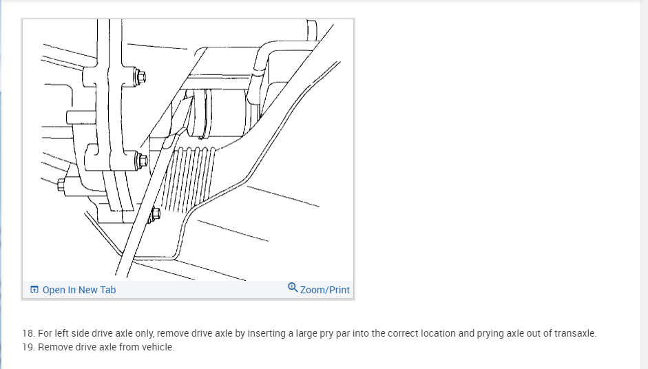

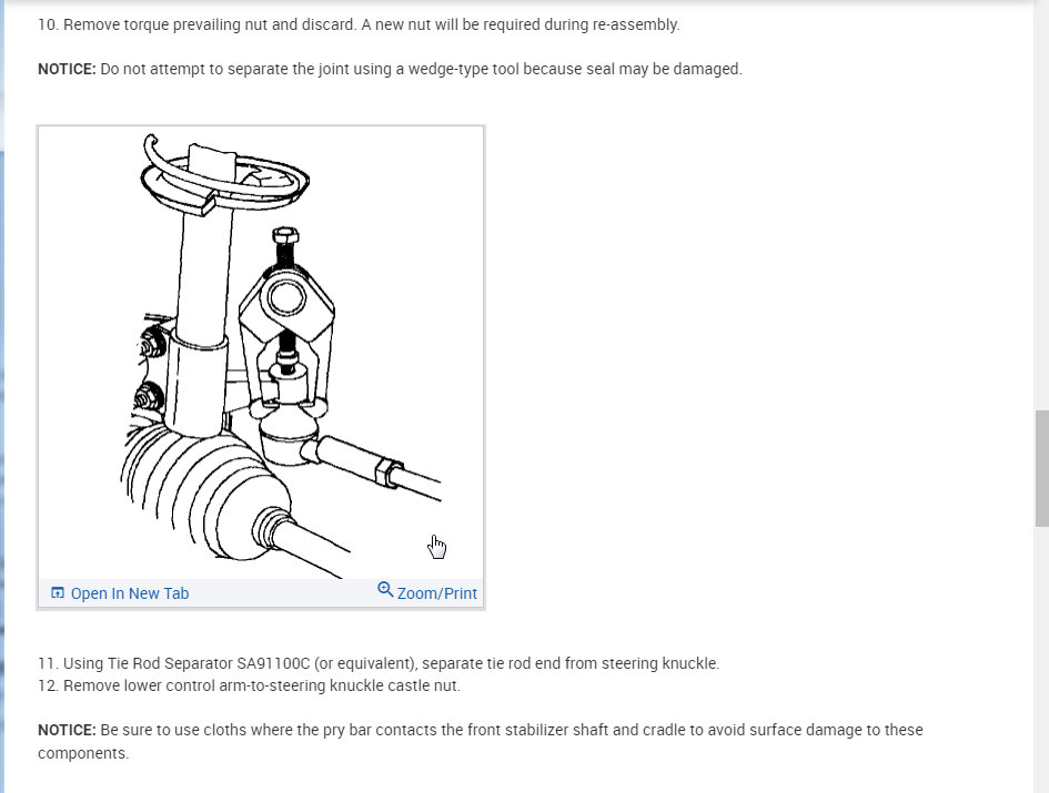

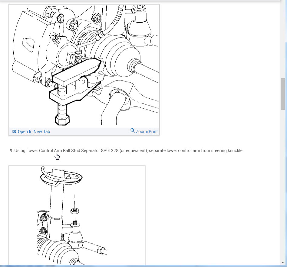

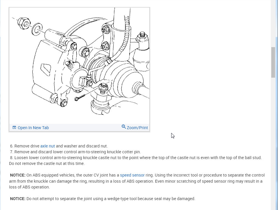

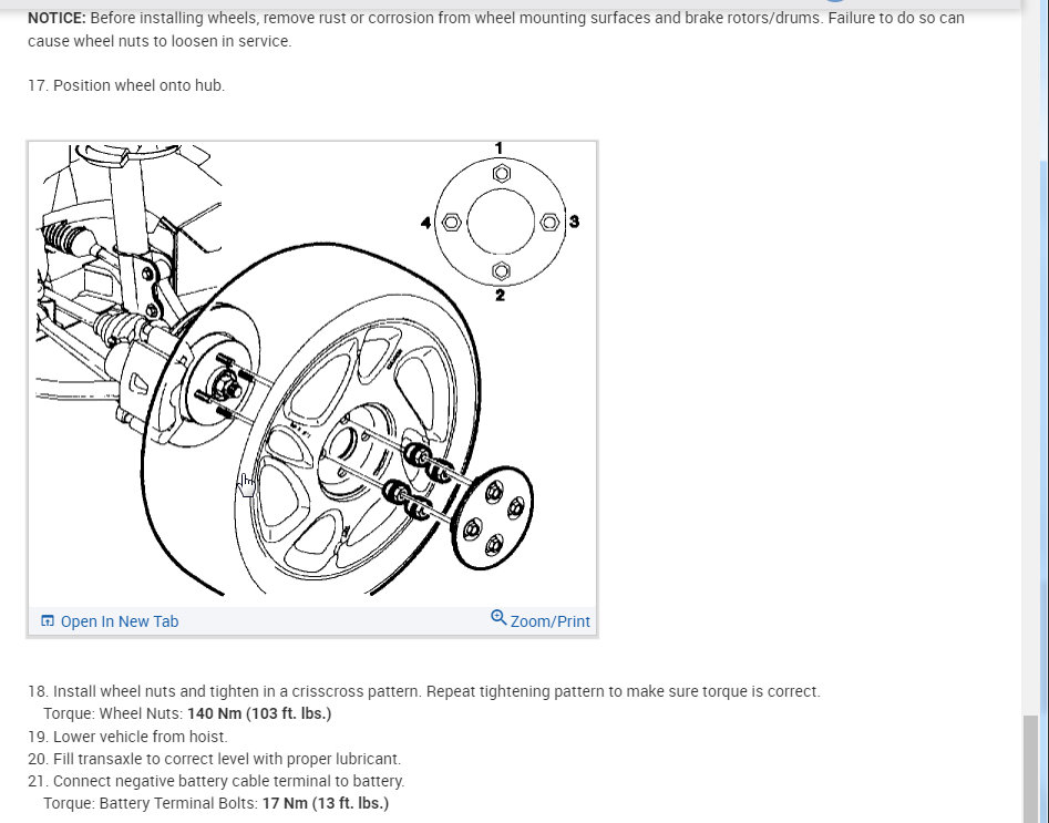

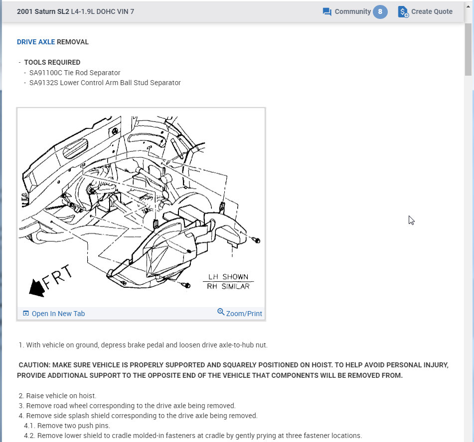

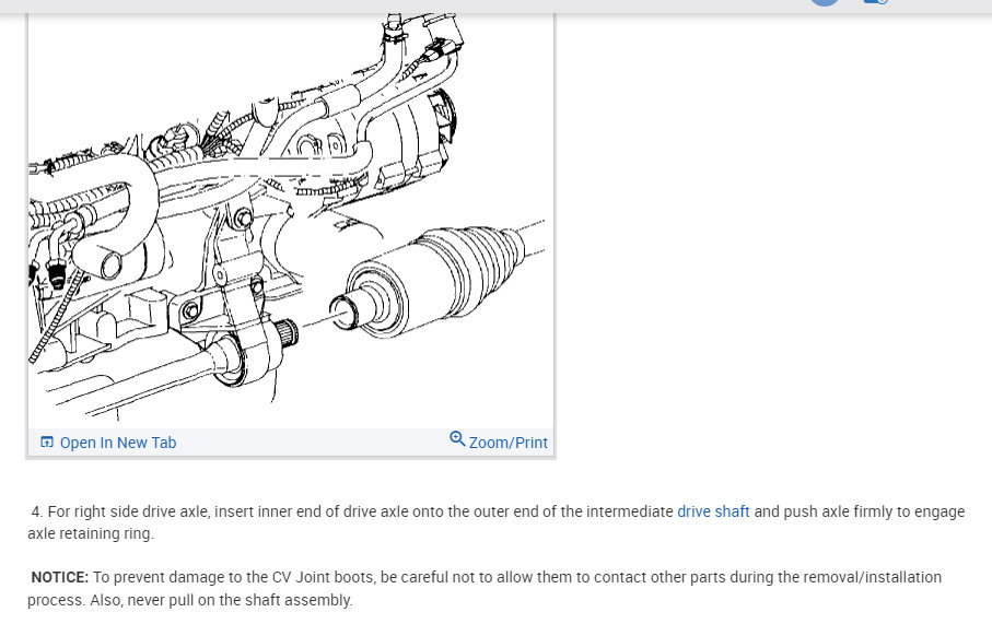

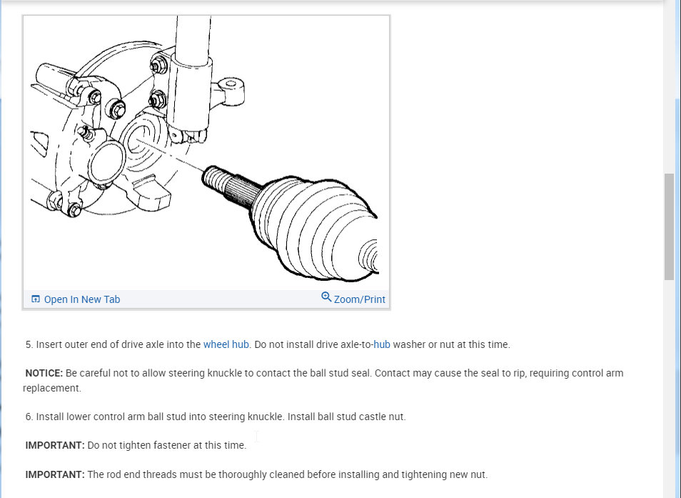

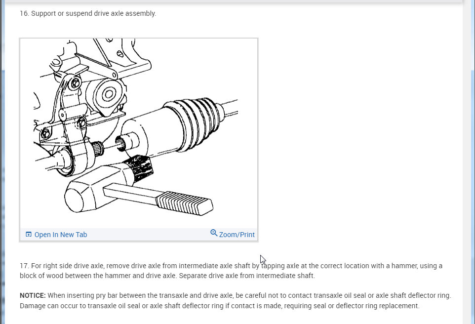

I need to know what I'm going to need for the replacement of both CV axles. What tools, what size sockets, wrenches etc?
May 18, 2020 at 9:12 PM
Here is the entire process from the manual. Unfortunately I can't help with actual wrench or socket sizes. This information comes from having a wrench/socket set and finding the proper sizes for each nut or bolt you need to take off. As you get more experience you will be able to recognize the size by looking at them but unfortunately I don't have them memorized on this job.
Let us know if you need more info. Thanks
