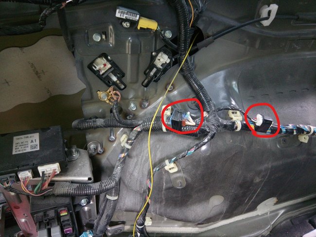

What do these connectors connect to?

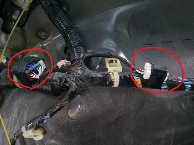

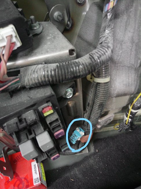

I added photos with wires and connectors placed rear left site inside car (near rear left wheel). There is one connector (marked blue circle line) and there are two connectors (marked red circle line) without connection. Why is it not connected?

Good morning,
Manufacturers make wiring harnesses for a vehicle with all available accessories. That way, they don't have to make separate harnesses based on the options selected.
Those connectors are for components that are not installed on your car. They tape them off and attach them to the main harness, so they don't dangle all over.
As long as nothing is wrong with your car, you are good.

I noticed we haven't been in contact with you for a couple of days. I looked at the pics you attached. To the best of my knowledge, those are related to the HDMI (High-Definition Multimedia Interface). Are the wires mostly white?

thank you for your reply. The left one connector which is colorful housing (brown, black, blue, green and white) have white wires. The second one housing of connector is white with white, black and red wires. And the last connector is light blue housing of connector - it is near rear box with fuses and relays.

Looking at the schematics, those all appear related to the HDMI system. Do you have that option in the vehicle from the factory?
