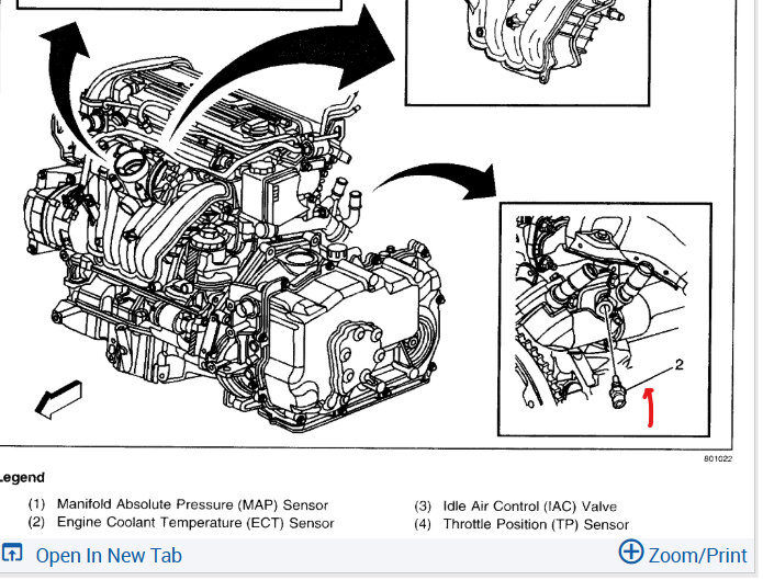

Where is the coolant temperature sensor located?
200,000 MILES • 2.2L • AUTOMATIC
HELENAHILL
Need to find the location of coolant temperature​sensor to replace it.

Its usually on or near the thermostat housing on the cylinder head just follow the radiator hose to the engine it should be right around where the hose meets the engine it will have a 2-wire plug going to it . ..good luck

Here is the location of the coolant sensor. Check out the images (below). Let us know how it goes.
