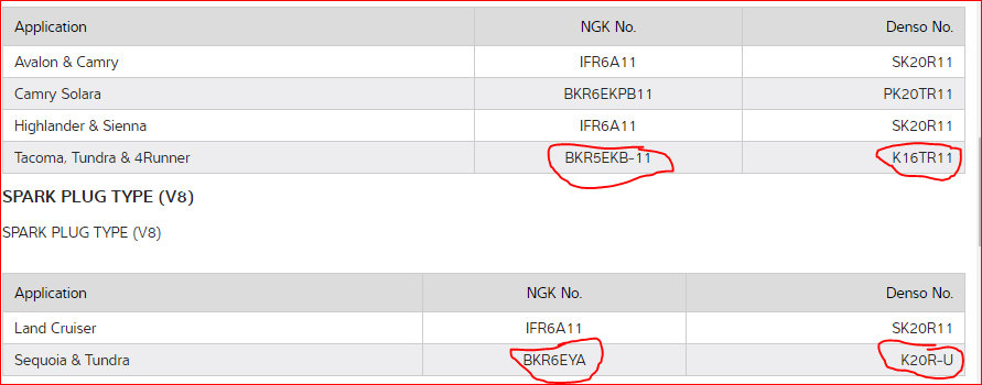

I would like to know what are the best spark plugs to use in my truck? Type and model number. Thank you!

I have 150,000 miles on it.

I have attached a picture and circled in red the NGK and Denso brand part numbers.The number on top is for a V6 and the bottom are for a V8 since you did not include your engine size. Hope this helps and thanks for using 2CarPros.

I would like your opinion (which I value as the best!) about what type of spark plugs, and the model are the best? I thank you for your time and help.
