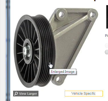

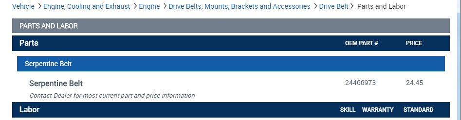

Need help finding a serpentine belt for the car listed above. Need to bypass the A/C pulley just need the right size belt.
Apr 15, 2020 at 11:59 PM
Unfortunately they don't list an option with non A/C. This means you have three options. First, you can try and call the dealer and see if they have a listing for a non A/C option however, I suspect they will not either.
Second, you can get a bypass pulley and remove the compressor and install this in its place, then you can use your existing belt.
Third option is to get a custom size belt but this would require you measure the distance around the pulley less the compressor. This is pretty easy. You just route a piece of string around the pulleys as the belt would go and then make it. Then remove the string and measure it with a tape measure.
Again, due to it not having listing, we wouldn't know the size of the belt without measuring it ourselves. Let me know if you have questions. Thanks
