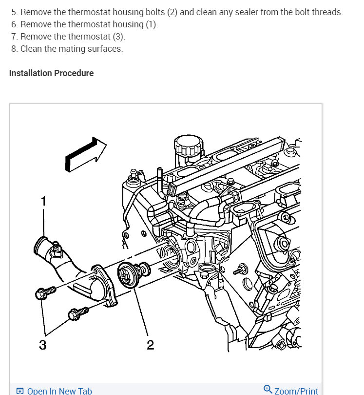

I need to change my thermostat, but I'm scared my bolts are going to break if I try to take them out. So, I need to know what size the bolts are for the housing.
Sep 12, 2023 at 2:46 AM
  • 55,456 POSTS

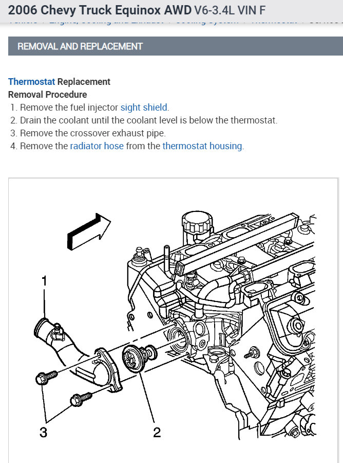

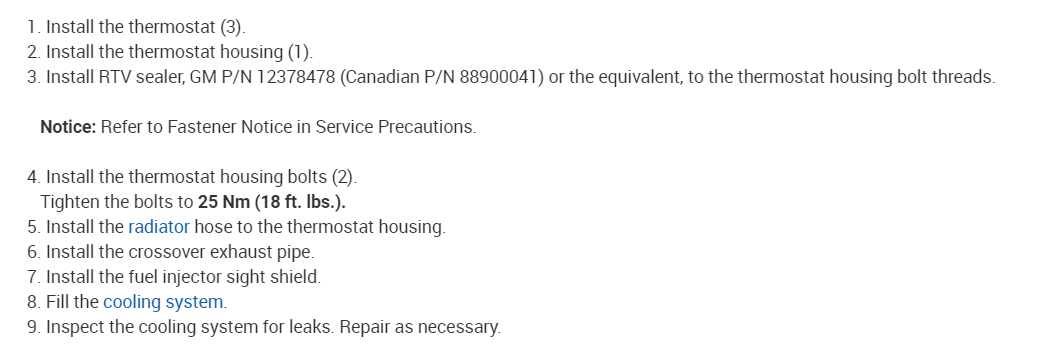

It looks like there are 10mm x 1.5 thread. Here is a generic guide to help you step by step with instructions in the diagrams below to show you how on your car:
Check out the images (below). Please let us know if you need anything else to get the problem fixed.
