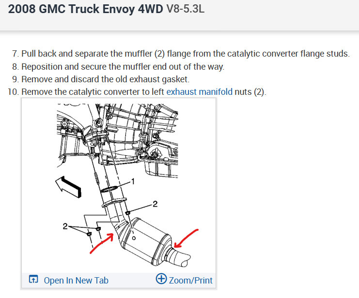

This can be because the catalytic converter on that side of the engine can be partially clogged. Here is a guide to help confirm the issue, I marked in red arrows where the cat should be tested.

I don't think my catalytic converter is clogged. Theres no code for it. And I heard when your catalytic converter gets clogged it won't go past 45MPH. And my car does go past 45.

A partial clog can cause the misfire, there are three cats on this vehicle. You said there is an exhaust leak? Where is it leaking? This car has the cylinder delete function which where problems as well which took out the camshaft and lifters.
