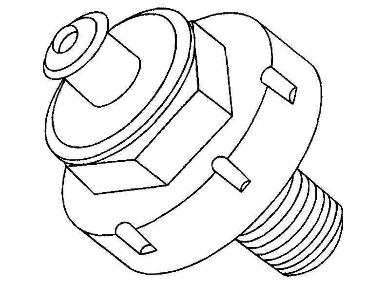

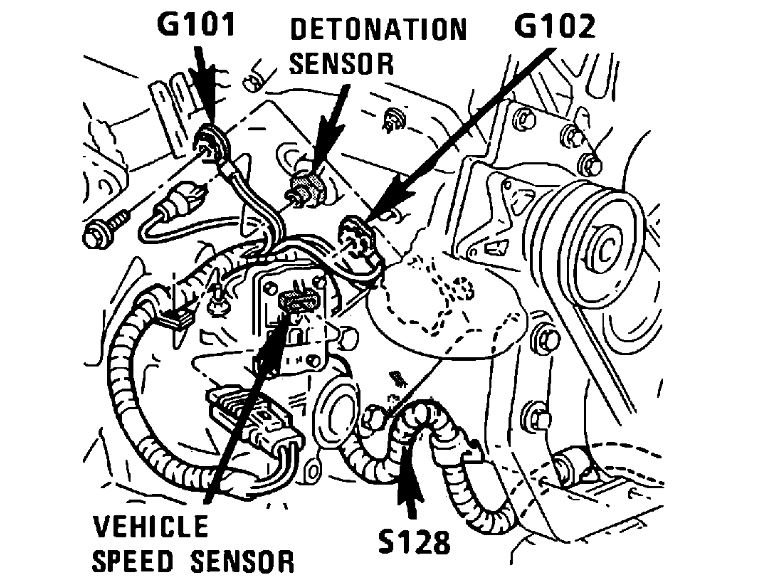

Where is it located? is it hard to get too? I couldn’t tell from the diagram.
Jan 13, 2019 at 5:18 AM
It is mounted to the block under the exhaust manifold as in the picture. It has a single wire connector to it and there was also a picture of the sensor.
It is at the back side of the motor. You will need a lift to get to it.

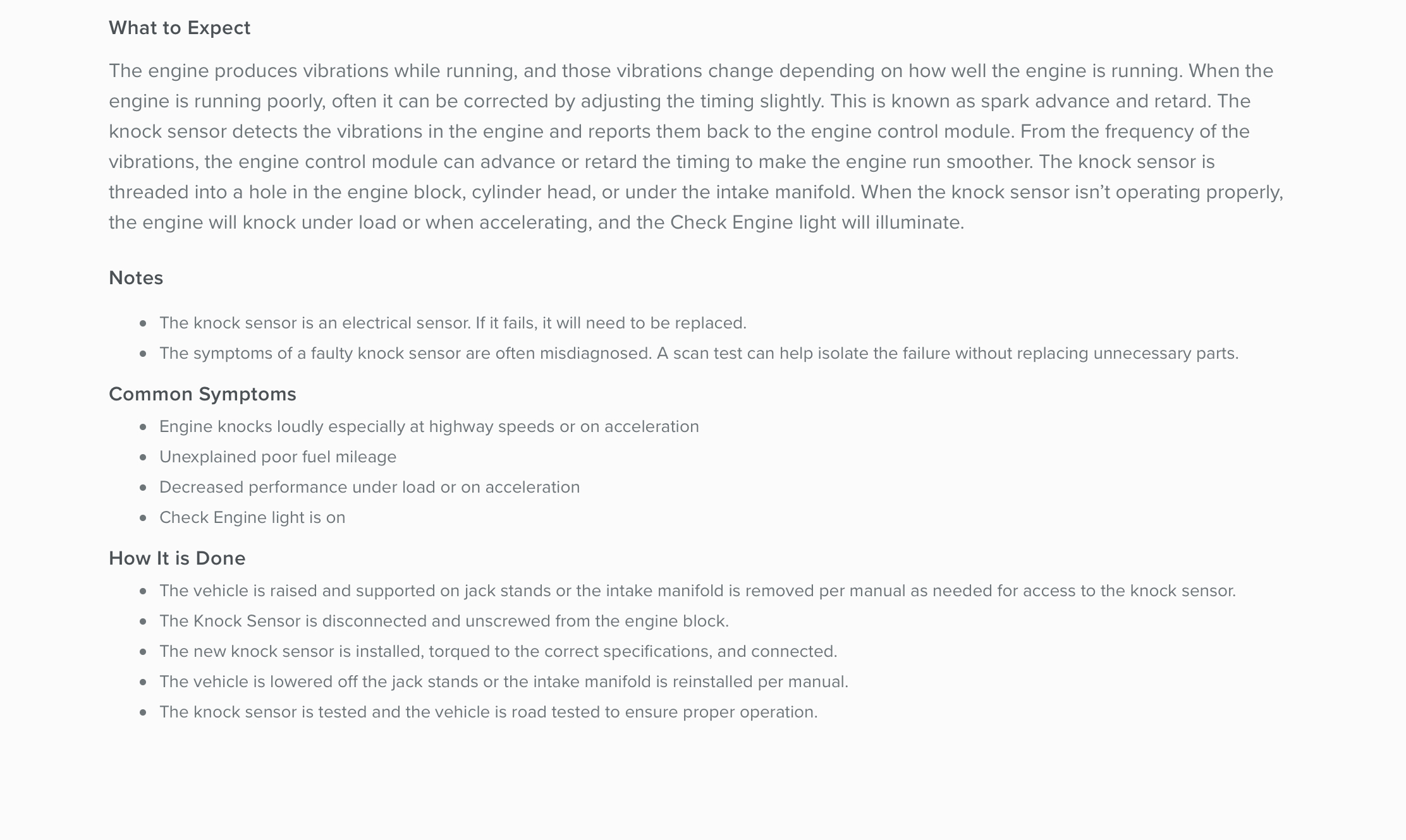

Need to get to the knock sensor in my vehicle. Factory says you can either put on jack stands or do it manually and remove the intake manifold. I don’t have jack stands to do it. I would appreciate it if you can give me some factory information on how to remove the intake manifold.
Jan 14, 2019 at 9:13 AM (Merged)
Good afternoon again,
I do not see nor have I ever removed the intake for the sensor.
Can you take a picture of where it tells you this procedure?
The sensor pays .9 hours or 54 minutes from start to finish. That does not require the removal of the manifold.
COOLOLDS85
  • 173 POSTS
This was on yourmechanic.com. it said jack the car and used jack stands or remove intake manifold and sensor will be easier to access.

Back when we had the other post, I told you that it has to be accessed from the bottom. I included a picture of the location.
If anything would come off to make it easier, the exhaust manifold is close to it.
Look up underneath with it jacked up. You will see it there. You will need small fingers to get it.

I thought i felt the sensor but wasn’t sure what side, I was just wondering, the exhaust manifold is on the driver side correct? Because that’s where my EGR tube connects into. I wasn’t sure what side of the vehicle the sensor was on from looking at the photo.
It is on the back of the motor under the exhaust manifold. You should see it when you have it raised in the air.

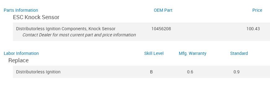

I don’t have a lift of my own or jack stands. so I guess I will have to take it somewhere. I have the part but can you tell me how much a shop would charge to install the part? Internet says around $100.00.
Yes, .9 hours should be close to that depending on the shop's labor rate.
