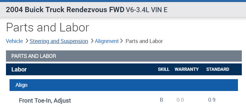

2. It is a good idea to replace suspension components that are worn out prior to replacing tires. However, if the tires are almost bald, you want to replace those soon. Clearly bald tires are a safety issue but if you put new tires on a suspension that is worn out you will potentially damage the new tires. It is always recommended to align a vehicle when you put new tires on and you can't align a vehicle that has worn steering or suspension components.

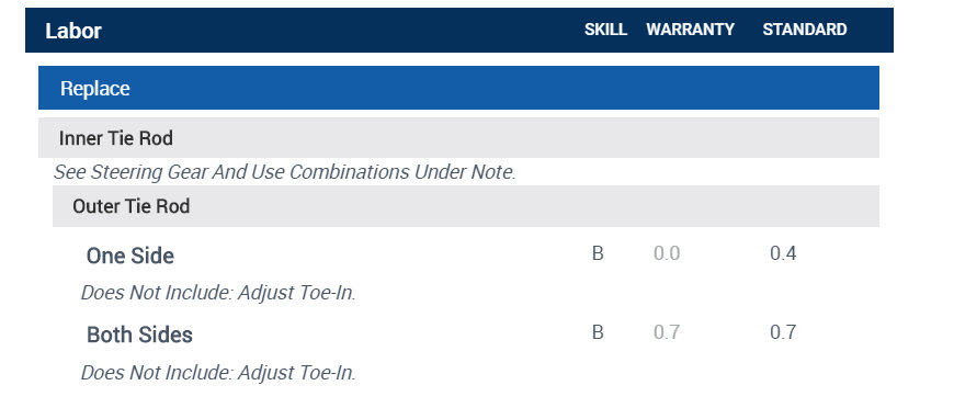

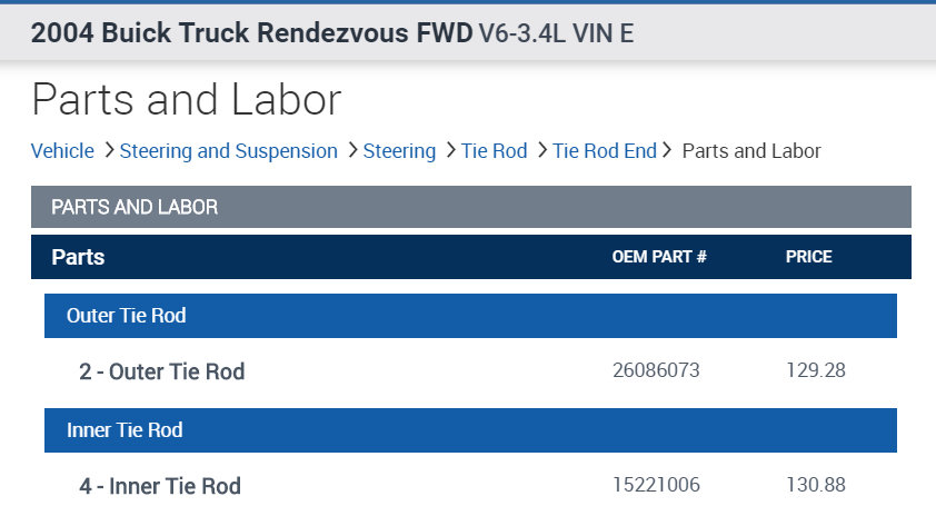

inner and outer tie rod replacement should cost approximately?
thanks again.
May 19, 2019 at 4:47 AM
SCGRANTURISMO
  • 4,897 POSTS
Be careful around electrical connectors, wires, gaskets, and hoses. It will work great on heavy thick oily deposits. On the really, really thick oily spots foam it on and let it sit for five to ten minutes, then reapply and scrub with a scrub brush. Rinse off with a hose and if needed, repeat. I have included the estimates for both the inner and outer tie rod ends in the diagrams down below. Keep in mind though that these are the price estimates at the dealership and that you might be able to get parts and labor rates a little less expensive at another shop. For labor add the labor times together and multiply what the average shop labor rate is where you live at.
