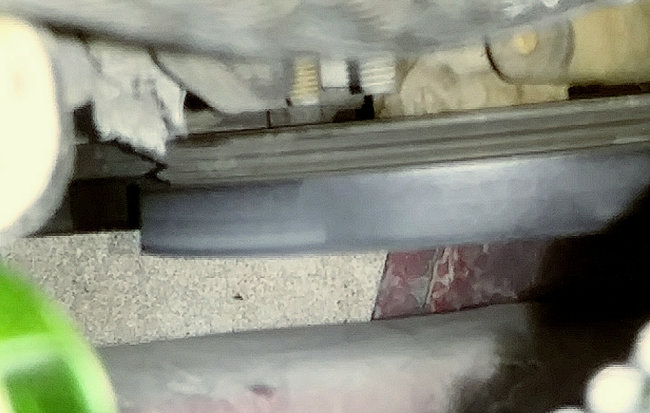

I have been trying to diagnose my sister's car's issues and recently noticed that the serpentine belt is only halfway on the A/C compressor pulley. The inside edge (edge that faces the engine) of the belt is on the flat part of the pulley, where the belt should be. But the outside edge(edge facing the passenger-side fender) is riding up on the rim of the A/C compressor pulley. And yet the belt is aligned correctly with the other pulleys. I am crossing my fingers hoping that any of the symptoms or problems an off-kilter belt may cause will match some of what I have been experiencing thus giving me another piece to this puzzle. What symptoms would be experienced from this? Thank you for your help!

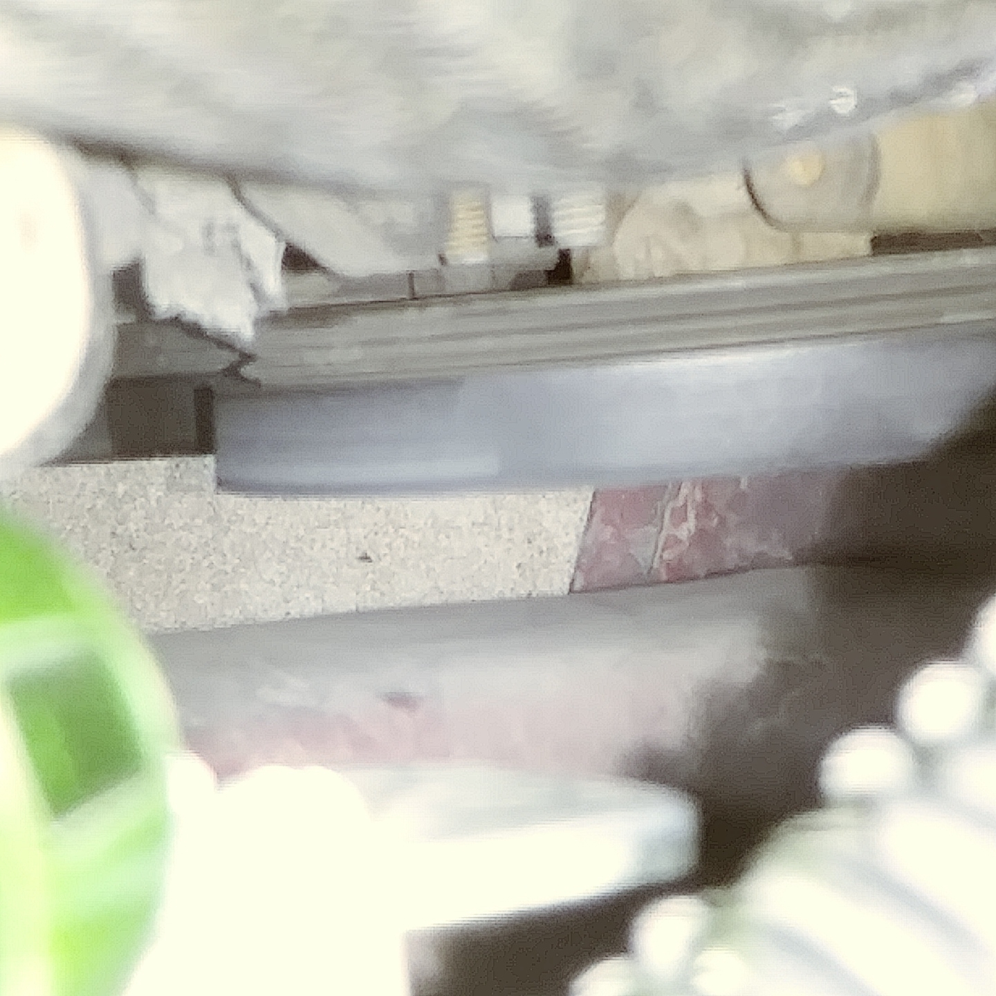

Here are the pictures of the PT Cruiser serpentine belt riding the edge of the pulley. For orientation: these are taken from above. leaning over the passenger side fender, looking down. Top of picture is engine, bottom is passenger fender, off to to the right is front of car, to the left is windshield. Hope that all makes sense and helps!

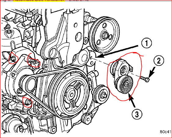

I see what you are talking about now. That is kind of dangerous so it needs to get fixed quickly. I have attached a tutorial showing how to remove/replace a serpentine belt. I have attached a picture and circled in red the components involved in the loosening/tightening to get the belt back on track. The belt that goes around the alternator has three bolts to be loosened to slip it back on track and then tighten.The tension-er has a strong spring so it takes force or a specialty wrench with extra leverage to loosen. Hope this hopes and feel free to ask any other questions.Thanks again for using 2CarPros.

Also, I got the serpentine belt back on the pulley. However after starting the cruiser and idling for a very short time the belt had worked its way back to that same position of riding the rim/edge of the pulley. It is baffling.

What is going on with the belt is weird. Sounds like a pulley or the tension-er is not in line causing it to become out of line. The code P0508 is for the Idle Air Control valve. Is the Idle unusually high/erratic? Having the P0300 codes are for cylinder misfires and could be caused by the low compression found in the engine code P0302 is specifically for cylinder number two. Code P0108 is for the MAP sensor and would also cause engine to run poorly/erratic as well. Not sure how much more you want to spend on the car but $1,800.00 is a lot of money. Would they give you a warranty/guarantee with that work? Hope this helps and let me know if you have any other questions.Thanks again for using 2CarPros.
