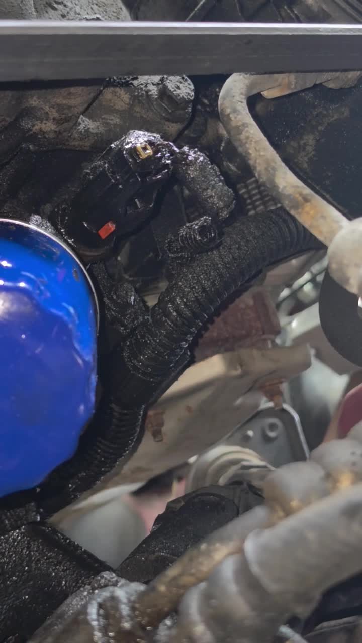

What part/how would I replace this part oil pressure sensor?

2005 jeep liberty sport 6 cylinder leaking oil above where the oil filter is where the oil pressure sender thing is

Yep, that is leaking nicely. You will need to remove the electrical connector and use a special socket which I have leaked below.
Oil pressure sensor
https://amzn.to/4aUjIaD
Oil pressure sensor socket
https://amzn.to/4eqnjym
Please upload an image or a short video in your response if you have any troubles so I can help walk you through the repairs.
