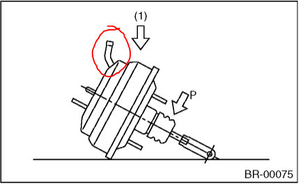

Idle goes down and engine almost shuts off when stepping on brakes. Check engine and traction control lights went on for a few seconds. Checked through an OBD and detected misfires on cylinders 3 and 4.
Aug 5, 2022 at 2:15 PM
  • 110,244 POSTS
If you notice pressing the brake pedal seems to cause the issue, there could be a vacuum leak being caused by the power brake booster.
If you open the hood, locate the brake master cylinder on the driver's side firewall. Behind it is the brake booster. Check the vacuum hose going to it. Make sure it is attached, not damaged, and isn't leaking.
I attached a pic of the booster below for your reference.
Also, have a helper press the brake pedal while you listen for any hissing sounds or something that could indicate a leak.
Let me know what you find.

The power brake booster seems okay. I turned on the engine and after 30 secs or so, the engine sounded like it was going to shut off. I can also hear a mild clicking sound near where the spark plugs are on the driver side.
Aug 6, 2022 at 3:43 AM
  • 110,244 POSTS
The clicking sound is likely from the fuel injectors. That is normal. Do me a favor. Check to see if you can find any vacuum leaks. The idea that when you apply the brakes it happens worse leads me to think the engine vacuum is low and the booster requesting vacuum is too much.
