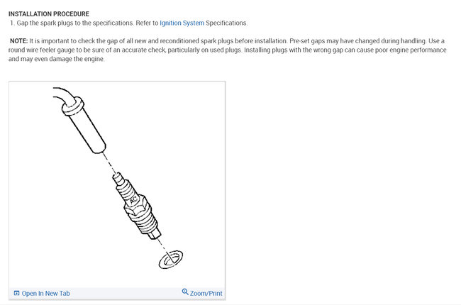

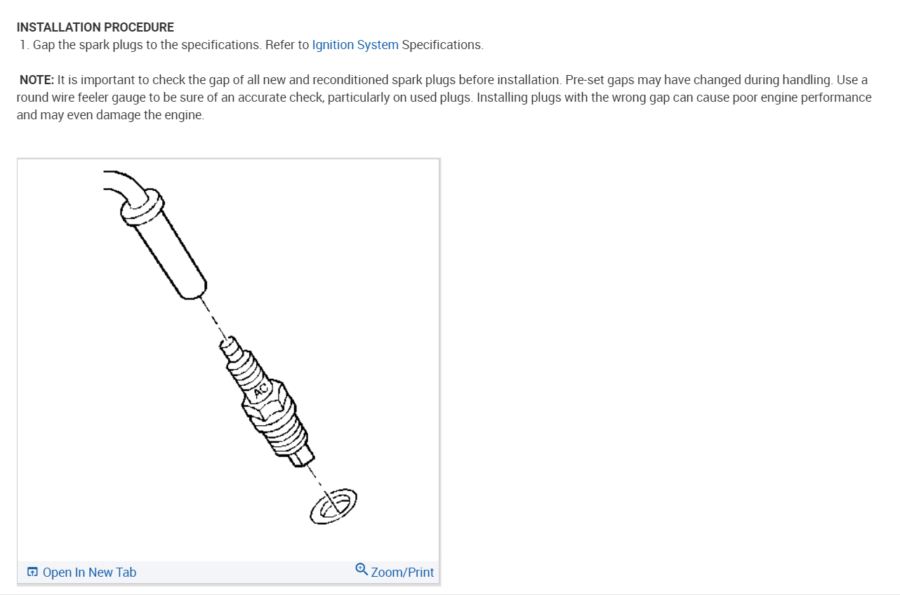

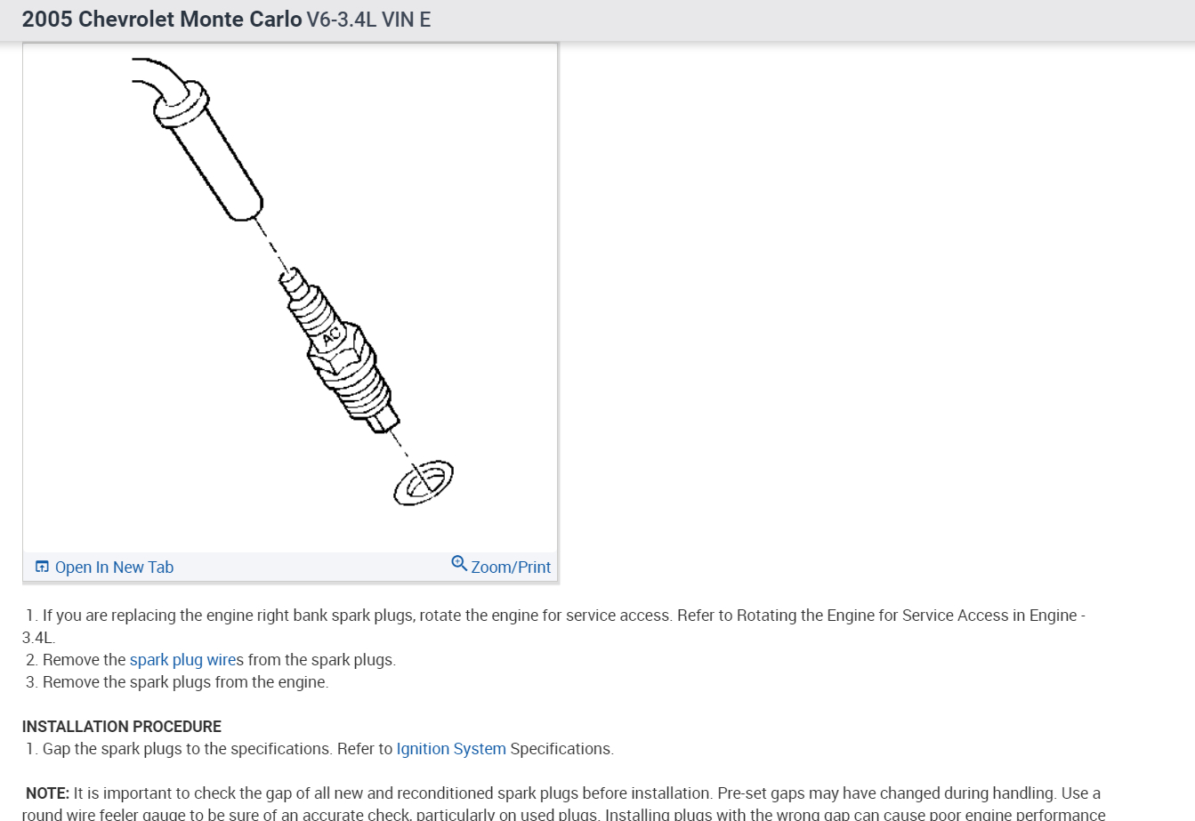

Have you had an engine tune up recently? If not, I would start with that here is a guide to help you see how the job is done and instructions in the images below to show you how on your car.
https://www.2carpros.com/articles/how-to-tune-up-a-car-engine
Spark Plug Type .................... AC 41-940
1.52 mm (0.060 in)
15 Nm (11 lb-ft)
Also, do a throttle bore service.
