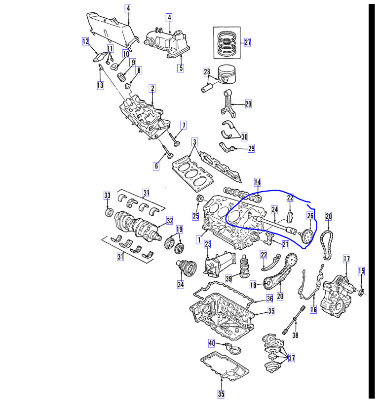

My truck listed above has a different engine in it than what it had when it came from the factory and I am trying to figure out what engine it is so I can order the right parts. The engine has no balance shaft, from what I understand all of the Ford vehicles with 4x4 4.0 v6 engine From 01- 09 have balance shafts. Trying to figure out where I can look On the engine to find what the model is or what year it is to verify the parts I need before buying. One issue that occurred when taking the engine apart is the front jackshaft sprocket got stuck into place when I placed it back on to get the rear sprocket/bolt off. I believe some material may have been on the sprocket when I placed it back on the jackshaft. How can I safely remove this without damaging components?,other than the sprocket which I will replace anyways. Any insight on either of my issues would be greatly appreciated. Also what’s a good easy way to clean head gasket sealing surfaces? Thanks

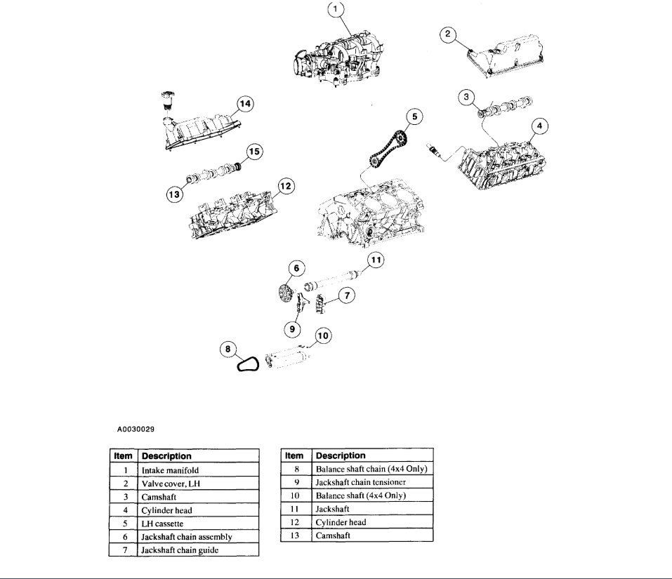

The sprocket should have pulled out with the balance shaft. If it does not, it may be seized in the bearing, which is not good.
In the one diagram, it shows the jack shaft for the VIN code E.

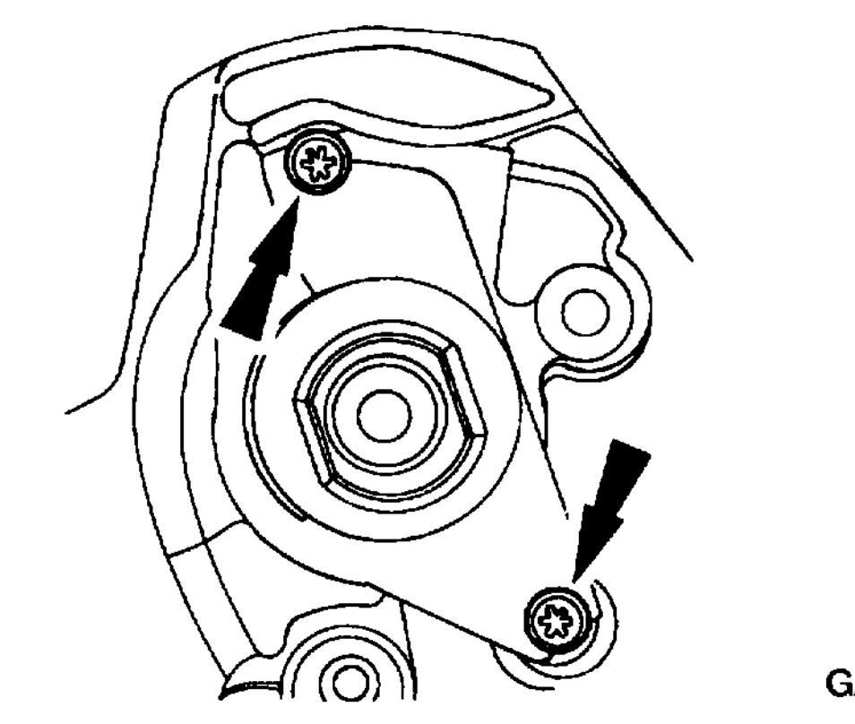

Do you have the thrust plate off for the jackshaft?

The plate is still on but still could remove it. There is also a little bit of back and forth play on the jack-shaft with that sprocket on but no side to side.
Jul 4, 2020 at 11:56 PM
Back and forth is normal. It should be about .001.
Never side to side. That would be bad bearings.. That clearance is .0015.

How should I remove this sprocket or will I have to order a new jack-shaft?
Jul 5, 2020 at 12:00 AM
Remove the sprocket and remove the shaft.
