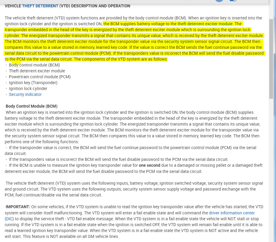

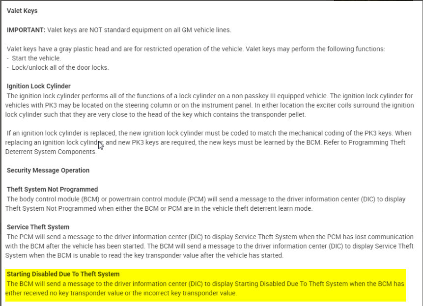

Okay. If the cluster says starting "disabled" then take a look at the highlighted portion of this attachment.

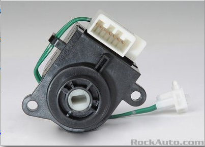

Either the key is not working or the BCM is not receiving the signal from the key transponder. This means either the key is the issue or the exciter module that picks up the signal from the key and sends it the BCM.
The exciter module is part of the ignition switch.
