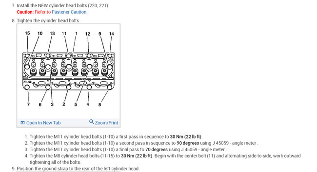

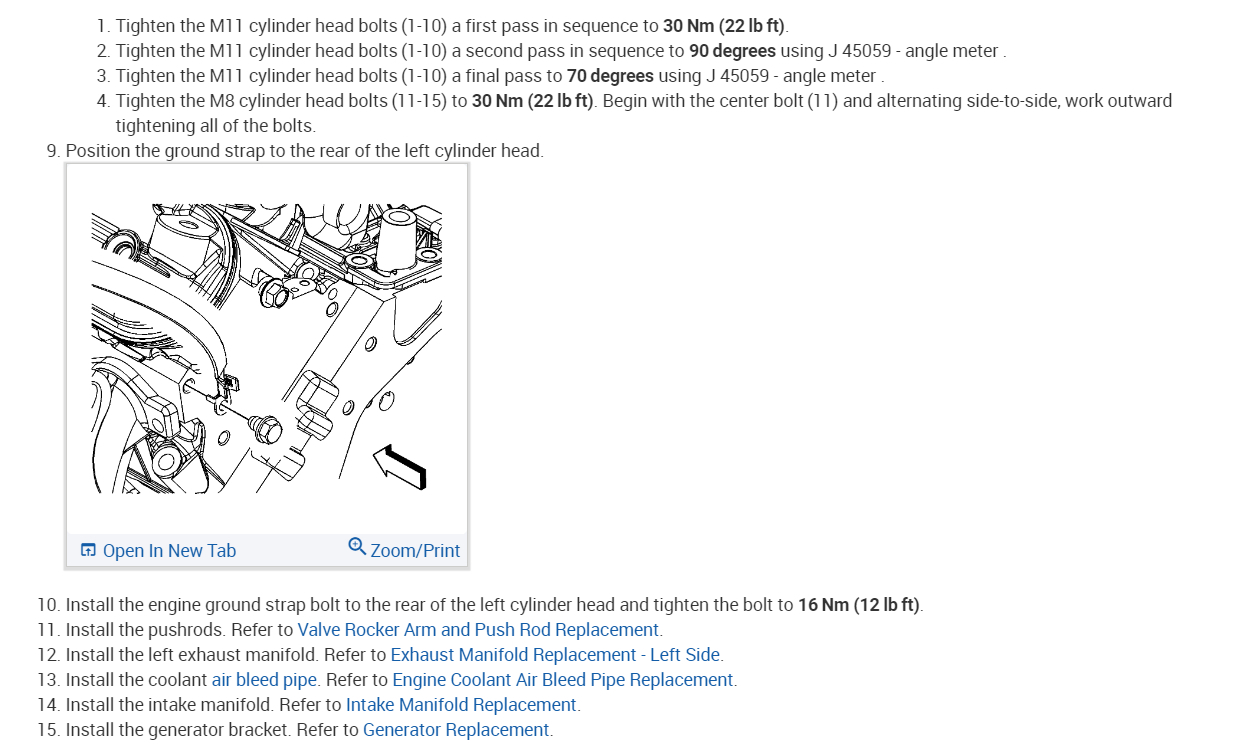

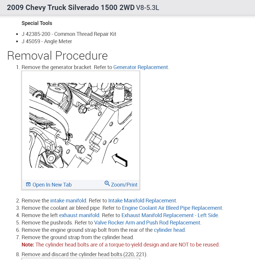

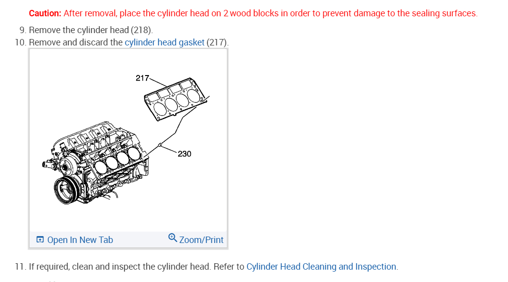

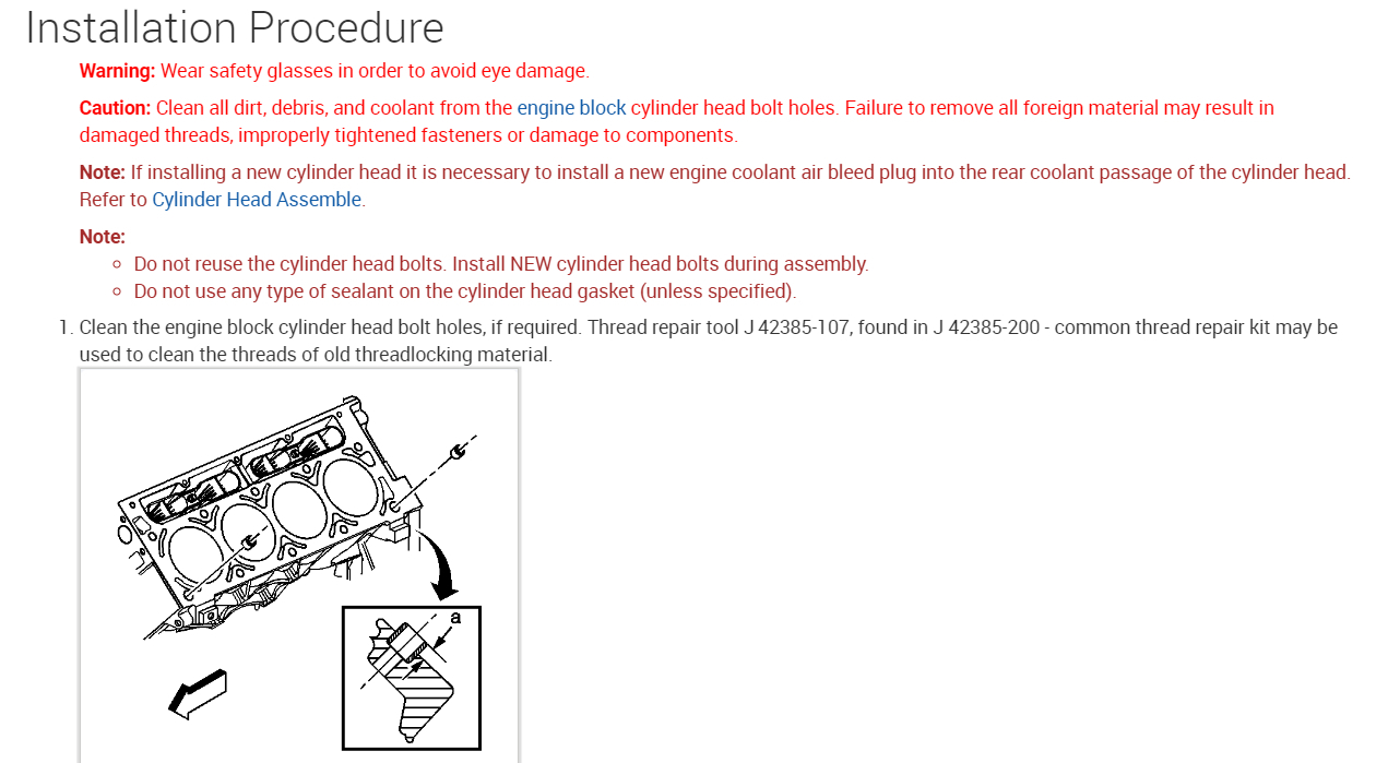

What are the torque specs for the cylinder heads?
2009 CHEVROLET SILVERADO
200,000 MILES • 5.3L • V8 • 4WD • AUTOMATIC
MARIOBUCIO
What are the torque specs for aluminum cylinder heads?
Nov 8, 2022 at 11:55 PM
  • 55,433 POSTS

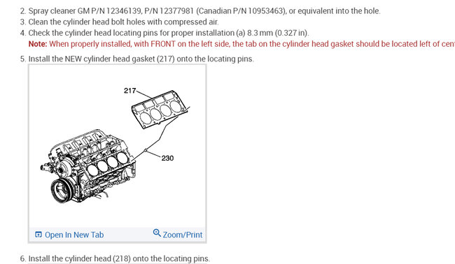

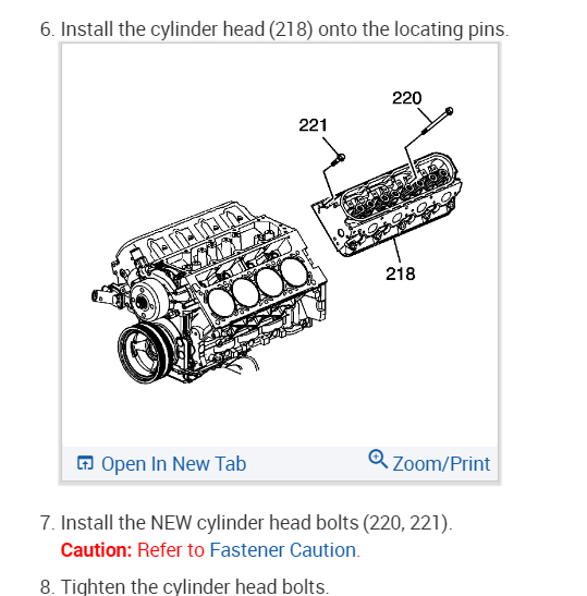

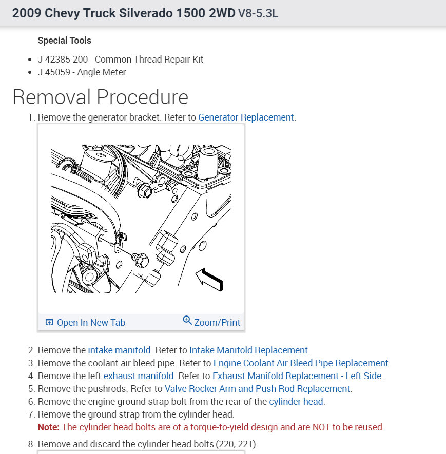

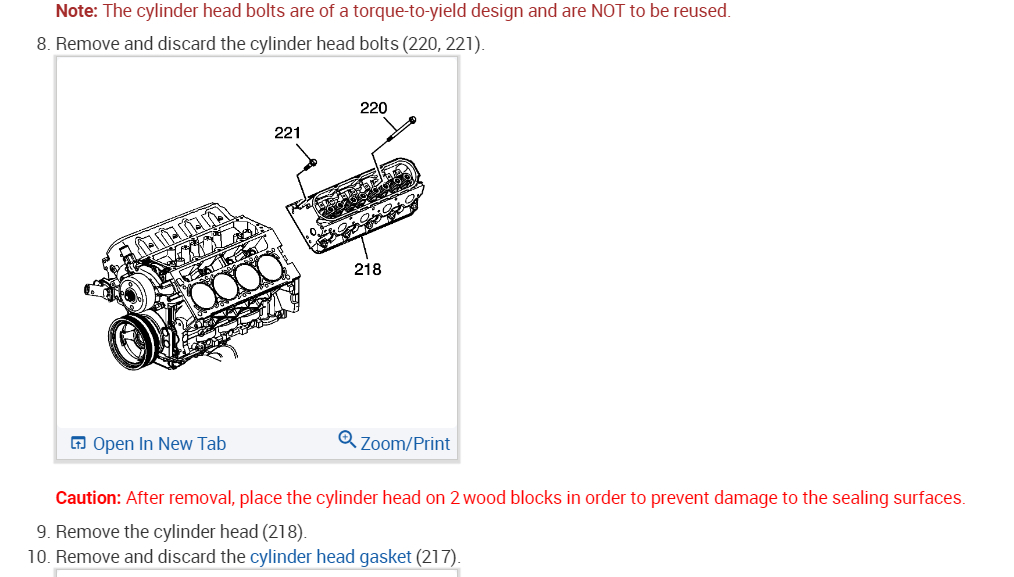

So, these have torque-to-yield head bolts and cannot be reused so make sure you get a new set of bolts. I have found the instructions on how to install the cylinder head with torque specs and a video that shows the job being done. Be sure to check out the images below for the information.
https://youtu.be/JDN8MaekT2Y
Check out the images (below). Please let us know if you need anything else to get the problem fixed. These instructions work for both sides.
